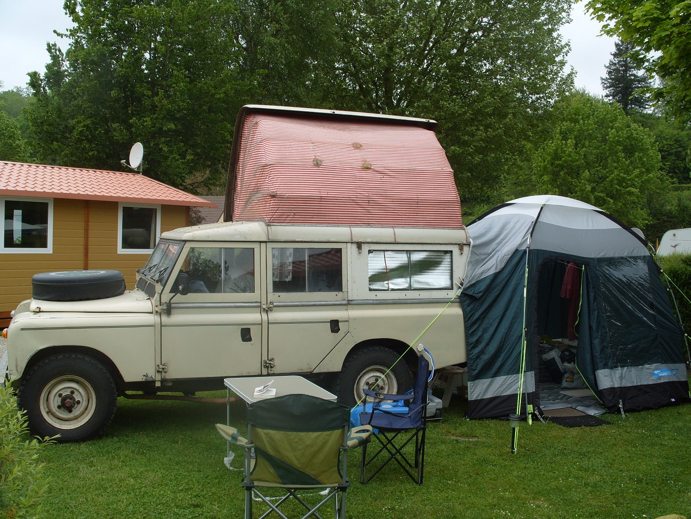

For what I am going to tell you next, I want you to understand that the above serene picture was actually taken later in the week and does not show the continuing gale and frequent showers that loudly heralded our arrival. We waited a little while peering through the windscreen and looking at the pitch next door. What was attracting our attention ? - A holiday chalet in the form of a very secure and warm log cabin !
