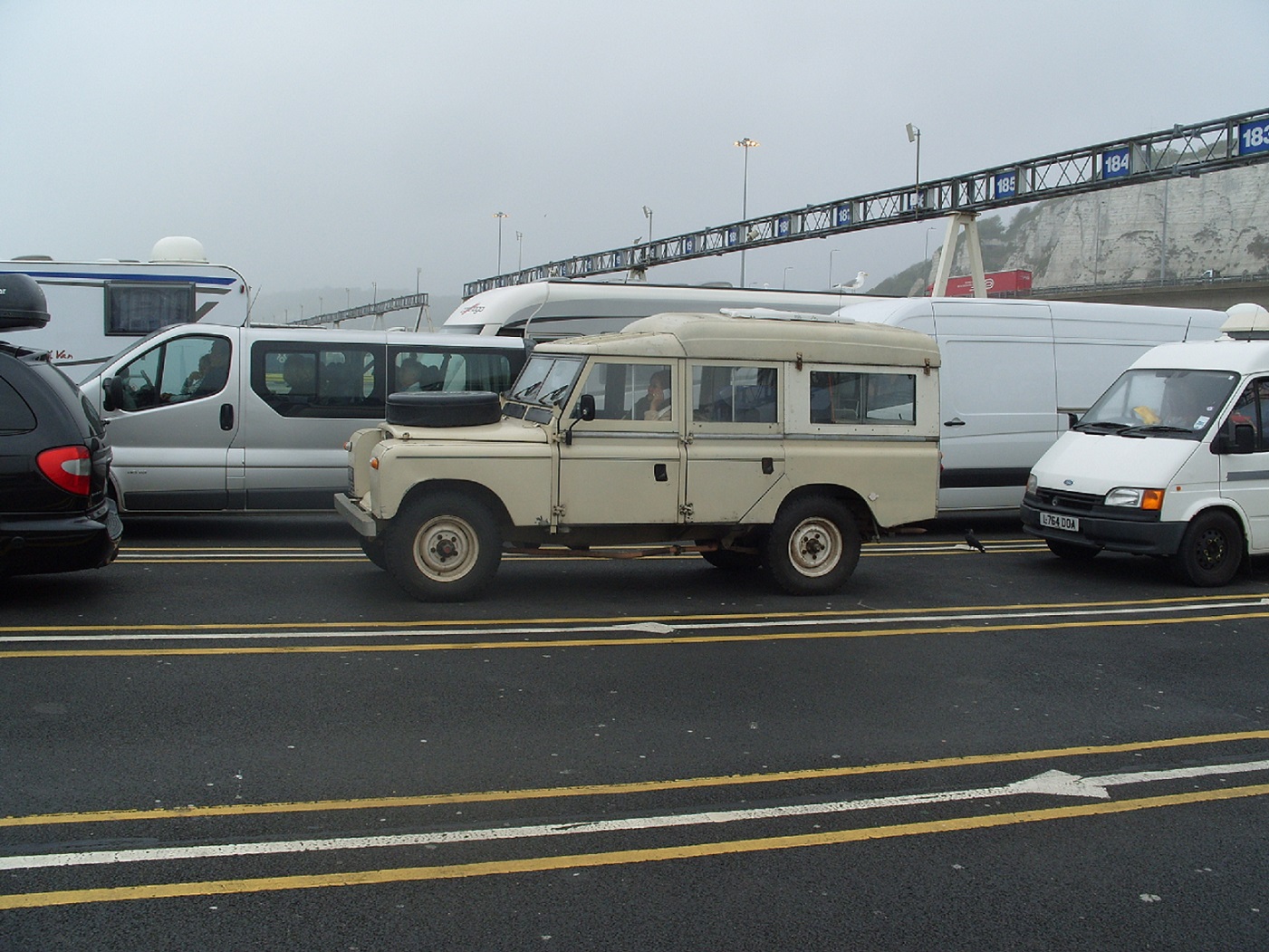

Drove to Dover on a sunny Sunday and stayed in a Premier Inn so we could catch the 10am ferry next day. I had recently replaced a faulty condenser which allowed me to get Dormy running again, but we were going to haunted by a missfire (and more !) throughout the entire trip.
Unmistakably Dover
Unmistakably Dover

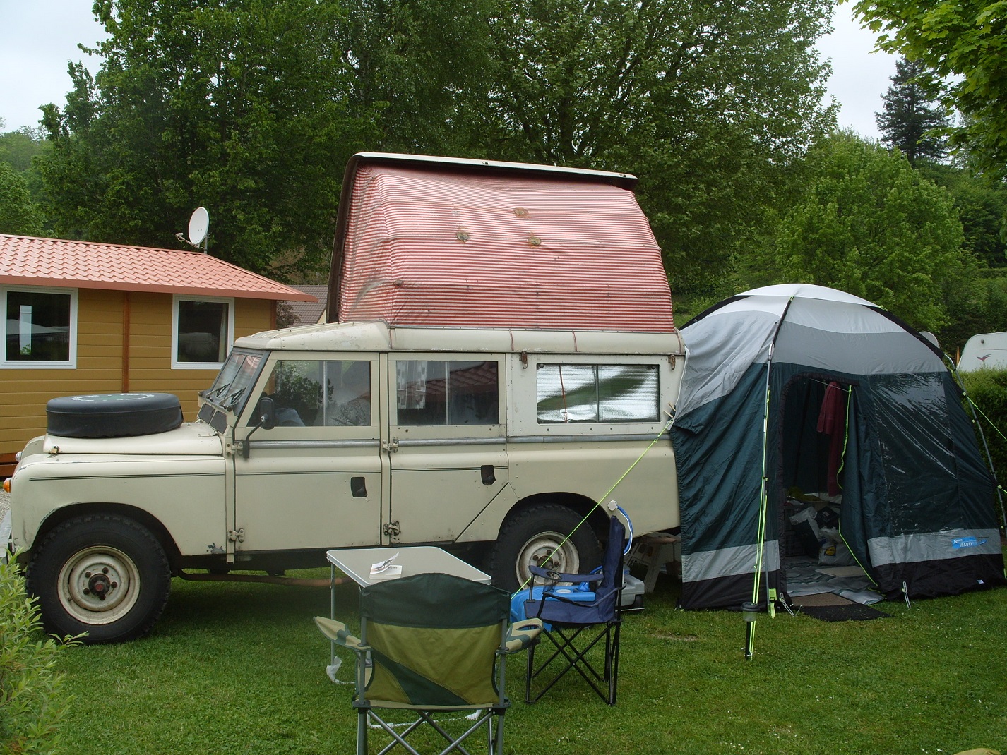

Our pitch
Our pitch

For what I am going to tell you next, I want you to understand that the above serene picture was actually taken later in the week and does not show the continuing gale and frequent showers that loudly heralded our arrival. We waited a little while peering through the windscreen and looking at the pitch next door. What was attracting our attention ? - A holiday chalet in the form of a very secure and warm log cabin !
