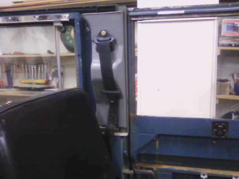

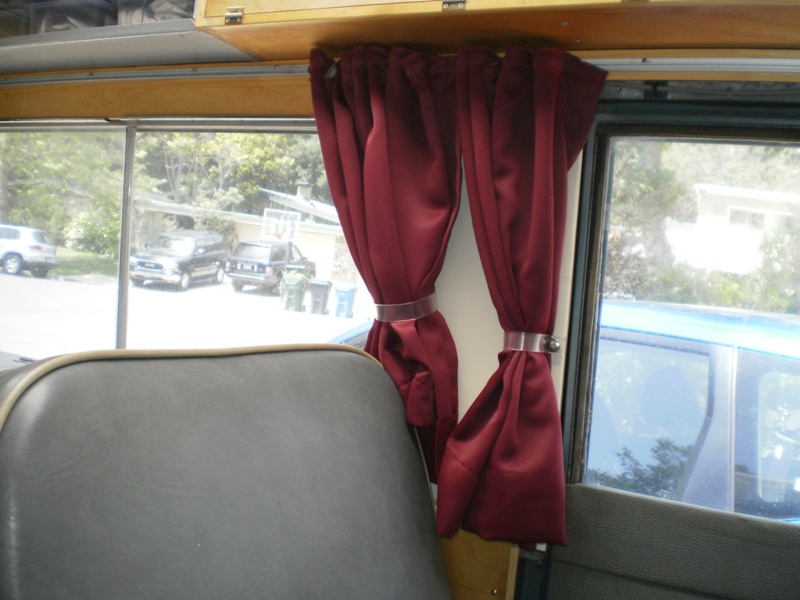

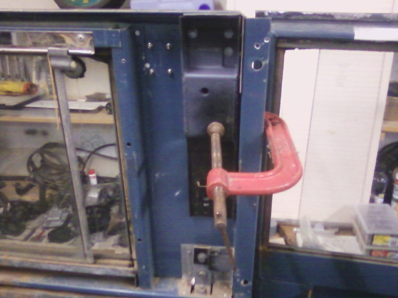

While waiting for some paint to dry I played around and fitted some Defender rear seat belts into the Dormobile. They seem to work okay and the fittings all slotted into place as in the defender, but I'm wondering if they will foul on the curtains ?? I also noticed that the straps don't seem to be very long and restrict movement for passengers.
I also have a set of rear belts from a dual cab and these bolt directly to the floor, they also seem to be longer and would be more comfortable for passengers but there would be a bit of cutting of metal involved to make them fit. Also making a trim panel fit round them would be more difficult
Has anybody else fitted these in their dormobiles ?? Any tips / advice appreciated

Mine had floor mounted ones when I got them, but frankly they weren't safe so I removed them... I have been thinking about what to put in, but it isn't urgent with just two of us.. How did you fix the top brackets?

It will probably work okay, although your front curtain may overlap the doorway. Obviously, my rear seats (of which there is now only one) does not have a seat belt. How do folks have there front seat belts anchored? Pictures would be appreciated.

DanC wrote:Mine had floor mounted ones when I got them, but frankly they weren't safe so I removed them... I have been thinking about what to put in, but it isn't urgent with just two of us.. How did you fix the top brackets?
The bracket fits exactly as in a defender, there are two bolts that go through the roof gutter / roof assembly and one that goes through the door pillar. I removed the door rubber panel before fitting this bolt so it's hidden, the bracket was also drilled so the panel could be refitted with it's four bolts. It certainly seems safer than a lap belt

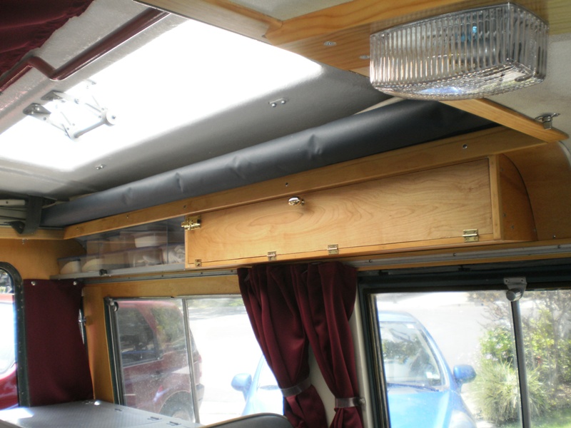

I added an extra cupboard in front of the spice rack. It was a pain to build due to the curvature of the roof.
If you are making one, make the vertical pieces first and then add the horizontals. The spice rack has sliding perspex doors that are held closed by a knob that screws into the metal and through the doors.

Looks good Ian Is that a timber trim you've fitted to replace the plastic item ?? Do passengers bump their head on the extended unit ??

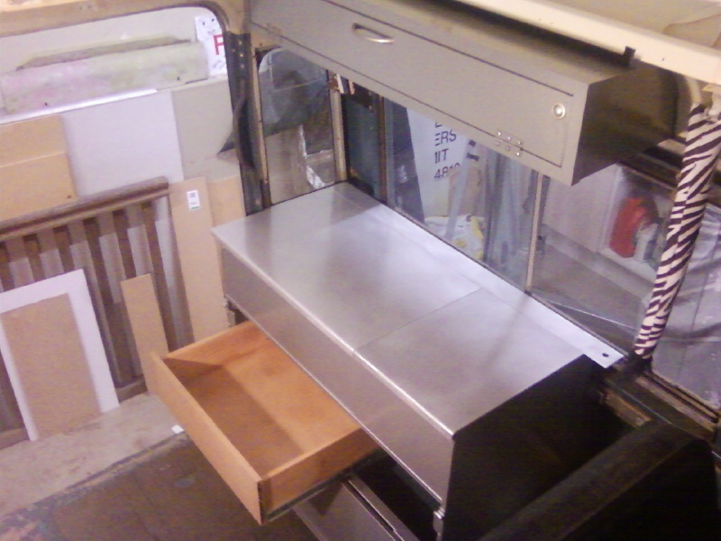

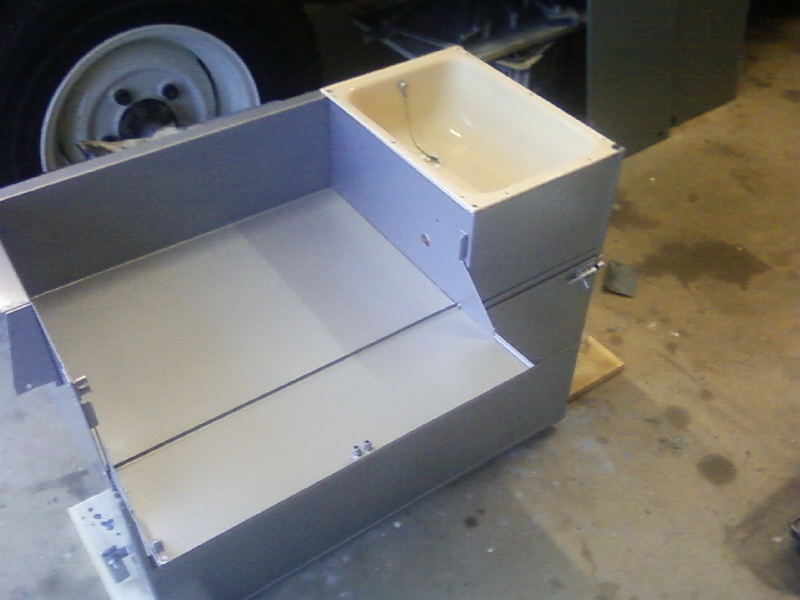

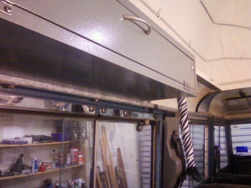

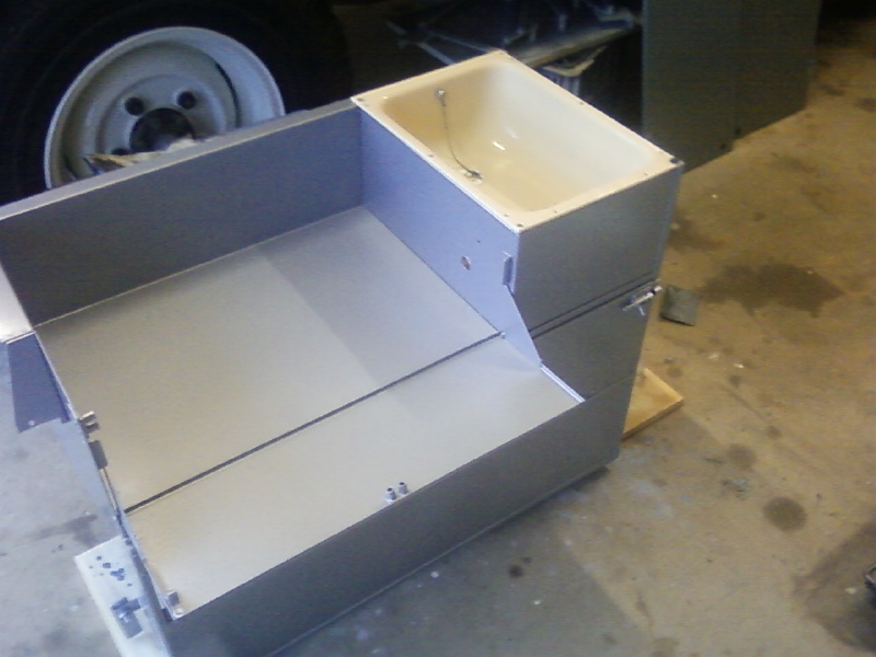

I made a deeper version of the spice rack cupboard so that it can hold a full dinner set, I've just refurbished my original kitchen unit too. I had it sandblasted and have painted it to match my other remade furniture,I also made some heavy duty lids that one can stand on to hop into the bunks. I've also been playing around with the inside of the unit and have made a slide out drawer unit. I thought this might be an easier way to stack items. Underneath the drawer unit is the water pump, the external hot/cold shower unit and a space for a compressor.
The drawer unit is fixed to a cover which is held in place by four screws, so access is easily available. I'm just about to plumb in the water which could be fun

I did indeed replace the plastic trim with wood - it looks so much better and everyone seems to agree. Nobody has bumped their head on the new cabinet but I have. You get used to it and the extra space is welcome. It replaced a crude version that was already there and fell off when I was working on the interior. I have the scars to prove it.

Jerry,jerryd wrote:DanC wrote:Mine had floor mounted ones when I got them, but frankly they weren't safe so I removed them... I have been thinking about what to put in, but it isn't urgent with just two of us.. How did you fix the top brackets?

I've kept the defender rear seat belts in mine as in the first and second pics, the actual seat belt assembly is fixed to that black metal plate and is covered by that grey plastic trim.
My original rear seat belts were just bolted to the rear wheel arch with a metal plate sandwiched between floor -washer - nut, so maybe that's how the Exmoor Trim ones work also
