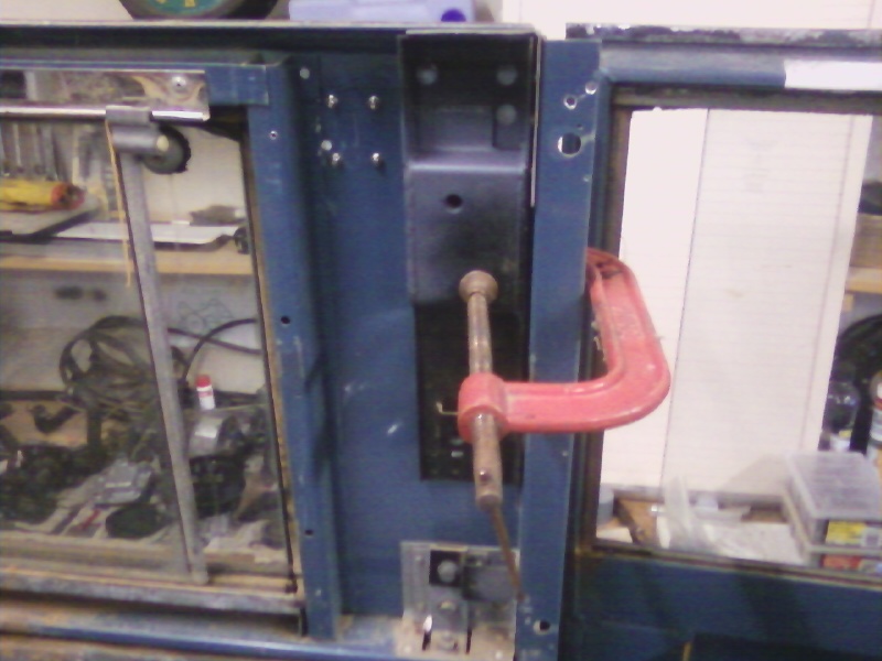

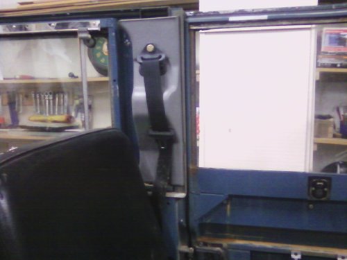

While waiting for some paint to dry :wink: I played around and fitted some Defender rear seat belts into the Dormobile. They seem to work okay and the fittings all slotted into place as in the defender, but I'm wondering if they will foul on the curtains ?? I also noticed that the straps don't seem to be very long and restrict movement for passengers.

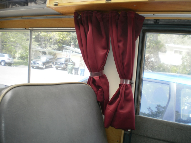

It will probably work okay, although your front curtain may overlap the doorway. Obviously, my rear seats (of which there is now only one) does not have a seat belt.

The bracket fits exactly as in a defender, there are two bolts that go through the roof gutter / roof assembly and one that goes through the door pillar. I removed the door rubber panel before fitting this bolt so it's hidden, the bracket was also drilled so the panel could be refitted with it's four bolts. It certainly seems safer than a lap belt :cheers:

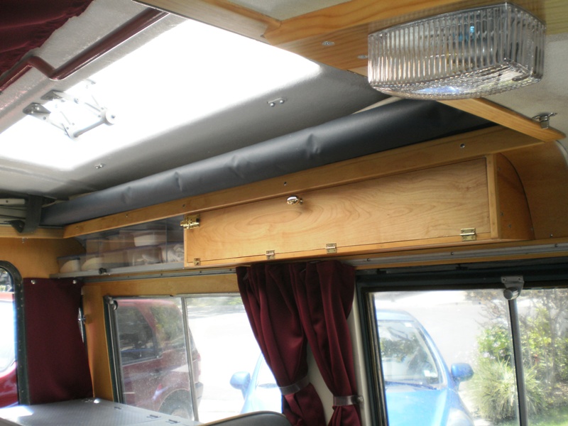

I added an extra cupboard in front of the spice rack. It was a pain to build due to the curvature of the roof. :banghead:
If you are making one, make the vertical pieces first and then add the horizontals. The spice rack has sliding perspex doors that are held closed by a knob that screws into the metal and through the doors.

Looks good Ian :cheers: Is that a timber trim you've fitted to replace the plastic item ?? Do passengers bump their head on the extended unit ??

I did indeed replace the plastic trim with wood - it looks so much better and everyone seems to agree. Nobody has bumped their head on the new cabinet but I have. You get used to it and the extra space is welcome. It replaced a crude version that was already there and fell off when I was working on the interior. I have the scars to prove it.

I've kept the defender rear seat belts in mine as in the first and second pics, the actual seat belt assembly is fixed to that black metal plate and is covered by that grey plastic trim.
