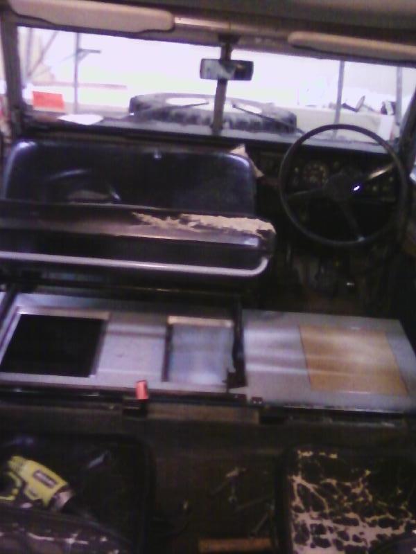

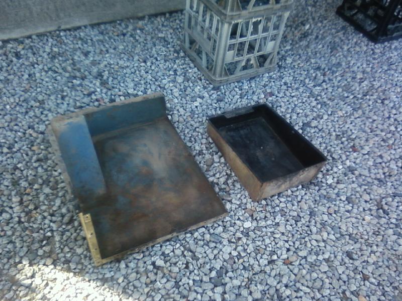

Here's a pic of my original box that was fitted in the centre of the seat box. It was a poor fit so when I did the upgrades to my seat box I made a new improved Mk2 version. All easily removed for access to gearbox,handbrake etc.
There's a few pics of the mods I did on page two in this section, I must say it's the most useful modification I've done as it's very useful storage space and easy access too
I didn't take any pics of the fully finished carpeted product though

I get her back a week Saturday and will photograph for you Mick... Basically the tray is supposedly wider than the standard one and about an inch deeper.... I will see when I get it back, my thoughts are to locally take enough out to go over the overdrive and then put an access panel in it to check overdrive fluids. The box itself is usually screwed in place, probably why nobody ever fitted an o/d before!!!
