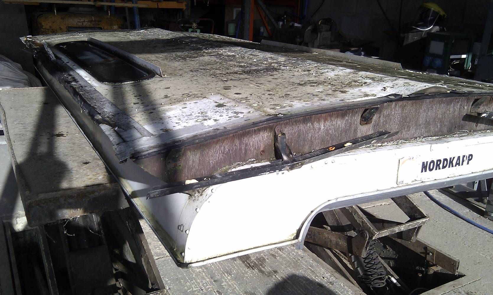

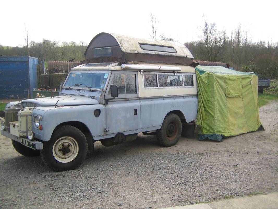

I have finally made a start to restore the roof on my carawagon. We put a standard roof on the landrover and got it through an mot, I have been doing 30 miles round trip to work every day and love driving it. The roof however was a bit tired. Silver guttering tape had been used every where, that took 3 hours to remove (like trying to scrape off soft toffee) but it had at least kept the water out.
Has anyone had any experience renewing the flock lining? it is damaged in one place. I have found information on this forum and 6 pot as to where to get all the seals and hinges (many thanks for that) I am going to replace all the plywood with a special ply that has paintable surfaces made by wisa (sign writers use it) and use two pack epoxy primer on all the edges. It will be interesting to see how long it lasts before it needs painting again.
Also does anyone know what the 'ridge' is made from? I am half thinking of building another carawagon roof from scratch.
Is it wood sandwiched between the 2 sheets of aluminium down the centre, also any ideas as to where to buy that sort of ali?
If anyone needs any photos of how it all goes together and how the seals all fit I will be more than happy to help. My carawagon is a lovely and original 1974 series 3, it even came with the leather carawagon key ring.

Looks like you've got a bit of work to do on that roof - we've done two so far, completely replacing all the wood with marine ply, and we've got another two to do.
It's like Carawagon Central on my front lawn
I would be careful about using epoxy type paint on the ends - I suspect if water gets in you wouldn't know about it as it could rot away but still look ok on the outside.
We give ours a good soaking with a wood preservative (Cuprinol 5 Star or similar), leave it to dry for a week or two, then a thinned coat of yacht varnish, followed by at least 2-3 full coats of yacht varninsh.
All of that is done before fitting, then that's followed by another coat a few months later.
At least then you can see what's happening to your ply

Re. the ridge, as far as I know there's just a long length of timber the full length, but the ends are filled with shaped pieces.
The aluminium is Duralloy(sp?), and I understand it is available from specialist suppliers on the continent, but not found anyone in the UK who's heard of it. I think it used to be used on certain small aircraft many years ago. It is special because it can be flexed without work hardening - if you used normal aluminium sheet it would eventually crack. I understand it is also very expensive

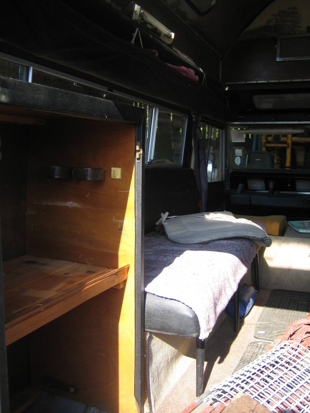

Have you got any more pictures, especially of the inside?
We've got three different internal layouts on the front lawn, so it would be interesting to see yours

I will sort through the photo's tonight and post a few. I am not sure if my carawagon is surposed to have a removable metal bar behind the front seats. One of the cupboard fronts makes the table and has the threaded sockets to take table legs (unfortunately missing) and I am guessing it hooks over that bar. I am also missing the front middle seat, I will be making something up to go there.

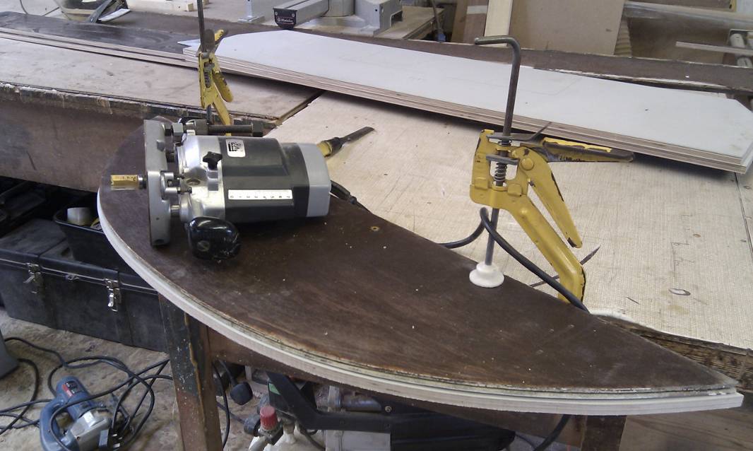

Having taken one of the ends completely to pieces it was good enough to use as the template to route the new plywood.
Didn't quite get as much done today as I had hoped but managed to drill all the rivets out on the piano hinges atattched to the roof aluminium angle and get the lower section of the roof to the person who is going to spray it.
