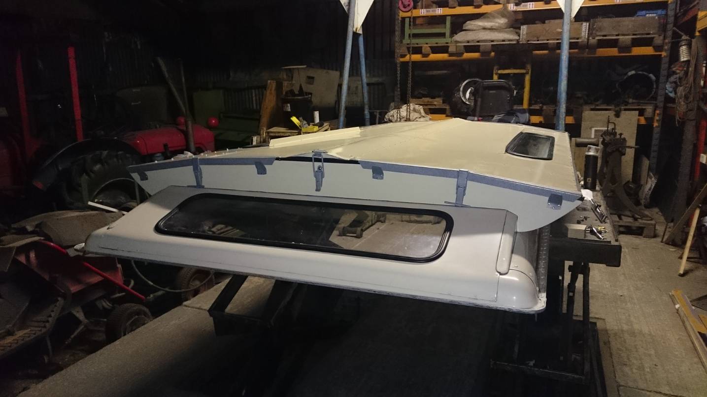

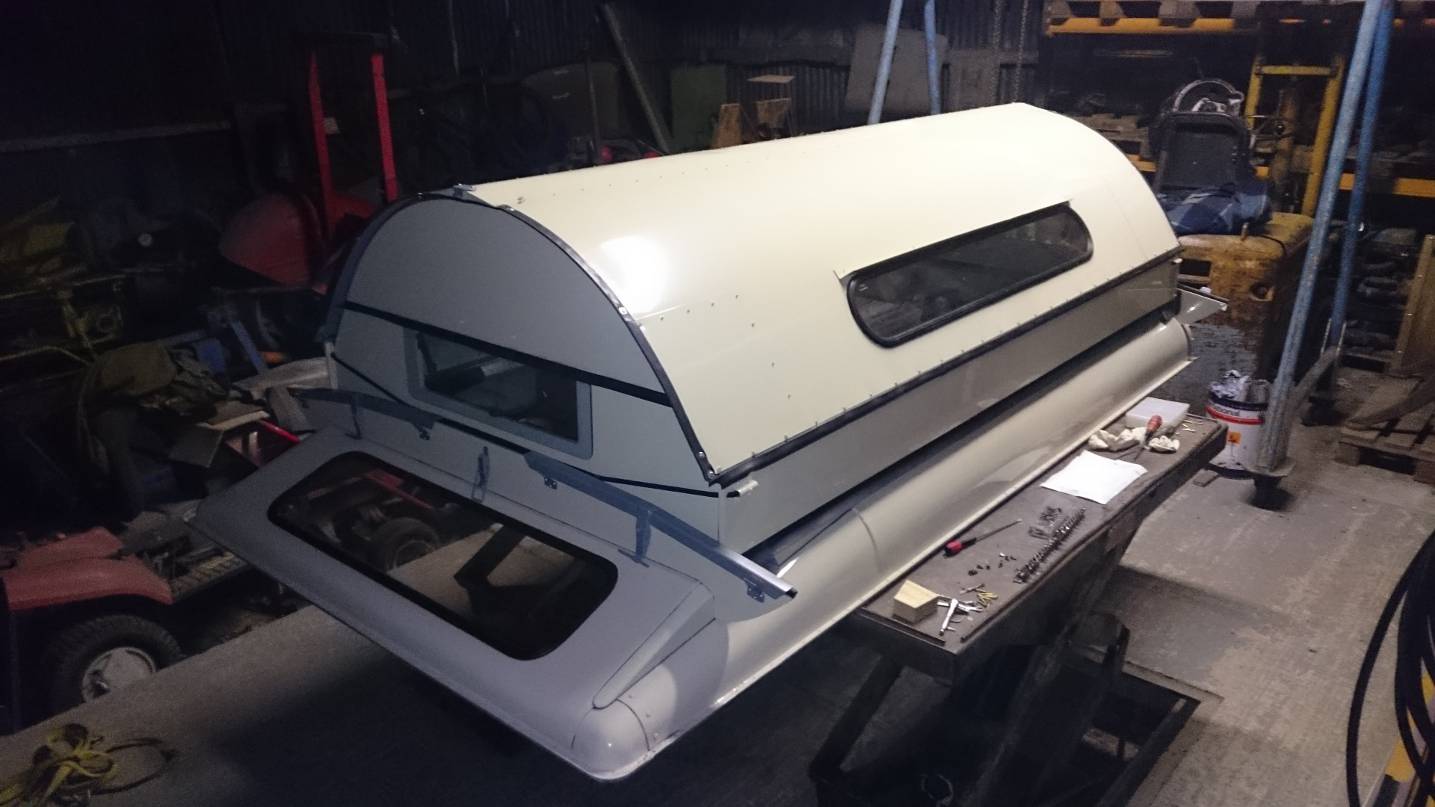

Roof finished, Captain tolley's at the ready!

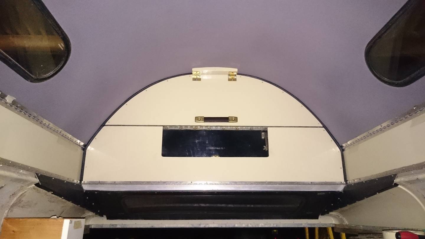

- Inside show the flocked roof, we mixed the flock starting with a light grey adding handfulls of black bright red and electric blue to get close to the original. The old flock looked brown but where it was covered with the wooden blocks that the hinges screw into I had a sample or what it would have looked like when new. I could have gone a bit darker but decided to keep it lighter.
Re: Roof finished, Captain tolley's at the ready!
That looks fantastic Kip - well done, it looks well worth the effort
I know what you mean about 'slight adjustments'! On the ones I've replaced not one of them has sat flush and lifted cleanly on the first go, despite using exactly the same measurements as the original woodwork - I wonder if Searle had the same 'adjustments' to do on each one
Did you re-fit the glass yourself or get a 'professional' in? Just wondered if you/they had used sealant on the rubber to metal, and/or rubber to glass? I know it's a weak point on most of the roofs I know of, including mine and I replaced the seals with new
Sikaflex and Captain Tolley are good friends with my windows
I fitted the glass myself, new rubber seals. I joined the ends using sikaflex cutting the rubber 15mm too long so that it was a tight fit when pushed into place. Coh Baines sell a tool for putting the claytonite rubber seals and infill strip in, the cheaper one they sell does the job well and has different shaped ends for different size seals. I used low modulus silicone sealer between the metal and rubber and also between the glass and rubber.
I think while it is all dry I will just run some captain tolley's round to be on the safe side. Someone at work had run off with my low modulus clear silicone so I had to use black.....you can imagine the mess cleaning it all up. I will let you know where it leaks. For now it is still in the dry, I don't want to put it outside yet but looking forward to fitting it to the landy. I may even need to run a fine bead of sikaflex between the glass and rubber especially on the skylight, because of the sloped panel I think the water will sit.
Regards Christine
