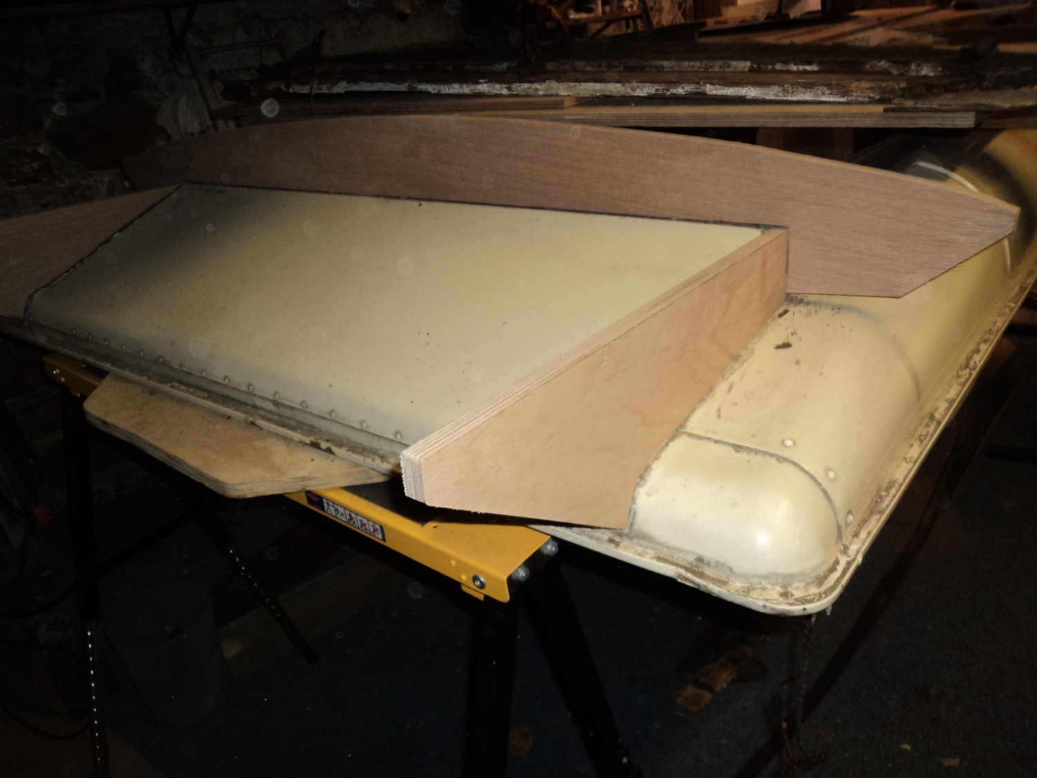

I've stripped the rivets out of the long hinges and in an ideal world I think I'd like to buy new ones. Does anyone know of a supplier? I'm fairly confident that these will be able to be used if cost or availability is a problem.
The metalwork on the roof is quite primitive but I was surprised how well it copes with the passage of time. It will clean up quite nicely I think.

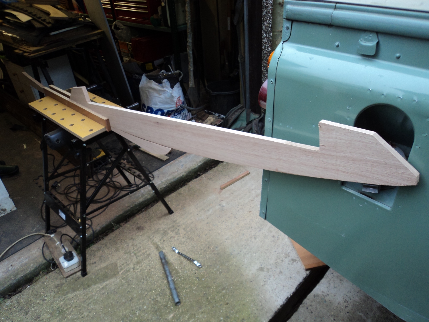

I've used the old rotten wood as a loose guide/pattern and made the basic shapes for the roof-rack supports and the front cross piece. It's from a sheet of 18mm marine ply. Big decision now is how to treat it. I've bought ronseal yacht varnish but I'm still wondering if I want to stain it first. The old stuff was quite dark....and I've seen lots of pictures of lots of dark ones...but then again, I've seen Robins lighter woodwork up close......some thinking to do. Another decision is whether to cut the shape out of the rack supports. How much weaker will it be? Are the holes there for air to pass through.....and exactly how many more mpg will I get with the reduced drag?
.no...not a serious question!
There were no grooves in the front and rear cross pieces I took off so no sign of any rubber. No wonder the interior rotted away if there were no seals. I've seen on here one method of cutting those grooves with a hand made jig on the bottom of a circular saw. I had a go with a work bench and circular saw bolted underneath it but I made a right mess of the test pieces. I'll experiment with my router next and see how I go. The circular saw feels a bit vicious.
That's it for now....slow progress and I've not got to the tricky bit yet with the long sides and the internal folding pieces. I'm worried about it either being too slack and leaky...or too tight and unable to push up.....but.....spring will come and I'll want to be using it.....but with which roof on? We'll see.

Had a play-day today. Didn't actually achieve loads as all I did was cut the grooves in the end rest pieces.....but it was making the tool that took all the time. Hopefully, my method will be sufficiently slightly different to Robin's and I won't be facing a moment in court.....I reckon it's sufficiently different!?
I used the off-cut from the curve of the rest pieces and fixed the guide sides. Clamped it in the work table and screwed the base plate of the circular saw to the underside of the bench.
It's made the job very steady and spot on accurate, so the tadpole rubber seal will fit in lovely now.
