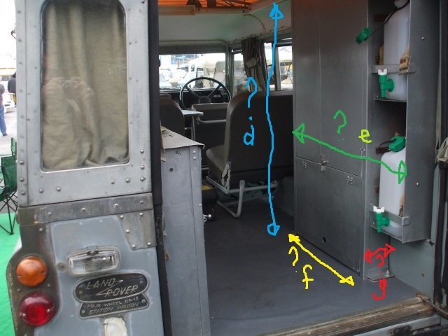

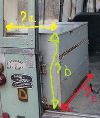

Bonjour,
Please, Can anybody give me the measures for the cooking and whardrobe? (excuse me fr my poor english but i try)

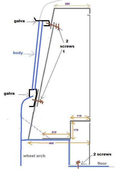

Post by jerryd » Sun May 10, 2020 1:07 pm
Here's the wardrobe measurement for the side view, not sure of the standard width . I can measure sink unit later :cheers:
Wardrobe Measurements 2.jpg (31.54 KiB) Viewed 72771 times

Post by jerryd » Sun May 10, 2020 1:49 pm
My standard kitchen unit measures a = 395mm, b= 585mm, c = 798mm
This is the cupboard size and doesn't include the lids. Hope this helps :wine:
007 7.jpg (39.17 KiB) Viewed 72769 times
007 6.jpg (30.86 KiB) Viewed 72769 times

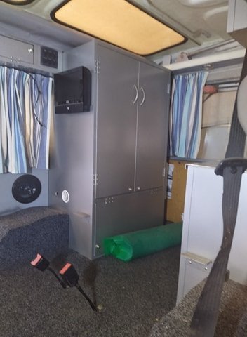

I made my wardrobe wider than standard so I can keep fridge inside, also my table
007 Wardrobe.jpg (31.53 KiB) Viewed 72748 times
