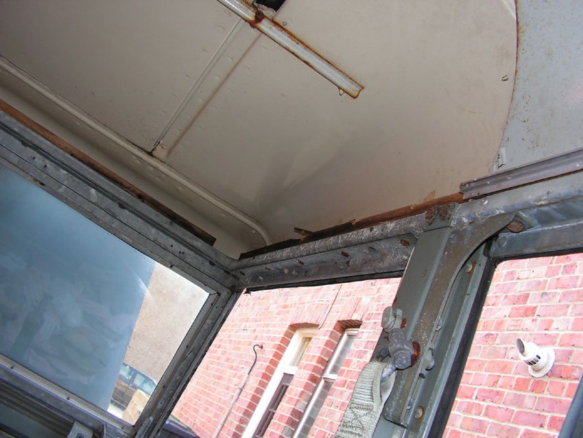

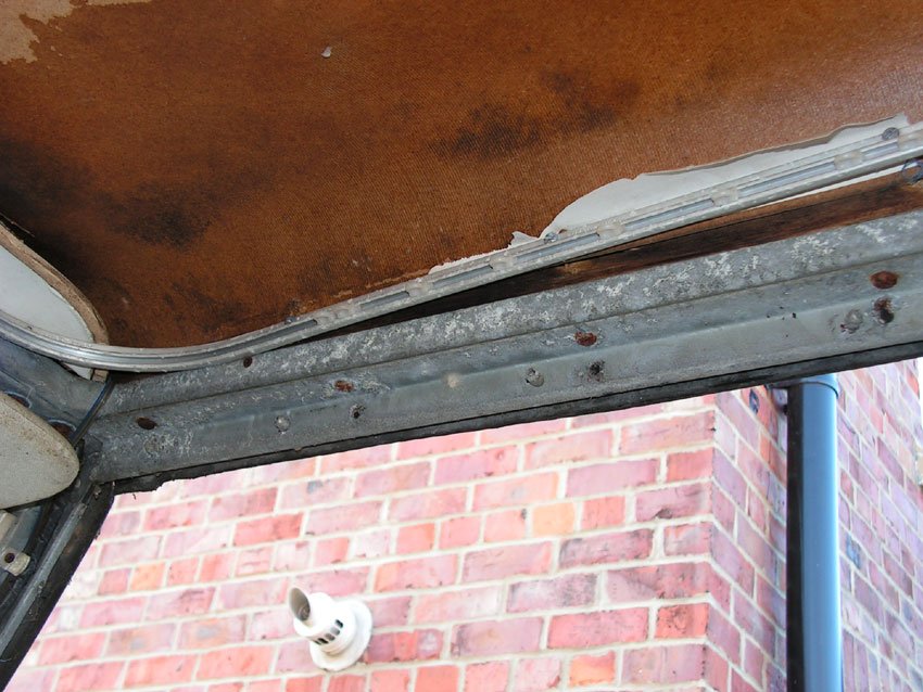

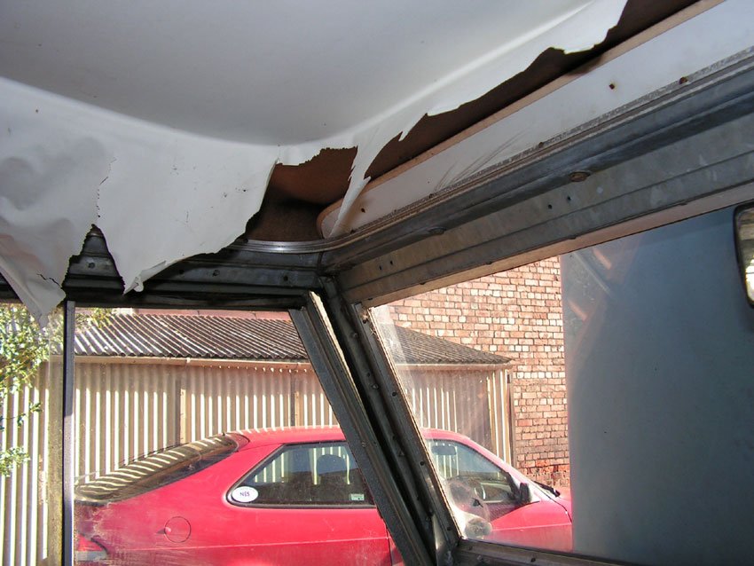

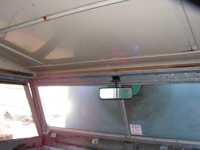

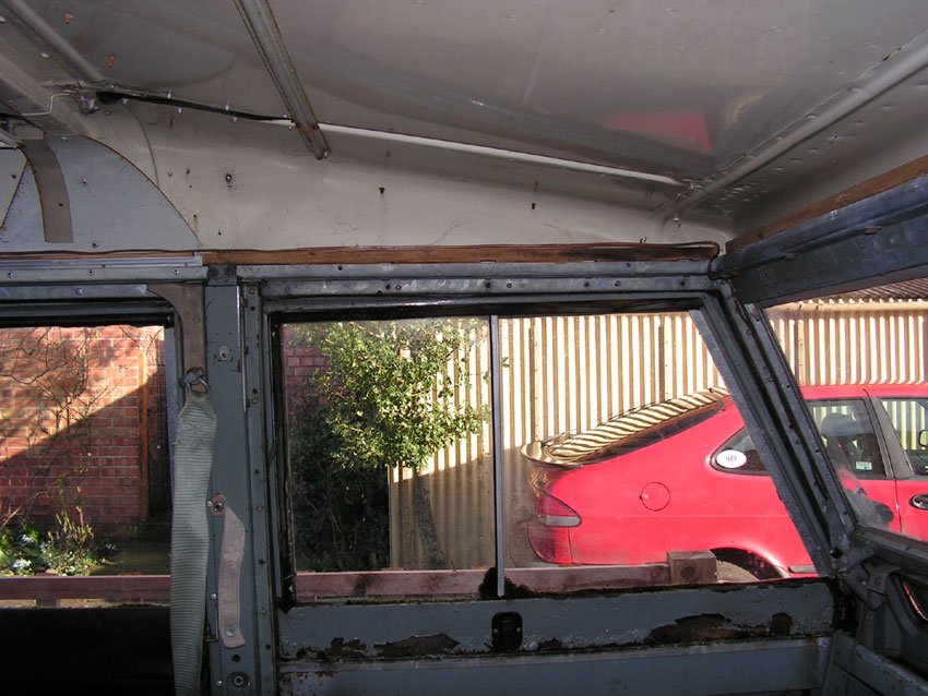

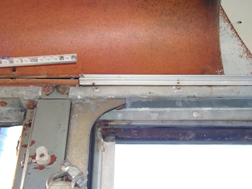

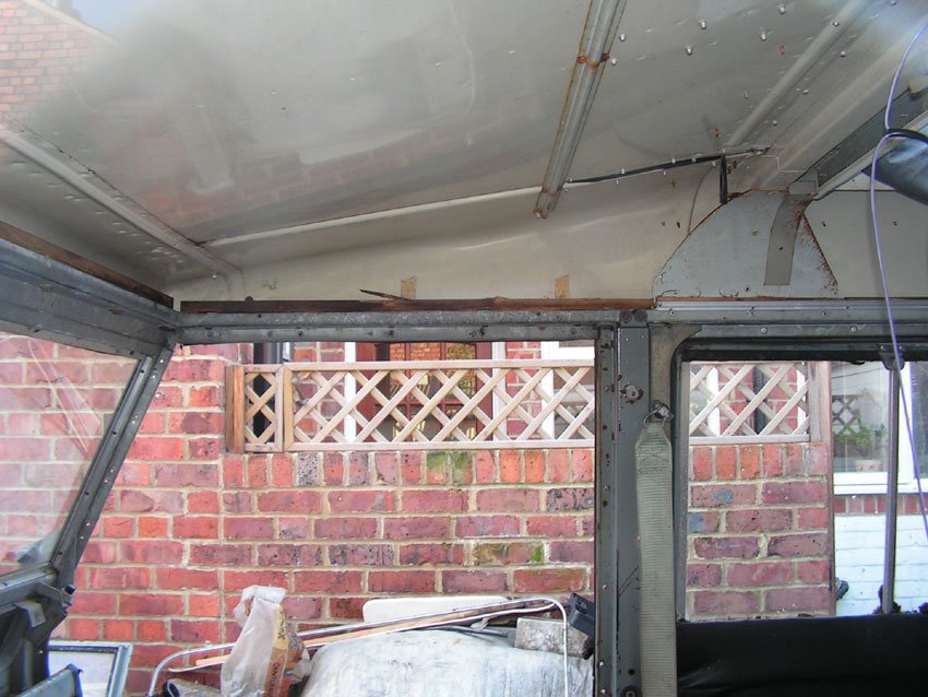

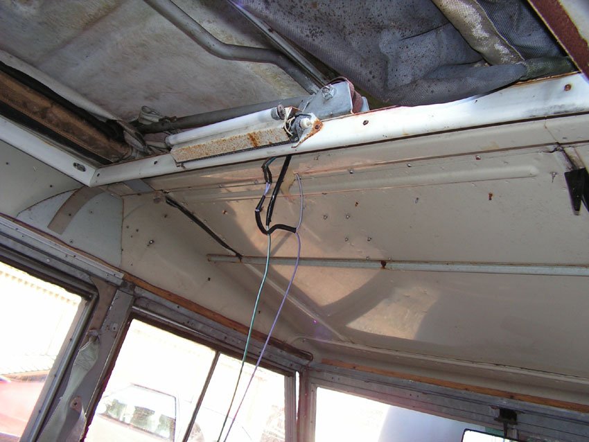

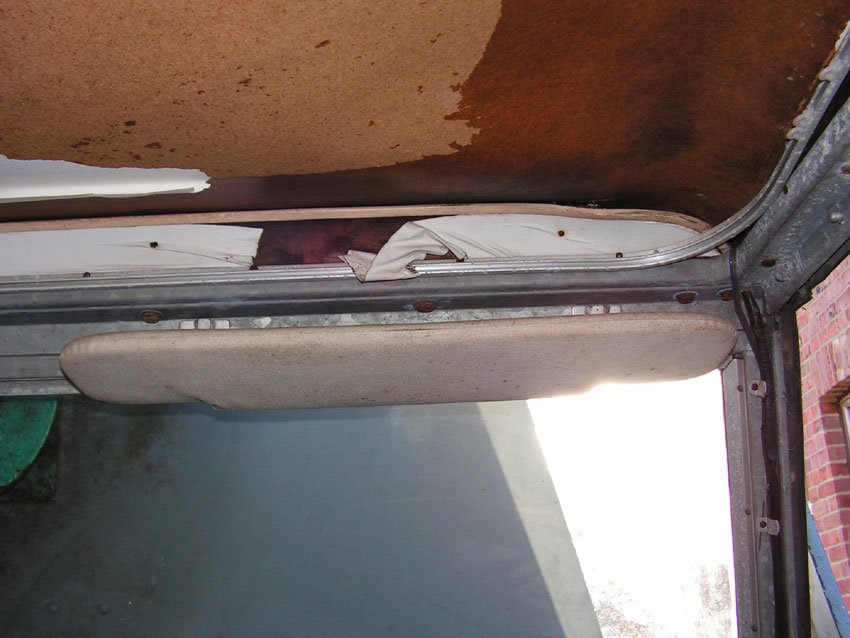

Re: Dormobile 'headlining'
Hope these help, Gordon
- PICT0026.jpg (107.9 KiB) Viewed 78351 times
- PICT0025.jpg (95.37 KiB) Viewed 78351 times
- PICT0024.jpg (94.41 KiB) Viewed 78351 times
- PICT0023.jpg (62.33 KiB) Viewed 78351 times
- PICT0022.jpg (109.86 KiB) Viewed 78351 times
- PICT0018.jpg (95.21 KiB) Viewed 78351 times
- PICT0017.jpg (116.28 KiB) Viewed 78351 times
- PICT0016.jpg (84.37 KiB) Viewed 78351 times
- PICT0015.jpg (101.43 KiB) Viewed 78351 times
Thanks Gordon,
Some of the pictures help with working out how the curtail rails are installed (mine had been replaced).
My headlining isn't 'that' bad all things considered but I still need to investigate replacement. Maybe the Australian weather has been kinder to the board ?
