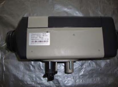

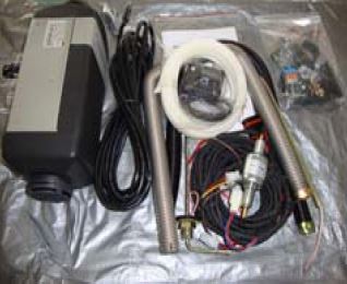

"Webasto" 2kW
Technical Specifications:
Heat Power: 2kW
Fuel: Diesel
Rated Voltage: 12V
Fuel Consumption: 0.12~0.24l per hour
Power Consumption: 14~29W
Working (Environment) Temperature: -40°C~+20°C
Dimensions: 323×120×121 (mm)
Weight: 2.6kg
CE Certified
Full kit including fuel pump, fuel tubing, exhaust pipe, inlet pipe, clips, wiring, control etc.

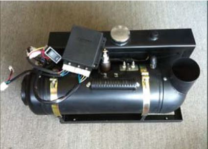

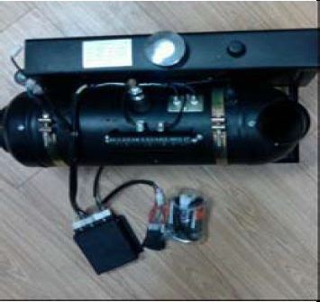

Automatic air heater with fuel tank
Heat Power: 2.8kw to 4.6kW
Fuel: Diesel
Rated Voltage: 12V
Fuel Consumption: 0.3l to 0.6l/hr
Power consumption: 70W
Dimensions: 550x250x250(mm) (with tank)
Fuel tank: 480x75x200 (mm) 6.7litre
Weight: 16kg
CE Certified
Completely self contained with fuel tank so can be run on red Diesel.
Fuel tank can be removed and Diesel picked up from your vehicle tank.
