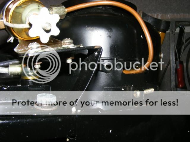

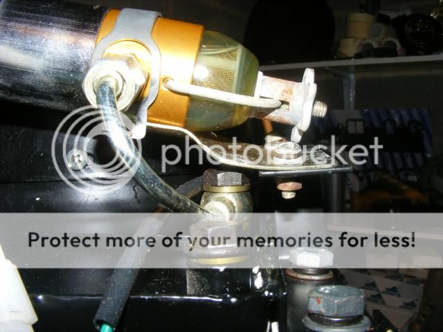

ok found a problem with the night heater it was smoking quite a lot so i got the makers to send me a new heater element it arrived and i fitted it but it still smoked.. .so had a word with the guy and he is going to replace the unit then as i was checking it over i found some damage on the underside it has been damaged in transit or its been dropped in the factory and sent out like it... ...so i have to take it to preston to get it changed....not happy....

ok been to pick up another heater from preston today, Took the original unit up and when i got there he bench tested it..... so very smokey he reckons theres something loose inside causing it to drip diesel onto the burner....anyhow he had just had a shipment of new units from china all stacked on a pallet so he took one and opened it we bench tested it and it was perfect so i had one out the box ....so quite happy... ....but not happy i am having to faff around.... ...200mile round trip today.....
