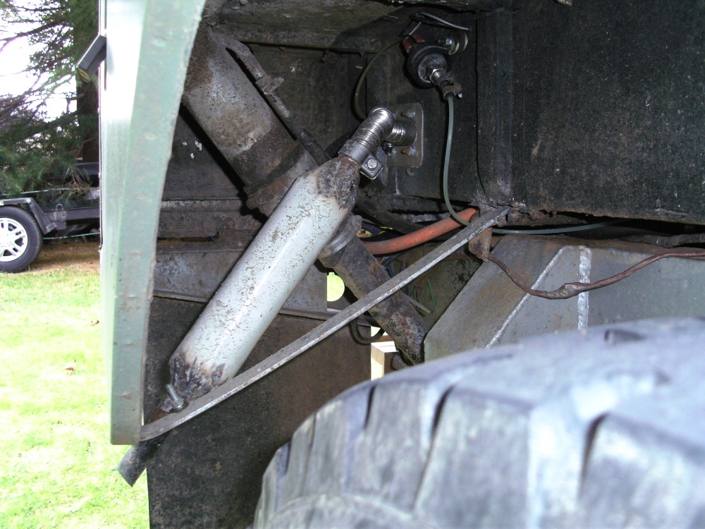

Best to make or buy a silencer for the exhaust - I made one for Patrick's, but mine is currently sans silencer and the neighbouring campers know exactly when I've put mine on in the morning
Here's the one I made for Patrick's:
Simply some expanded steel made into a tube, welded to stub pipes at each end, then wrapped in fibreglass roof insulation. That is then wrapped with thin steel plate, seam welded and cut, shaped and welded at each end to the stubs.
His is a lot quieter than mine

No point in trying to soundproof the box Tuggy - it's the exhaust which is noisy!tuggy wrote:as you say it sounds like a jet engine.. ..but saying that i am going to mount it in the belly box and the thin plywood that was in the packing i think i will line the inside so it gives some kind of noise suppression ...... got to see how it all works out its a design and build so lets see how it goes.....
The unit itself and the ducted hot air fan are quiet.
If you fit an exhaust silencer you don't really know it is on inside the vehicle, apart from that warm flow of air from the duct and a faint jet-engine whine from outside
