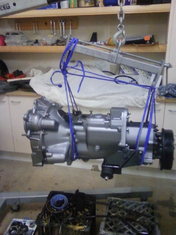

I've spent the last few days overhauling a spare gearbox that's been sitting in the corner of the garage, I've put an overhaul kit through it and cleaned it all up, so I'm hoping that it will be a huge improvement over the original box that's in the dormobile. Also managed to alter the bell housing so it fits to the 300tdi also.
I'm going to fit this box and test it , if it's all good then maybe I'll take the plunge and fit the diesel sooner than planned

Impressed with the look of that, not a greasy mark anywhere and a spotless floor to boot.
Re: 200 / 300 tdi Conversions....
Good grief, that's clean
I wonder how long it will stay like that once on the road

Thanks for the compliments
I doubt it will stay shiny for long as I like "off roading" it too much . We have an off road weekend planned for the 7th/8th September so I'm going to try and get the gearboxes swapped over before then. The original box is jumping out of 1st gear and loosing oil at an alarming rate so I'm reluctant to go far in it , especially where we take it .

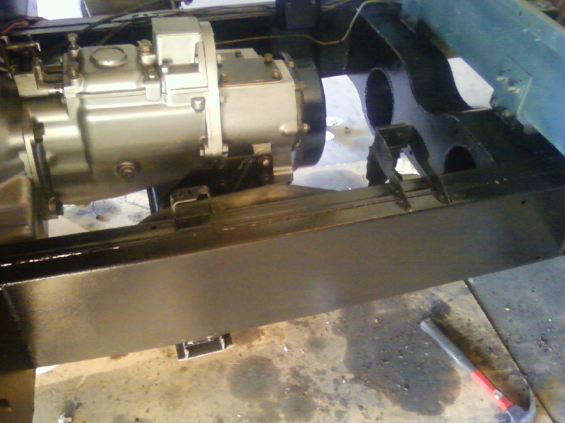

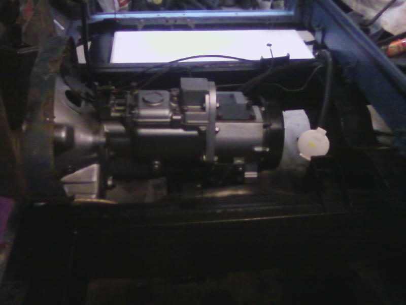

Well I failed to get the dormobile back together in time and had to miss the camping weekend I managed to get the gearbox in but as I tried to bleed the clutch the master cylinder exploded. Unfortunately I couldn't get a replacement that weekend, then after fitting a new one the slave cylinder then decided to give up too
So fingers crossed I'm hoping to test it this weekend. I also did a trial fit of the 40 litre water tank which fits under the driver's seat, I now just have to make a cradle for it to sit in so I'll probably install this before putting the seatbox / floors back in.

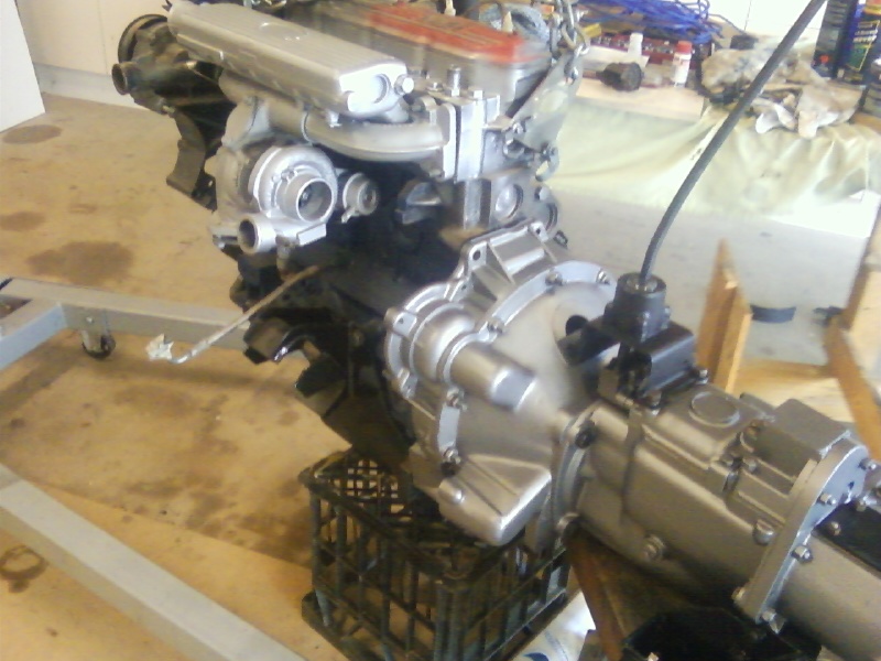

A bit of an update aimed at Robin
I've now decided not to use the 300tdi defender motor because I'm reluctant to cut the chassis and weld new mounts on, just in case I decide to return to the six cylinder petrol motor.
So I've part exchanged my shiny 300 tdi motor for a 200tdi defender unit plus a few $$$$ I plan to get the pump and injectors calibrated and put a kit through the turbo , a bit of spit and paint then install it.
My query is which engine mounts do I need to use to bolt this motor to the series chassis Thanks in advance

Ah, if you've got a 6 pot chassis you're a bit stuck for easy options, I'm think
In a 4 pot chassis a 200TDi drops straight onto the original chassis mounts using the 2.25 engine mounts bolted to the 200TDi block.
In a 6 pot chassis the gearbox is about 3-4" further back so when the engine is mated to the gearbox the engine is 3-4" further back as well!
It can be done - it's what is in Patrick's Carawagon, but we did weld the disco mounts to the chassis, I think about 4" further back from the 6 pot mounts.
The engine is very close to the bulkhead, but the only problem that has caused for us is getting to the lift pump and the broken spill pipe on the back of the injector pump - things are a bit tight.
If you don't want to weld the chassis, I think your only option is to suspend the engine in place with a couple of bolts to the gearbox, then fabricate some mounts to come forward to the 6 pot chassis mounts, perhaps modifying the 4 pot engine mounts
The only other options, I think, are to move the gearbox forward and use 4 pot propshafts, but that means cutting the gearbox crossmember and relocating it to where it would be on a 4 pot.
Sorry Jerry, but it's weld the chassis or fabricate some mounts - no easy bolt-on options as far as I know.
In one of my project 6 pot Carawagons (arrived with no engine) I intend fitting a Defender long-stick gearbox, modifying the transfer box for part time 4WD. As that gearbox is longer than a Series it will bring the engine further forward, though I'll probably have to get custom length propshafts made up and move the gearbox crossmember.
Have fun, and let us know what you decide to do - and take pictures
