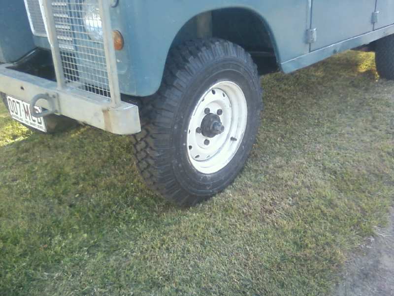

I'm wondering if it's actually possible to get a half decent ride from a series vehicle ?? I've had my springs re set, new bushes and shock absorbers fitted and the ride wasn't too bad on the old Dunlop Roadgrippers.
However. I've just purchased a set of Michelin XZL's (cos they look good ) but it now rides like the tyres are filled with concrete , talk about one step forward and two back
It's making the vehicle rattle and shake to pieces, it's driving me mad

G'Day Jerry - the XZL is an excellent expedition tyre BUT it hasn't beeen produced for several years, and if those are 7.50 x 16s, they must be around 10 years old at least. Also. these are reinforced tyres, designed to carry heavy loads. Try reducing the pressures to around 2 bar all round for fast road use. You could go down to around 1.5 if you keep the speed down to around 90kph, and the load to around 750 kgs. You seem to be using 130 (wolf) rims which are tubeless, so you could go lower off-road, but I wouldn't recommend that over 80 kph loaded. These are great off-road tyres, but not designed for comfort or silence!

These tyres are supplied on new 130 Puma Dual Cabs here in Australia, I purchased the rims and tyres from a guy who had fitted bigger rims and tyres to his vehicle, so they are as new.
Amazingly they cost $440.00 per tyre and a wolf rim is $220.00 (unpainted) Fortunately I got them at half price, I'll try lower pressures in them before I give in and sell them. At the moment I'm running 38psi front and 42psi in the rear.
