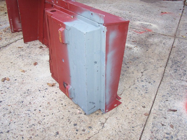

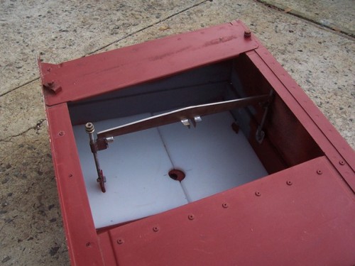

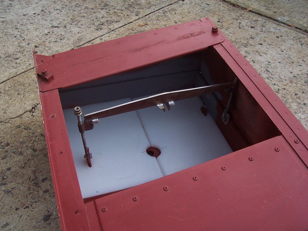

Two batts under pax
Two batteries on extended trips are a must, running a fridge,lap-top,and lighting ... So with a bit of cutting and welding, I put them under the pasenger seat. To get h/duty batteries in the round edge has to be squared off, which still leaves room for electrics and wireing... The pic's show a defender seatbox, I think the series ones are built square in the beguining...Jock ...
