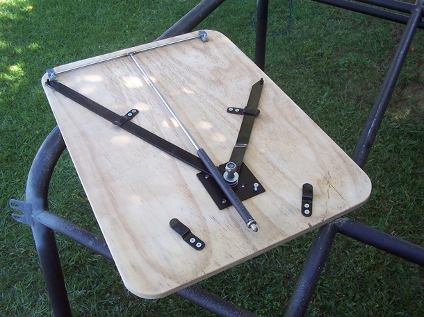

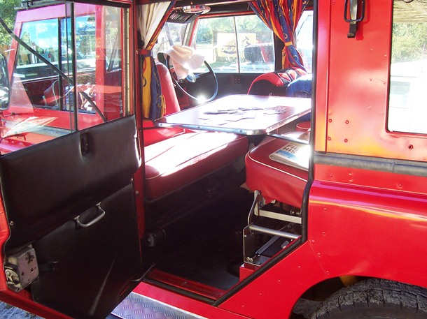

Hi Jerryd, Your right my dormi was in LRO a few years back, just after the resto, and the blue one that was for sale here in Perth, belonged to Marc, I called him and he was not selling, he is into real eastate and using the dormi for a prop for his buisness, (shame)... Here is a pic of the curtains, sewen by my own hand, (story att LRO) and a pic of the table just finnished ....Jock...

Looks really good jock, I must admit I dug out the feature of your dormobile and had another read, a friend has now borrowed it.
I called in at spotlight and had a look round at materials, I note that you've put the sun block material on all the curtains, does this make much difference in summer ?? I thought I'd use it as a liner on all curtains to stop the heat and to stop the sun bleaching the material.
I purchased a new table from Jim at "dormobile uk", it's well made but all the fittings were fitted wrongly so after I re fitted everything I now have lots of screw holes showing underneath.

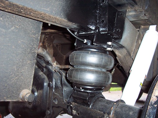

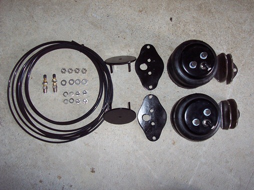

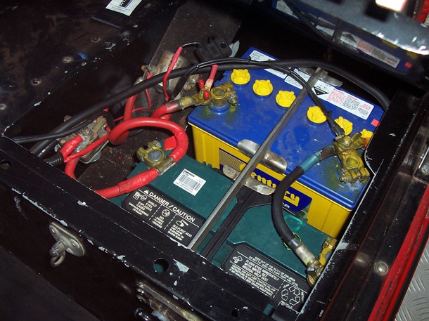

G'day Jerryd, just thinking about your table , it might be for a left hand drive, that would make the fixings a wee bit difrent. Looking through the workshop you are fitting duel batts , I have mine under the pax seat, with room for the solinoide, a bit tight but all works well... The air bags are a good adition, after fitting new springs to the rear, the ride was that stiff all the pots and cups would rattle, and bring travel on dirt roads to a crawl, airbag-man and arb have the bags but not the kit for our model, just re fitted the old springs and made up brackets for the air-bags where the bump stops used to be ..... Jock

Ah, I've not seen that air suspension mod - I thought you were talking about safety airbags (for driver/passenger) and was going to ask you how you managed that
I wonder how strong they are? Could they cope as the only springs, or are they just assisters?
A rare mod over here, from years ago, was to cut off the rear of the leaf springs and fit coil springs between the bump stops - just like your mod but only using the coils for the suspension.

Hi Robin,
I think the air bags were manufactured as a sort of helper for overloaded leaf springs, I only run with 15 to 20 psi just enuf to take the sag from the old leaf springs, and get the best ride on all road surface's, air bags on there own would need some sort of radius arm, or as you say the front end of the leaf spring, also maybe have the bags interact with each other for off road driving, (hide the grinder).. Dont want to get to carried away with on board compressors, and air tanks, but the thought is there ! ! !
