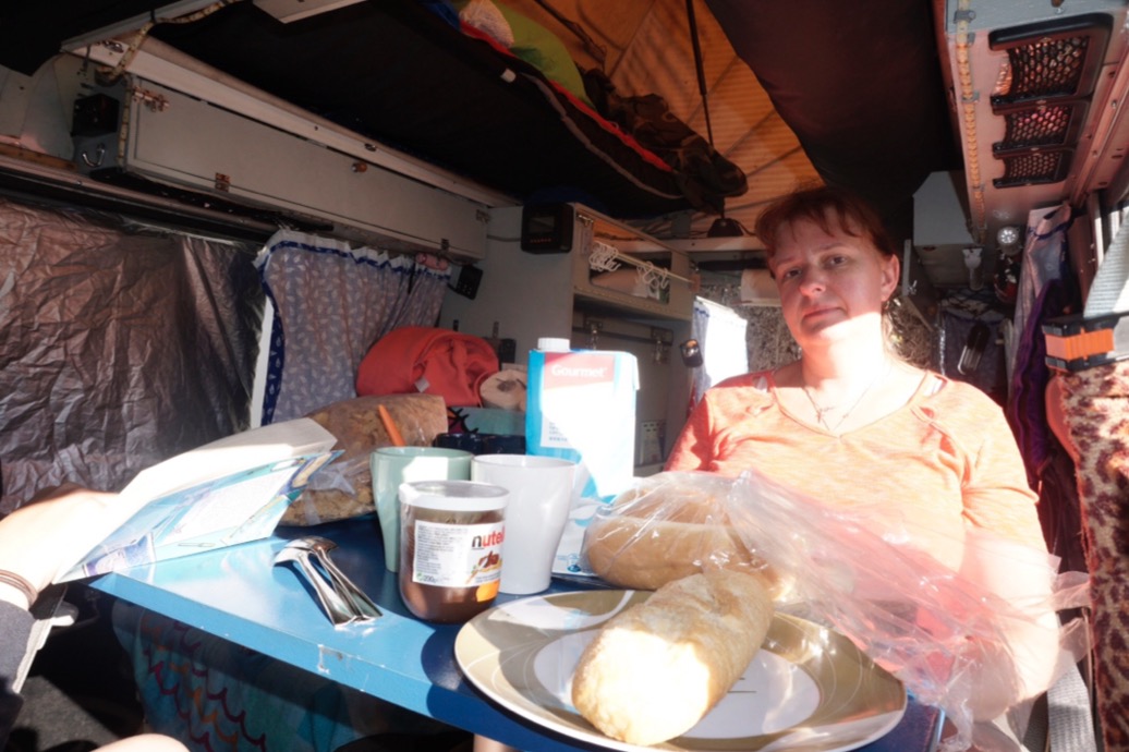

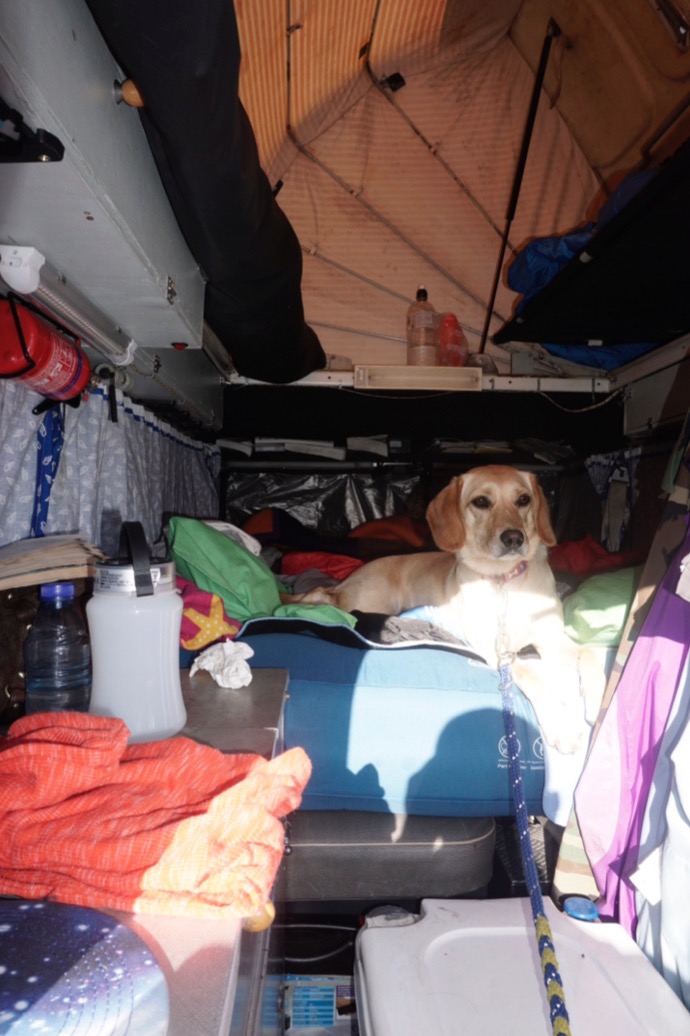

As promissed, some photo's from our Summer holiday trip to Spain, Andorra, France.
You can see the gas struts in situ.
