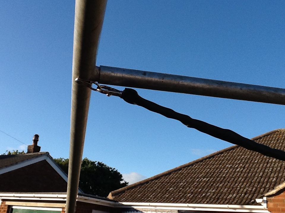

G'day chap's, with Janie having taken the pictures earlier of the light weight chain that has a sleeve of heat shrink shrunk to the shape of the chain partially covering the clips at each end although the idea worked OK i found something better in among the junk in the back of the truck.
This was attached to a seat belt mount that was used a long time ago to stop one of my St Bernards jumping out while i got organized with the other old gal, unfortunately those girls are not with us now so i set to and made another very much the same as the others but the plastic cover that encases a stainless steel braided wire that is the main strength of the lead was what i had to work on.
With 2 inches of the plastic coating removed i set to and made a loop round a 1/4 inch bar then bound it tightly with wire then soldered up the binding all nice and neat but to finish it off again some shrink sleeve was used and i am now happier than i was before :wink: .

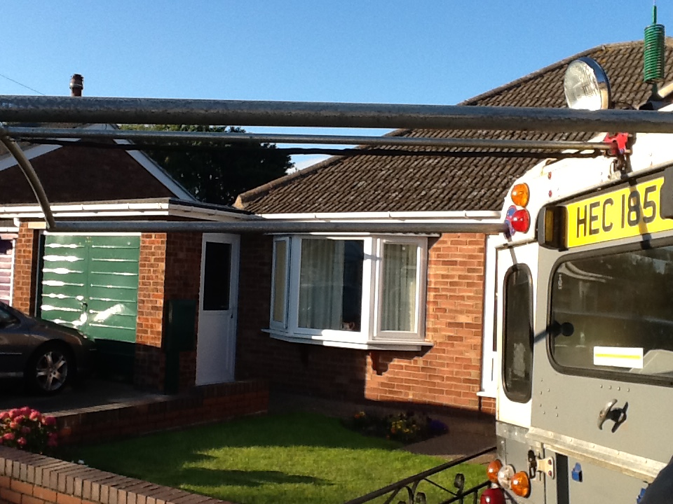

Well i know i am slow but WOW! i am even slower and more confused :stars: but i carried on with working out a locking system to stop my canopy flying out of it's tubes with the power of the old 2-1/4 petrol but on the other hand i could just be going up a very steep hill which i guess is more like it :laugh: .

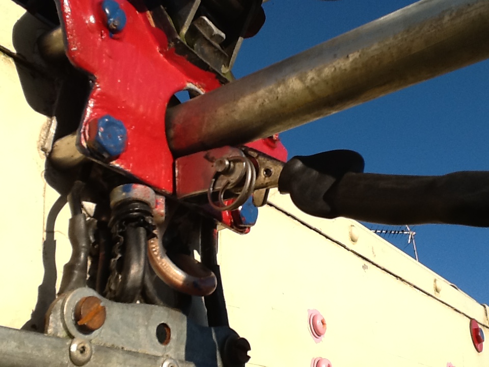

I have a small R clip soldered to a brass sink plug chain and the other end riveted to my alloy work light bracket, an inch in depth stainless steal U shaped bracket is riveted to the bottom part of the work light mounting below the work light bracket that also has the hole for the center pole of the canopy, a picture when Janie gets back on Sunday will help one understand :shrug: .
Anyway the other half of this nice brass sink plug chain i soldered an inch long steel clevis pin the same length as the chain with the R clip on and riveted in the same way but on the opposite side of the bracket mentioned before which means i can't drop or loose anything at anytime for what ever reason :wink: .

G'day chap's, well after a bad day yesterday i got up late morning a lot more positive and took my St Bernard to the park just up from me so she could have a wonder get tired and sleep till 1500 hrs which is her tea time so while she was asleep i concentrated on the little job i tried to do yesterday after i had found a clevis pin the size needed.
Having lost the small chain and clevis pin i had soldered up yesterday :shrug: , for the life of me i could not find one even though i have a large selection safe out of sight of some that come scrounging but can't help in anyway which is why i can't find because of my memory :embarassed: .
Anyway in the end i found a box of new tapered type of all sizes so with soldering done i now have a small R clip on one chain and the clevis pin on the opposite side with both chains riveted to the said bracket i mentioned yesterday :woohoo: and it works as i wanted it to.
