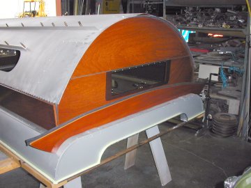

Those two long pieces of wood should join the piano hinge on the roof to the piano hinges on the edge of the flexible section!
I hadn't noticed in the earlier pictures, but you can just see where it's missing in that last large 'rear' photo you posted.
This is probably the clearest photo I have of the 'assembled' roof (I think it's actually Steve's Carawagon in a previous life)
Roof woodwork
Roof woodwork

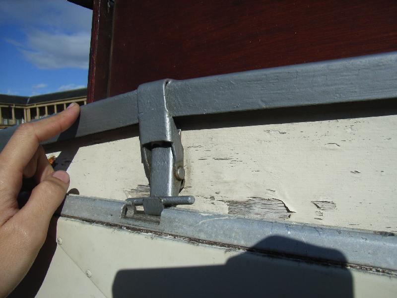

And as mentioned above, you seem to be missing the clamps to hold it down while travelling, which will probably look like this... (I think this is John's old Carawagon from when I was taking some research photos)
Rear roof clamp - John's Carawagon
Hope that helps!

It looks to me as though your roof should have the 'early' setup of clamps on the roof - three across the front and three across the back. On this setup there is no steel angle as in Patrick's photograph.
Below is an early photograph of my motor, showing clearly the early style clamps which yours seems to have had.

Thanks for the pic...... I checked the roof this morning and it is the "early" setup you described, three clamps fron and rear. For some reason all of the clamps had been removed but we found them in a plastic bag inside the car. The two long wooden panels have been removed as the piano hinges seem well past their sell by date. Both upper bunks are still in the vehicle and in remarkably good condition, not sure I'd want to sleep on them though......
