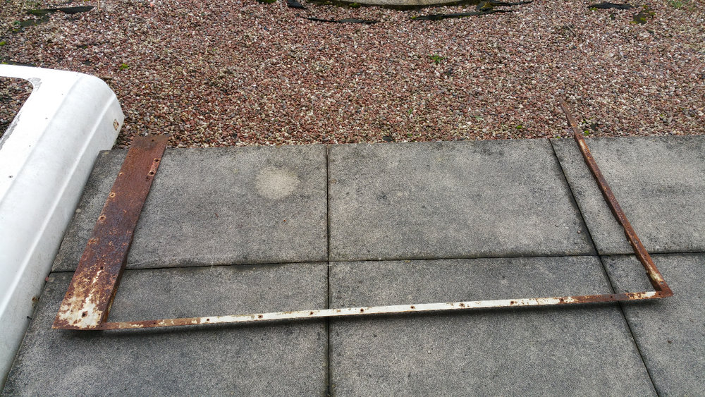

Thanks Rob and in answer to your question Michiel I do have a spare LWB roof (2 in fact - one is a tropical job) and the plan is to make up the dormobile roof using trestles, then take off and mothball the 'pristine' roof which could be re-fitted later. Attached is a photo of what's left of the frame, should have posted it earlier!

This makes more sense with a picture to look at.
I have emailed you the fitting instructions from Dormobile, courtosy from Colin. Hope they are of use to you.
I have the roof open in the mean time and will measure again for you when I wake up later today. Amat work on night shift at the moment.
Do you have the bunks too? And if so, are you going to fit them?
If you are not going to fit bunks, the aperture size is not overly important as it is a lot smaller than the canopy. If you do fit the bunks, then it is quite important as otherwise there might be not enough room to fit them. I'll try and take some pictures later today and post them here.

Got the instructions, thank you. I didn't think the exact aperture size was critical, especially as I don't have the Dormobile bunk frames, although I might adapt a 'stretcher' type to fit. A step nearer....
