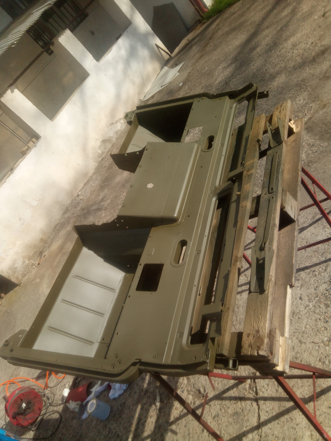

Today I made some progress, Bulkhead is now fully welded up with new footwells and pillars. All is seam sealed and in primer. I also had few small bits laser cut such as engine rear lifting bracket and dashboard instrument panel sides.
Tomorrow I will continue with bodywork pain preparations and painting to make use of excellent weather
