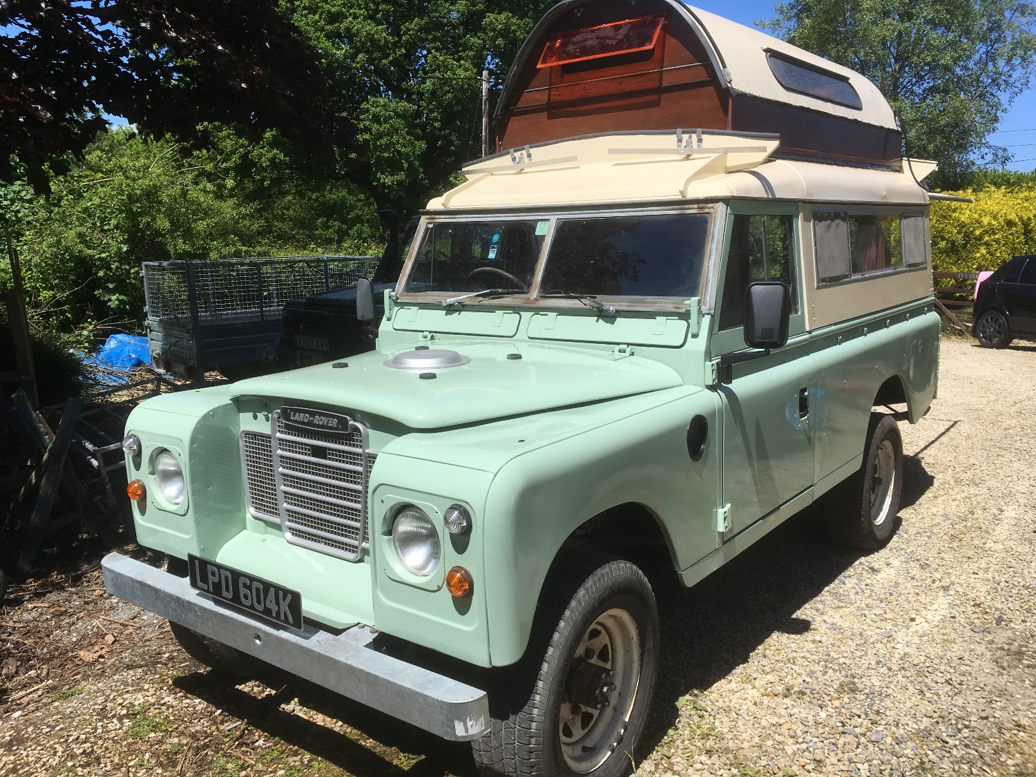

Some more photos showing near completed carawagon
Will take some more soon showing interior

Nicely done Phil
It's interesting that your bungee cords are fitted over the top of the roof. They are supposed to be straight across from one side to the other, so they are stretched when the roof is down, to help when you are lifting the roof.

Hi robin
The bungee is obviously fitted wrongly!
No wonder roof is s bit stiff to put up!
I’ll have to reposition it - thanks for pointing it out
Yes, should be camping this summer!
Hopefully see you!
