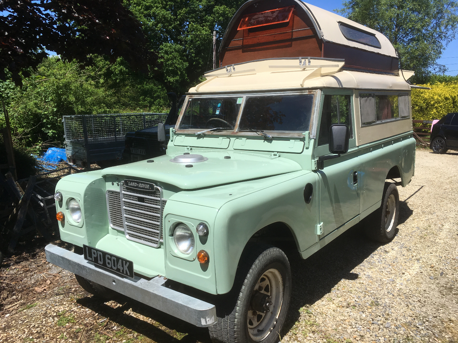

Post by Welshcarawagon » Sat Mar 31, 2018 10:26 pm
Some more photos showing near completed carawagon
Will take some more soon showing interior
Phil
Re: Welsh carawagon photos
Post by RMS » Mon Apr 02, 2018 11:13 am
Nicely done Phil :cheers:
It's interesting that your bungee cords are fitted over the top of the roof. They are supposed to be straight across from one side to the other, so they are stretched when the roof is down, to help when you are lifting the roof.

Post by Welshcarawagon » Mon Apr 02, 2018 6:43 pm
Hi robin
The bungee is obviously fitted wrongly!
No wonder roof is s bit stiff to put up!
I’ll have to reposition it - thanks for pointing it out

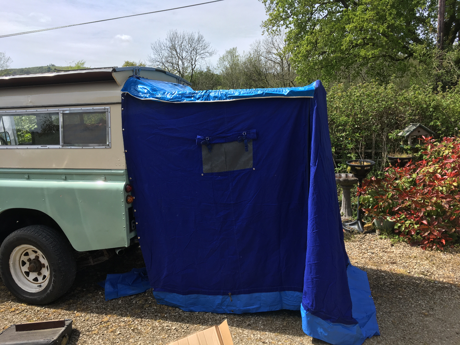

Post by Welshcarawagon » Mon Apr 02, 2018 6:49 pm
Photo of rear!
