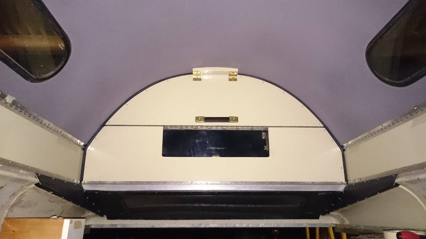

Inside show the flocked roof, we mixed the flock starting with a light grey adding handfulls of black bright red and electric blue to get close to the original. The old flock looked brown but where it was covered with the wooden blocks that the hinges screw into I had a sample or what it would have looked like when new. I could have gone a bit darker but decided to keep it lighter.

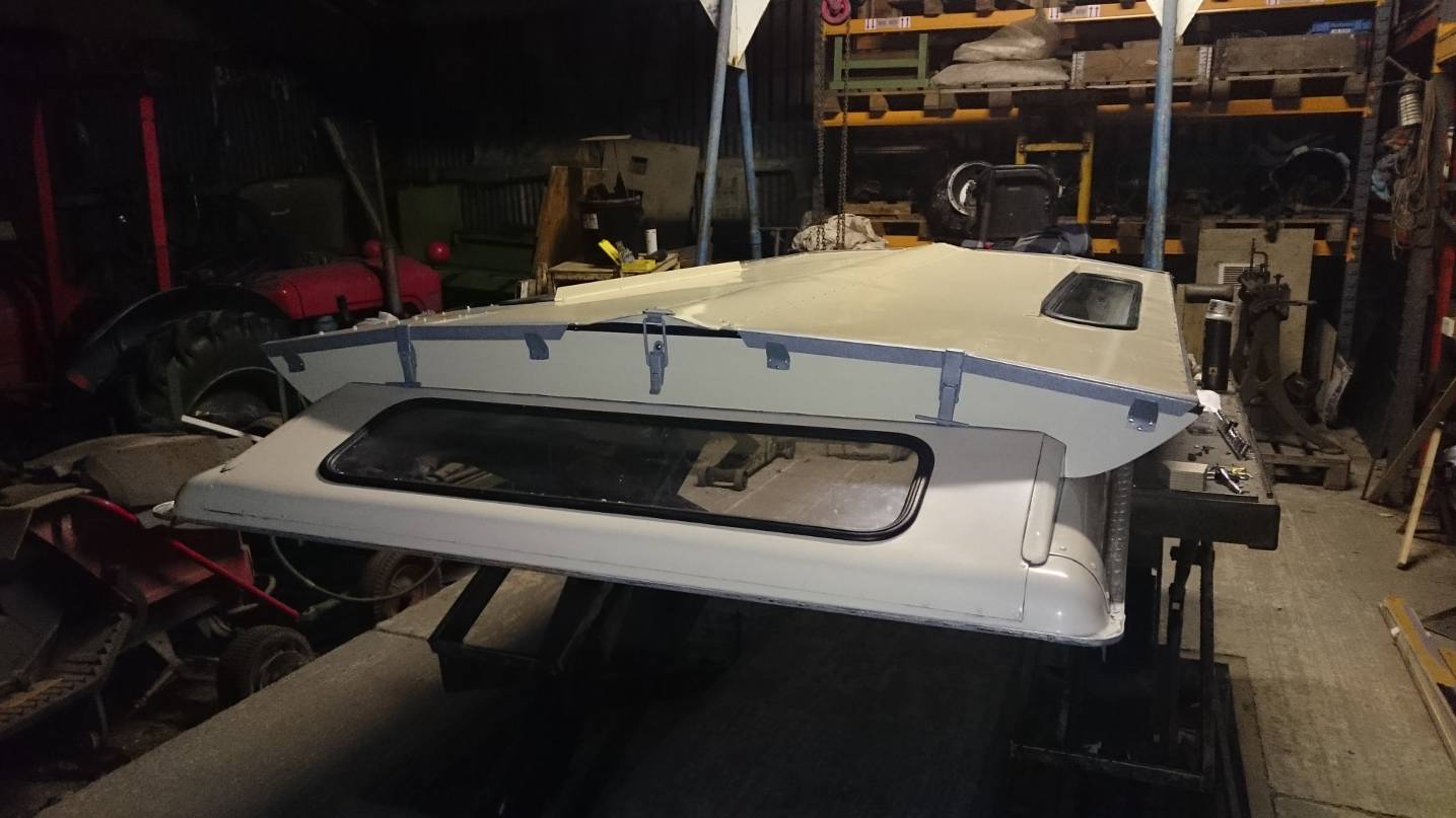

Down, this was the difficult bit, getting the roof to sit flat. Small adjustments on the hinges made big differences to the fit.

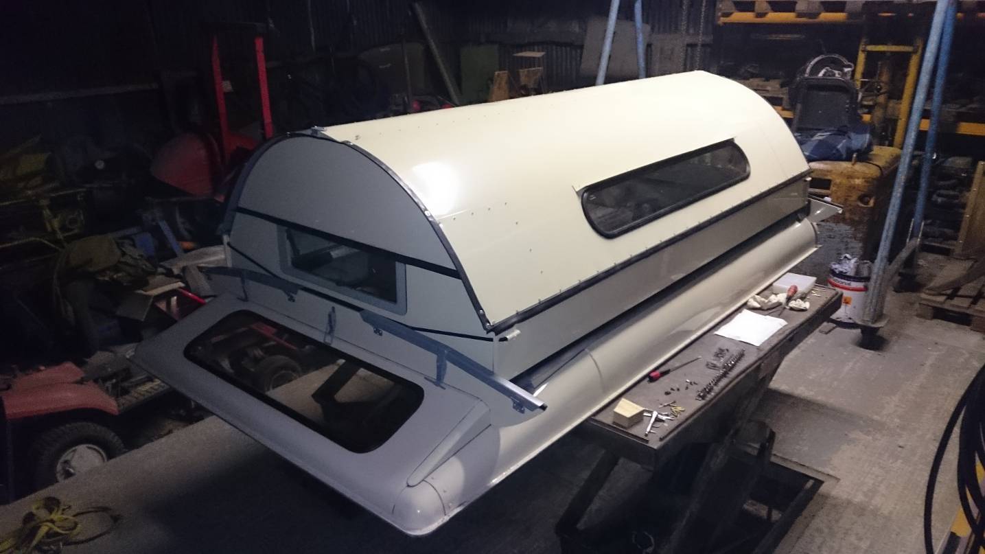

Up
Up
