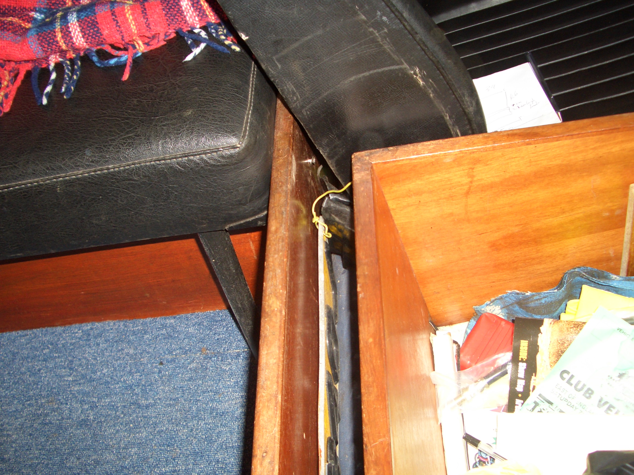

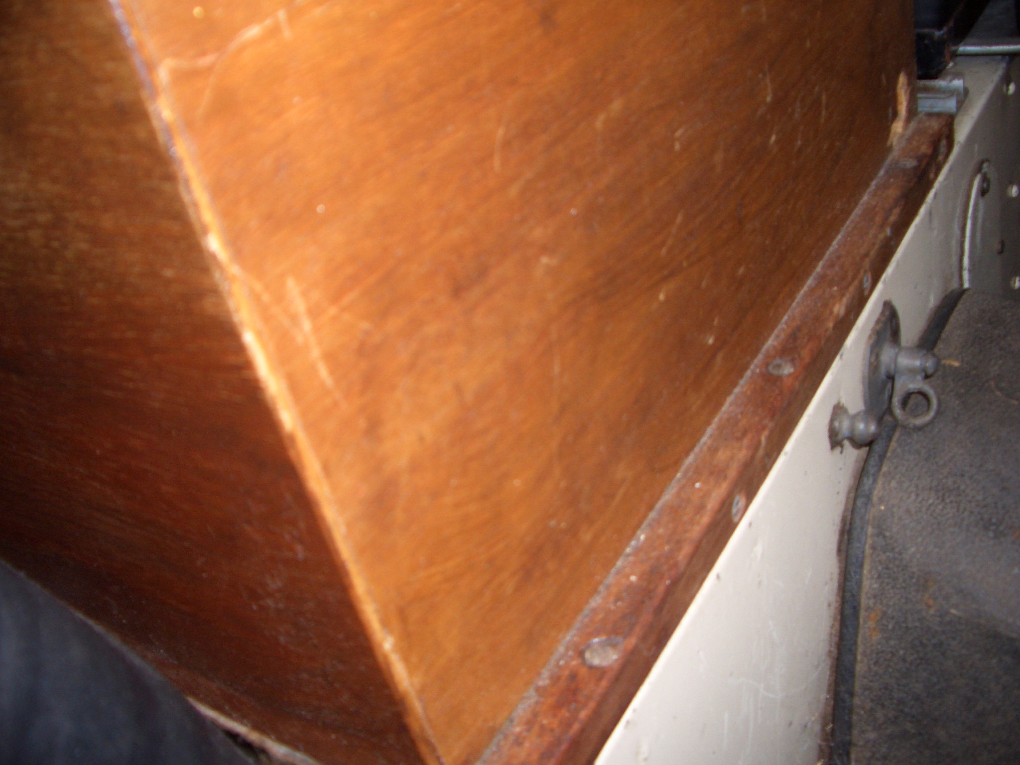

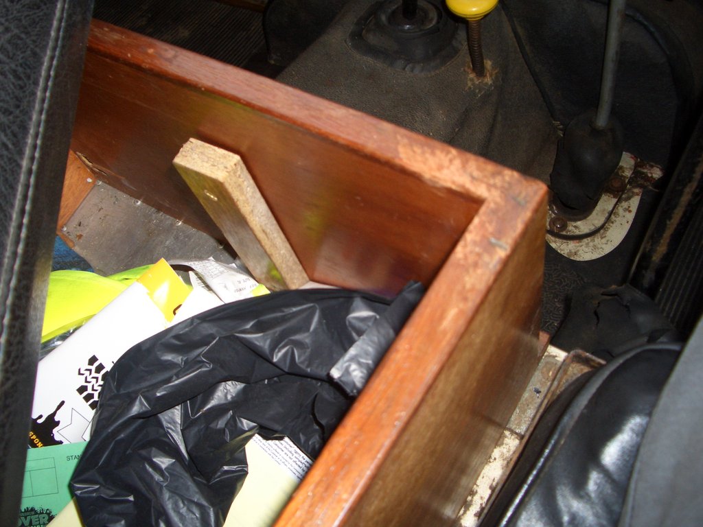

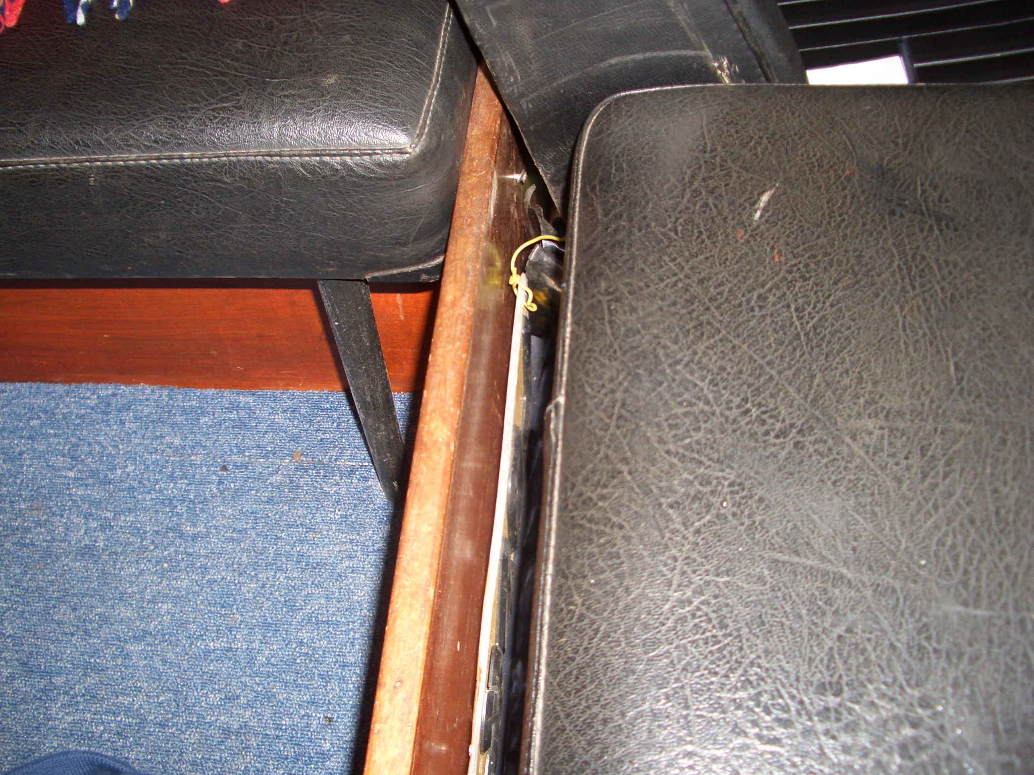

Hi Andy
My cubby box in the carawagon is
39cm side to side and 46cm front to back
external
21cm high at the front,and 27cm high at
the back ( seatbox slope) plus 7cm for the
padded lid.
There is a 5cm gap between the bulkhead
and the rear of the box,a wooden strut on
the seat box at the front,and the lid is 8cm
longer at the front.
I have included pictures to help.If you need
any more PM me
Regards
Phillip :tiphat:
