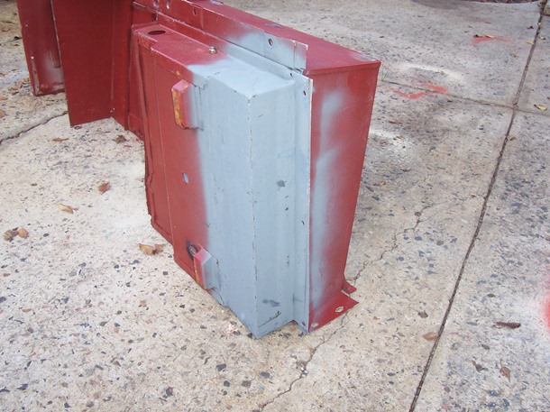

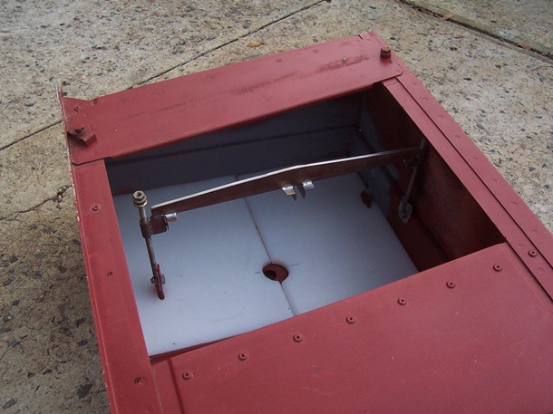

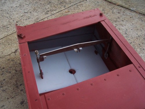

Two batteries on extended trips are a must, running a fridge,lap-top,and lighting ... So with a bit of cutting and welding, I put them under the pasenger seat. To get h/duty batteries in the round edge has to be squared off, which still leaves room for electrics and wireing... The pic's show a defender seatbox, I think the series ones are built square in the beguining...Jock ...

Here's the set-up in my Defender, using a Devon 4x4 battery tray and split-charge relay with twin Odyssey batteries under the L/H seat (driver's in my case!)

G'day Guys ,Both batt's are in conjunction with h/duty solenoid . When ignition is turned on, both batt's are starters + both batt's get charged from an 80 amp alt (solenoid just joins batt's togeather). All axillary are run from the second batt... I run an Engle 40 lit two way fridge, it will run for 4 days without starting the vehicle, if stationary for two days or more I plug everything into a small 2 kva gen set and that will charge batt's and run everything, or if in a van park just plug into mains power ... The solenoid system dose not work to well with batt's (like one h/duty and one deep cycle) the start batt gets full charge, but the deep cycle wont get to it's max charge... I have a pic of batt set-up in Dormobile curtains... I might go for the Redarc system next time as I will be towing a camper trailer and that means a third batt ... Jock
