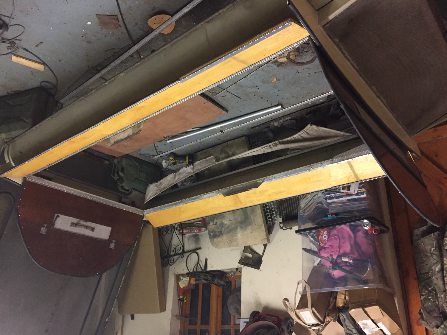

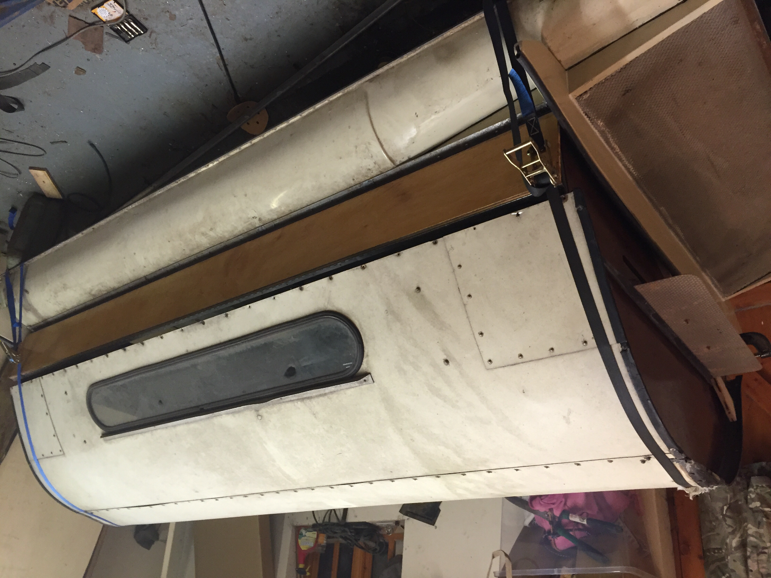

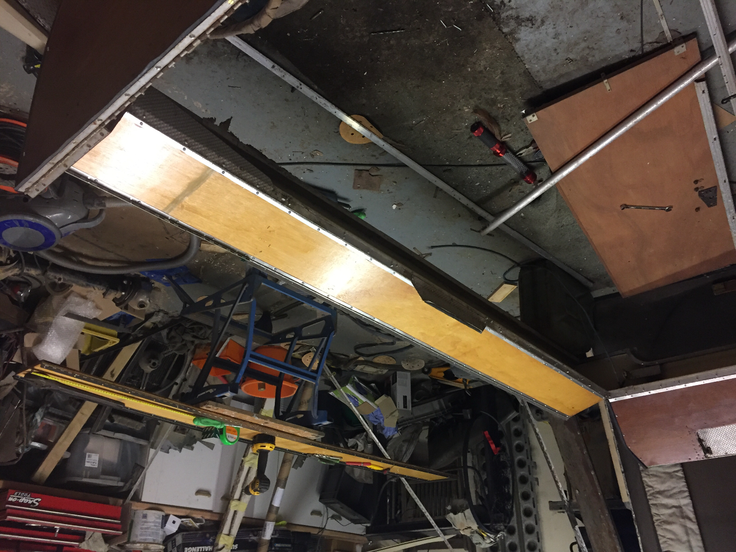

So over the weekend I finished the side panels and mounted them, fitted the rear support stay and sealed the front and rear panels to the roof with tigar seal.
So tonight I refitted the roof. Not very easy on your own but I managed to balanced the roof on my head and screwed the end panels.
Then I tried to re attach the side panels. This is were the frustration starts.
So I tryed with the end panels up to get the rivets in to hold side to the roof. I have a gap of about 2inchs
So then I tryed the end panels fold down and then the stuggled with getting the rrivet in . I
Managed to get two in one each end and then lifted the roof. As it went up it got very tight and then to the point at the top were it ripped the rivet out.
So I've strapped it end panels to try and compress the seals but I am worrying that even if get it together once I release the straps and fold it down it won't com up again.
I've measured the side panels 1950 mm same as the old ones
The end panels are the originals and original front hinge replaced rear hinge.
The side panels are re hinged bit with the same size aul hinge. Holes and mounting ponits the same.
So my question to all you that have resealed refurbished there roofs . Where and I going wrong???
See pictures of the gap
