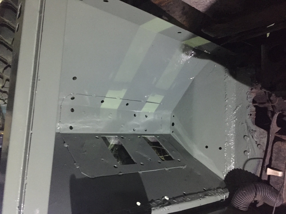

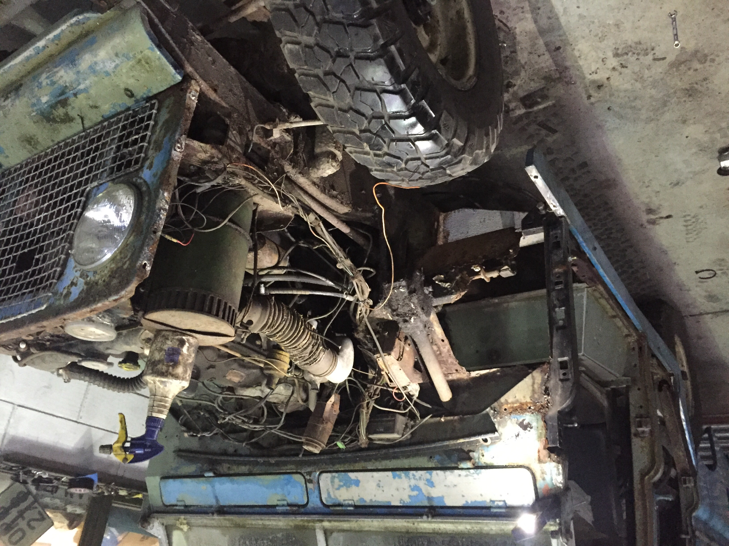

cut the foot well out the passenger side tonight. ready to fit the new one tomorrow.

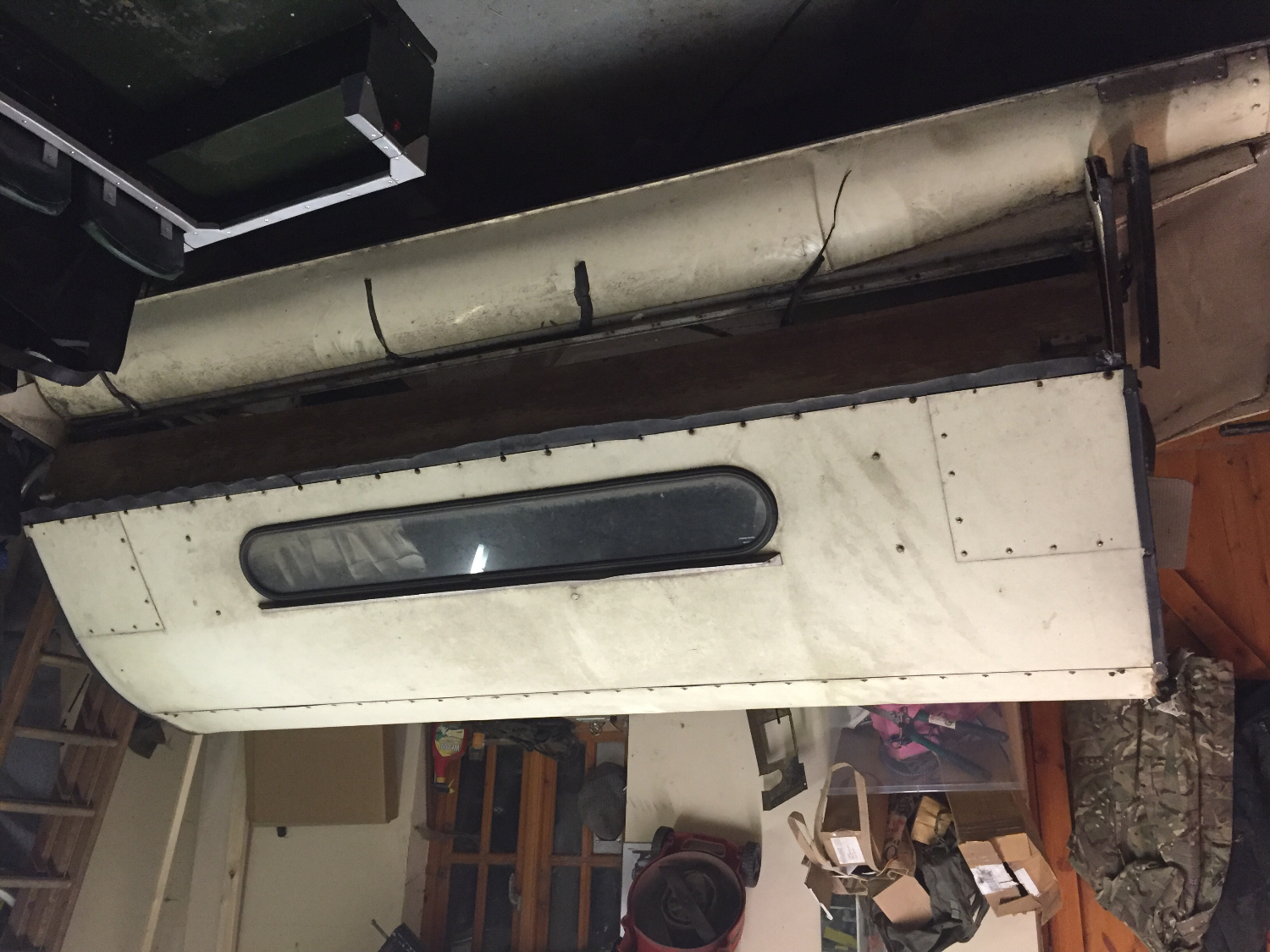

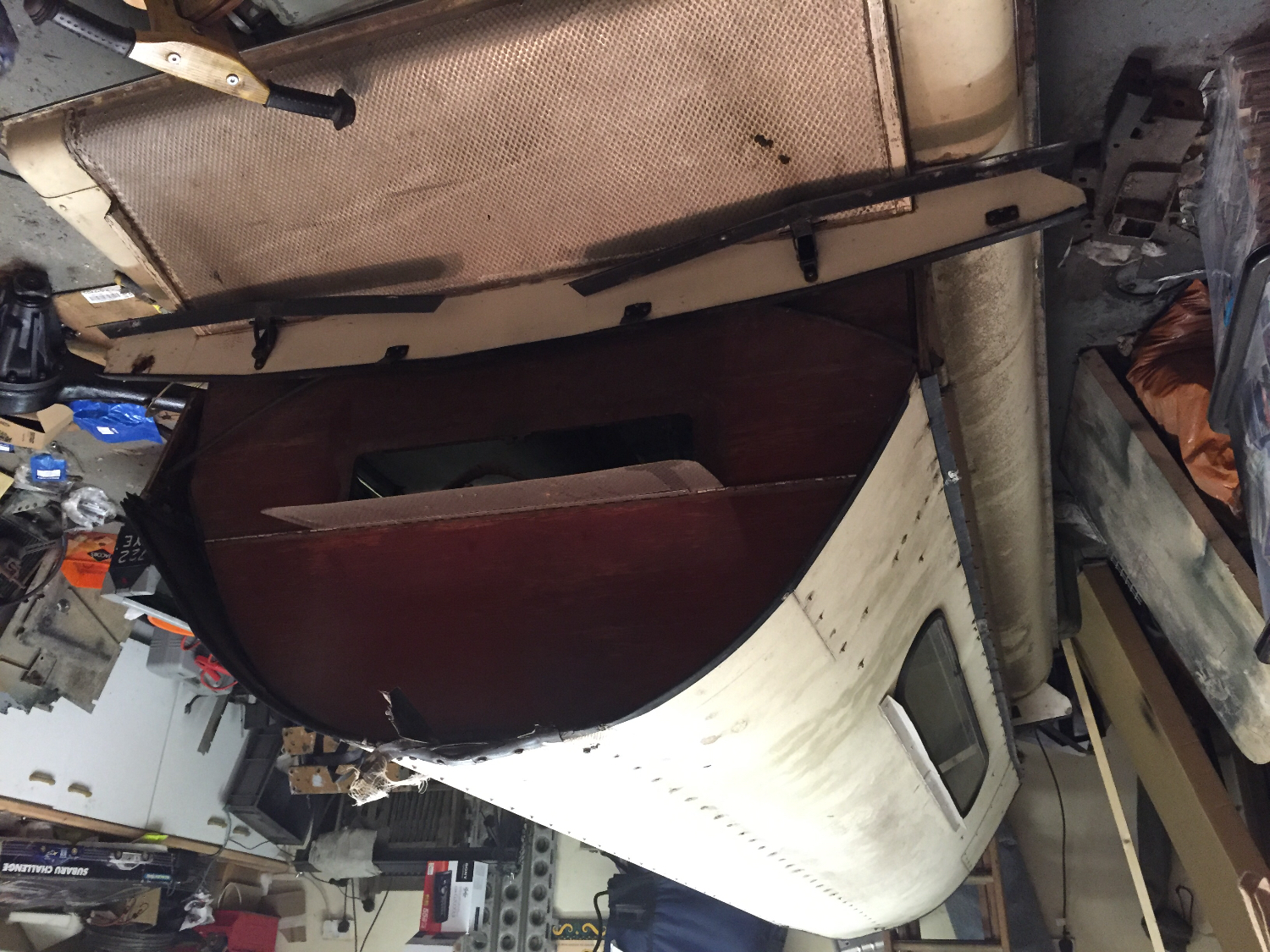

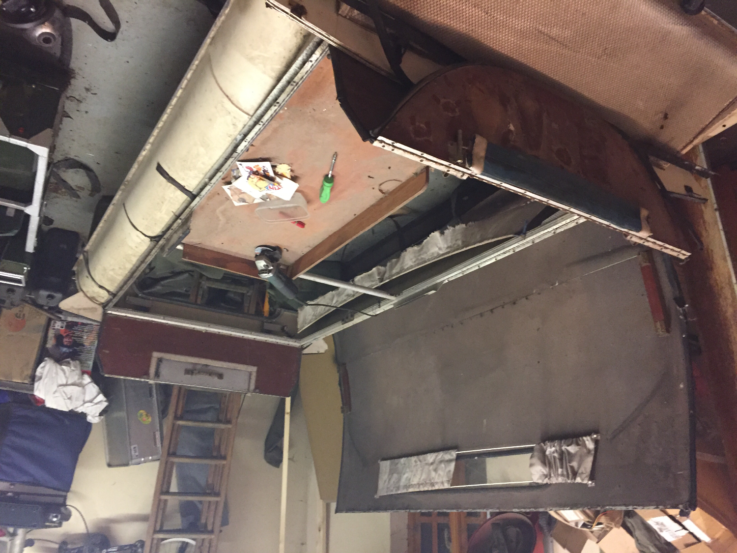

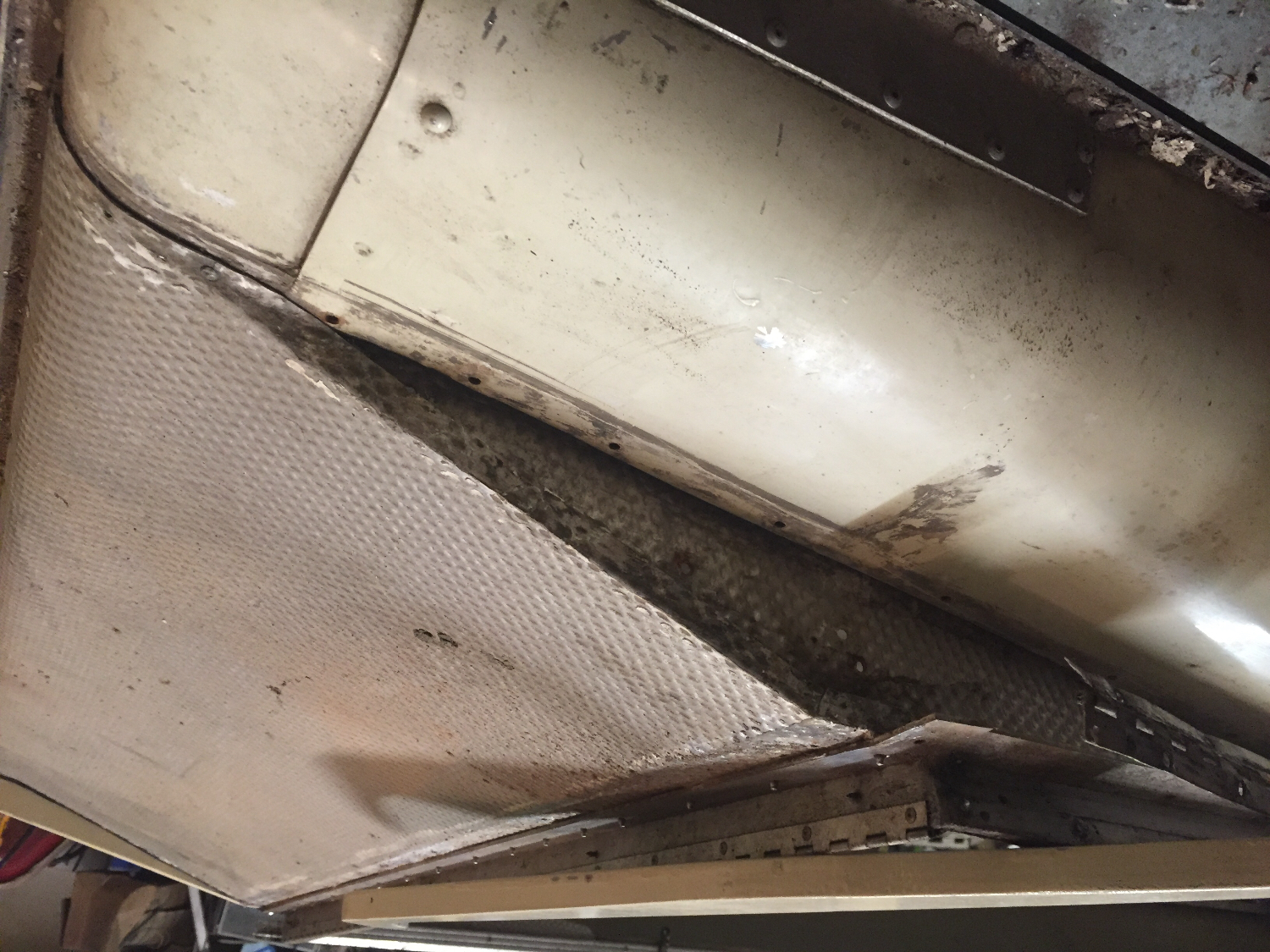

Last night started stripping the roof of refurbishment
Interesting things I found so far are can't make my mind up if the door would have had a roof rack at frontal the wood not been shaped for it?
It has a flock head lining its in great condition but a strange colour.
The wooden tray mounted at the front, which I've guess it's a child's bed? Both my boys fit on it perfectly. It dose look quite in keeping with the rest of the roof any ideas if this is original?
The side and transportation mounts are the worth parts with the end planels seeming to be in good useable conditions
All the seal are missing or be replaced with intertube that been cut into lengths

Good to see you already started on the roof.
Looks in better condition that I originally thought.

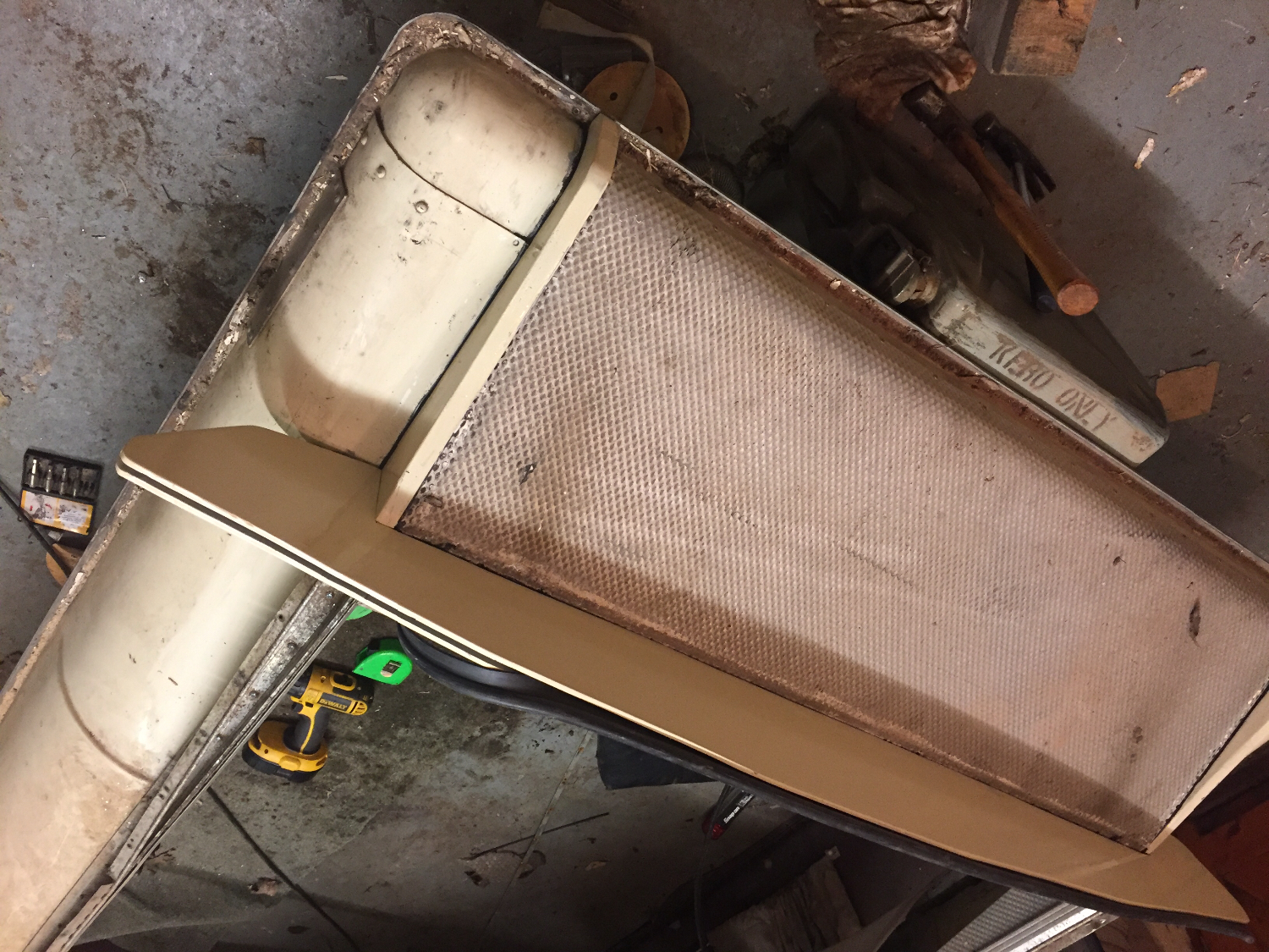

spent the last week cutting new support and front roof supports.
I managed to removed the front roof sections with out dismantling the long alu angle .
I cut the sections out of 18 mm Marine ply . I need to cut the groove in the supports for the seal.
I bought from B and Q there bugit router and found it worked pretty well for making the groove for the seal.
and then 2pack primed them and then sprayed them in limestone
This evening I rebuild the front end.
New hinges and side wood panels to make this week. Should be finished next weekend!

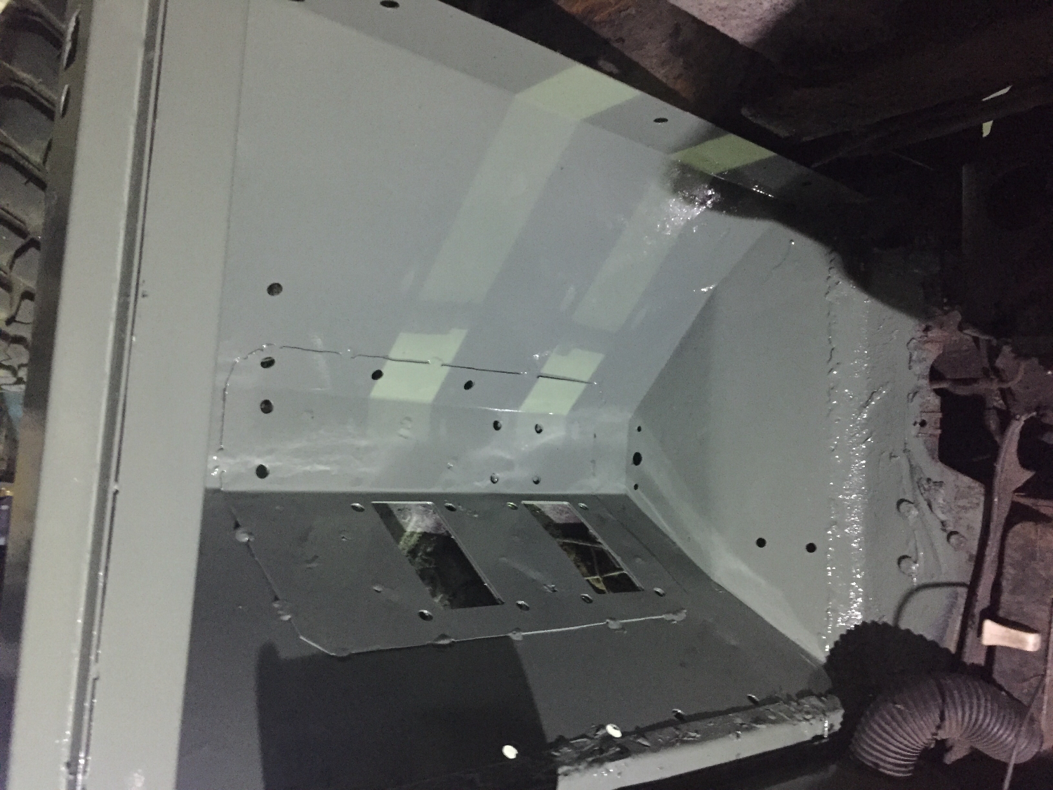

This afternoon/ evening I changed the drivers footwell . It had been poorly repaired in the past with a tota of three repair panels put over the top of the original. The more i cut away the less there was to save. I ended up cutting the inter panel out of and remaking it. After a couple of trial fits finally got it in and painted. I remade the stenghtener that supports the pedal boxes .
Re: carawagon sw series 2 six cylinder
