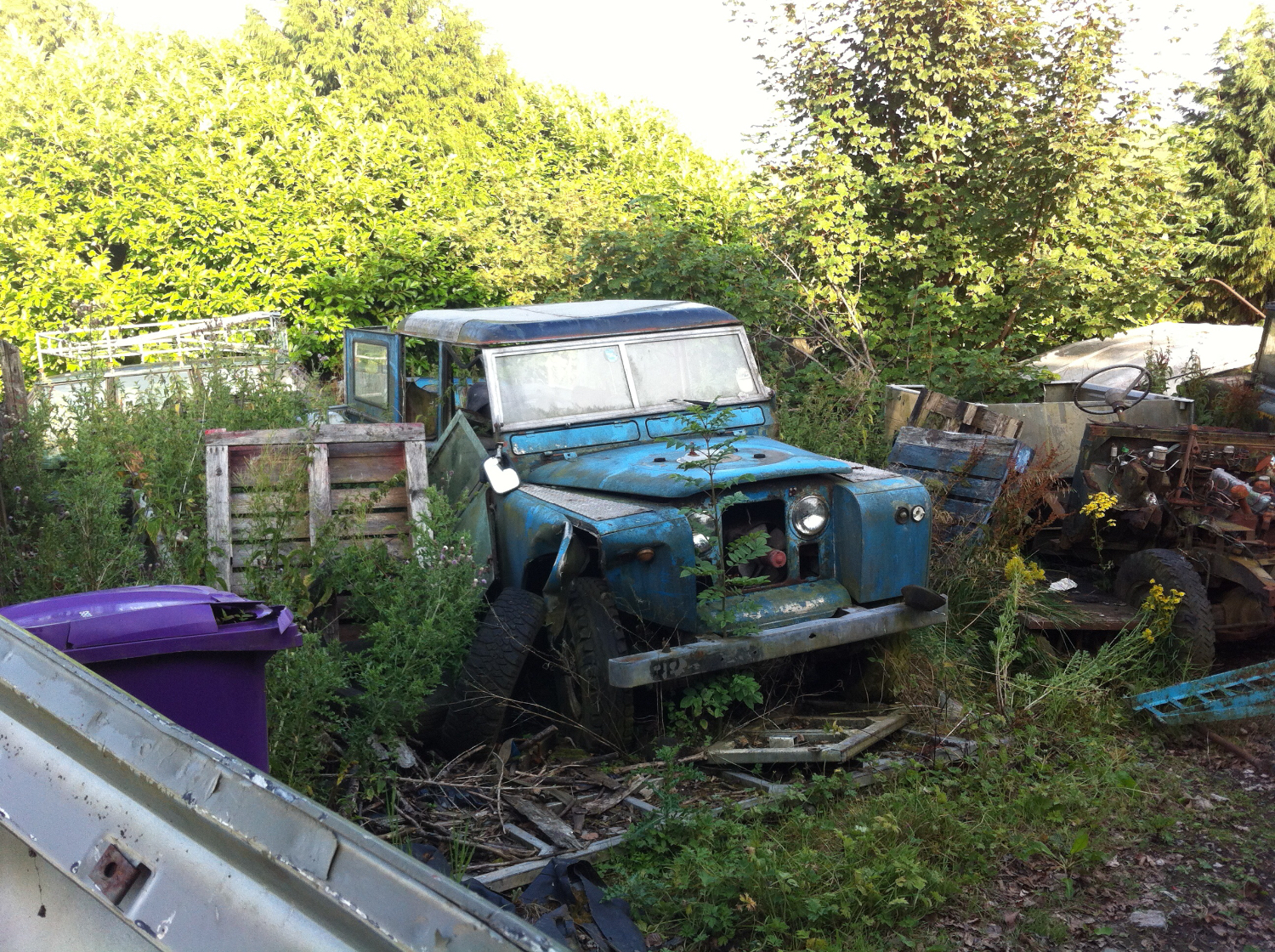

How I found the carawagon in 2014

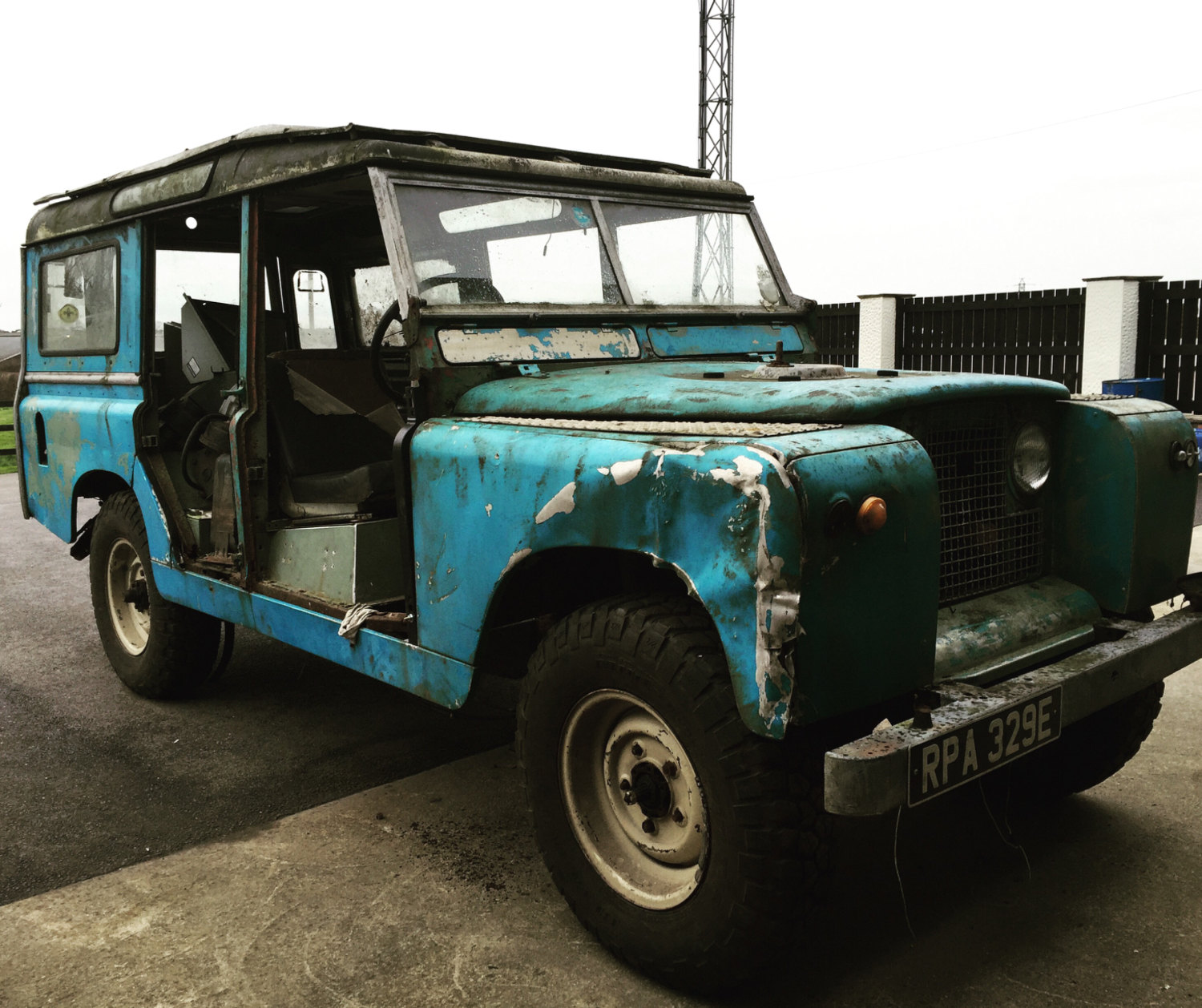

How it stands today, had a break from it for six months due to work and family commitments, in the last week I've fitted drivers side a post and new wheels and tyres, and fitted a safari roof as a temporary measure in till I can find a lifting one.

I bought them at a sod bury last year for a tenner each with bold tyres, when I got them home and try to take the tires off they had the military run flat bands in side with I believe we're fitted to rapper 130s and ambulances. Ended up having to cut the tires off so I could get the bands. Anyway now fitted with bfg muds

Sound like the take-offs VASS used to sell, 130 rims with XZY tyres.

Yeah the old tyres were xzy's I'm pretty happy with the look of them in lime stone on the sw.
