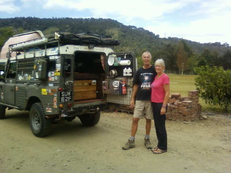

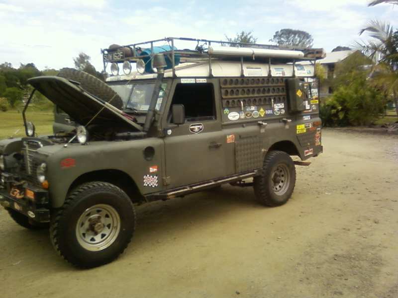

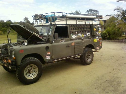

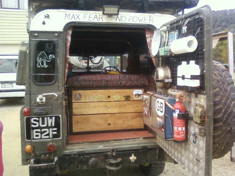

With regards to the reliability factor here's a little tale..........I've been in contact with a couple from the uk who shipped out their 300tdi converted Series IIa to Australia to do the big lap. The conversion was completed literally before it was put in a container and had only been road tested for 50 miles. They said they would get in touch when they were round my side of Australia to talk land rovers and 300tdi conversions :whistle:
Well 15 months went by and I thought they'd forgotten and had long gone home, then out of the blue last week I got a phone call to say they were on their way over :stars:
Well we met up and had a great chat, it turns out that they've covered 27,000 kilometres over here and it hasn't missed a beat :gold: The only problems they encountered was on the corrugated tracks where the rear chassis suspension mount broke off and a few steering problems. Chassis was repaired for $200 and seems to have held up for the rest of their trip.
They return to england in a few weeks time and their land rover gets shipped back next week, he's going to rebuild it with a new chassis and they will return to oz in 2015 for another trip.
I'm wondering if in the two weeks they are here with no car, I could persuade them to help with another conversion :wine:
Here's a couple of pics of Colin + Rose and their land rover
