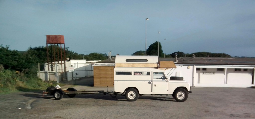

Well, 760 miles later (via the Eastnor show) and the body is home
After spending the night in Truro, we managed to load the body using high lift jacks, packing pieces and brute strength!
I made the trailer in just 2 days last week, and designed it so that the wheels fitted into the wheel arches of the body.
That did mean that the axle was a long way back making it a little front-heavy, but it also made it very stable at up to 70mph
What you can do with an old caravan axle, some lengths of scaffold poles
I've just got to get it off the trailer now and onto another bit of the garden
This is when I wish I had a forklift as it's one thing lifting it on concrete, but it's another trying to do it on soft ground
Oh, and I've just worked out the fuel consumption - 33mpg with empty trailer (but with 3 big bags of wood on the rear just to spoil the aerodynamics and our big top box) and 29mpg fully laden.
That's with varying speeds from 50-60+mph both ways.
I did remove the ammo box from the front bumper on the way back up and noticed there was more power available and the temp gauge was a lot more steady, so I think I need a smaller box or find somewhere else for the jack, oils, rope etc. to free up the rad and intercooler
