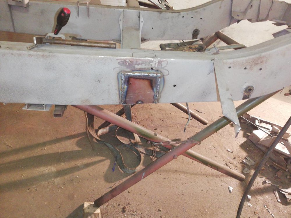

Post by ericappla » Fri Jun 29, 2018 12:51 pm

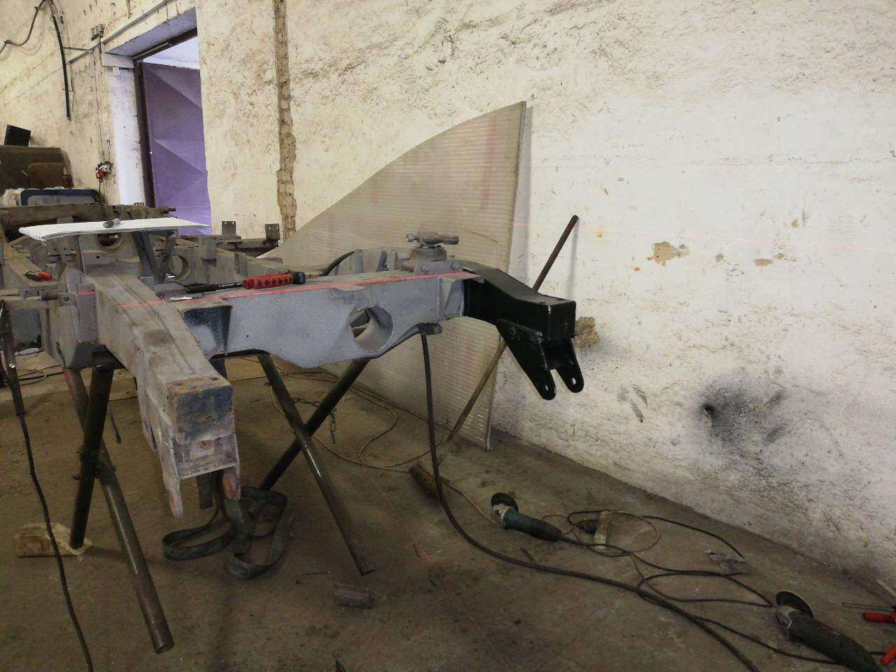

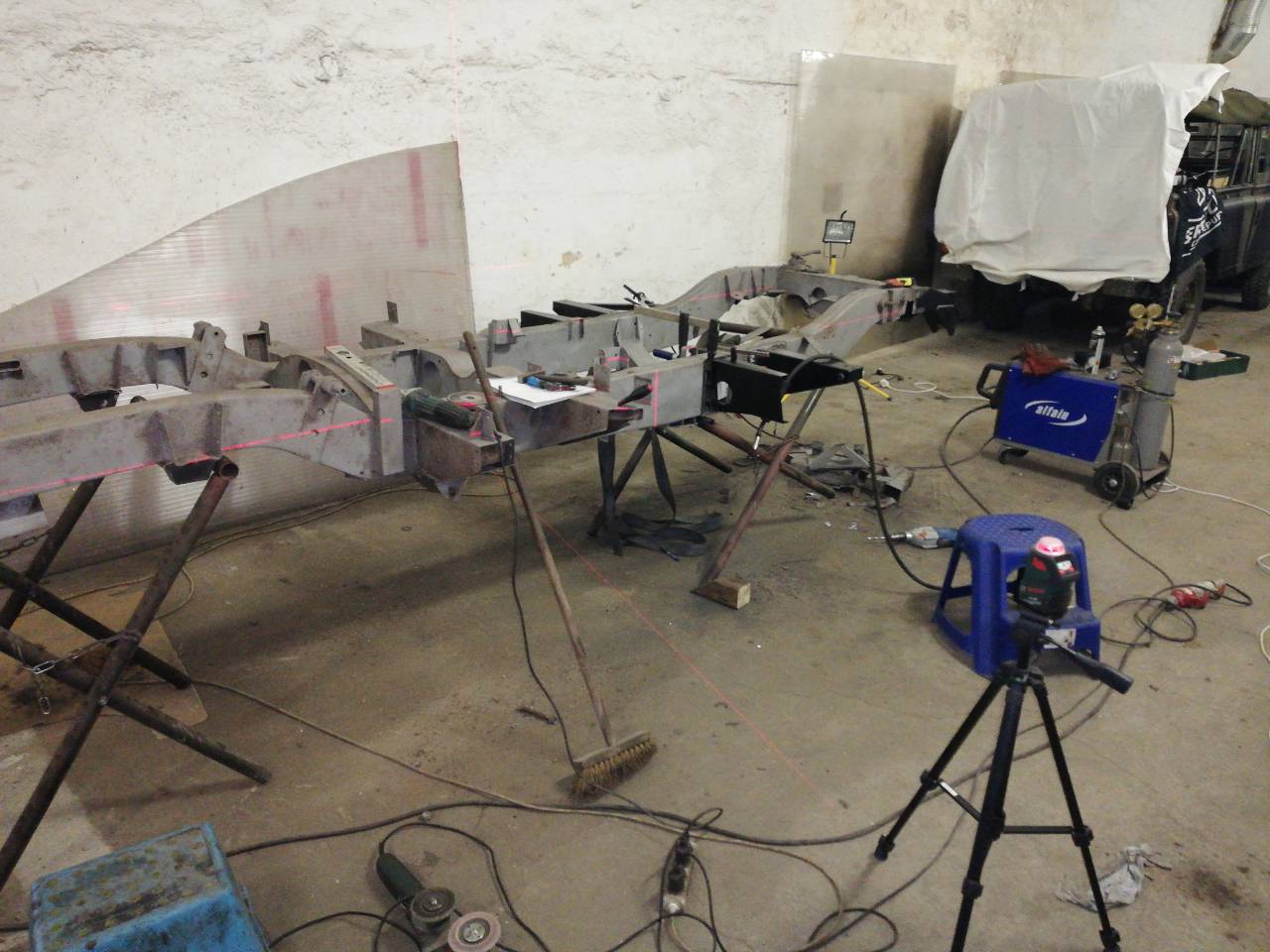

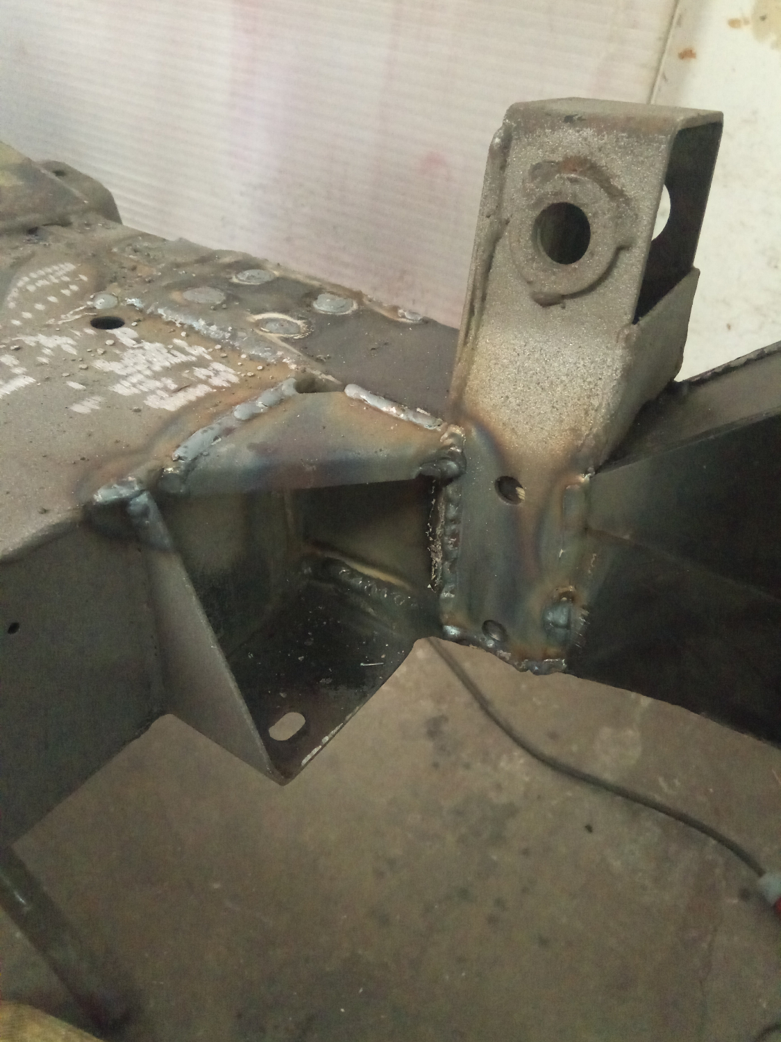

Hey I'm back in business. Laser guides, out riggers front legs all going in with utmost care and presission. Original chassis have about 0.4" twist to it but I take it it's within Land Rover manufacturing tolerances. We will try to adjust it using winch to get it straightened but I think it's already near enough.

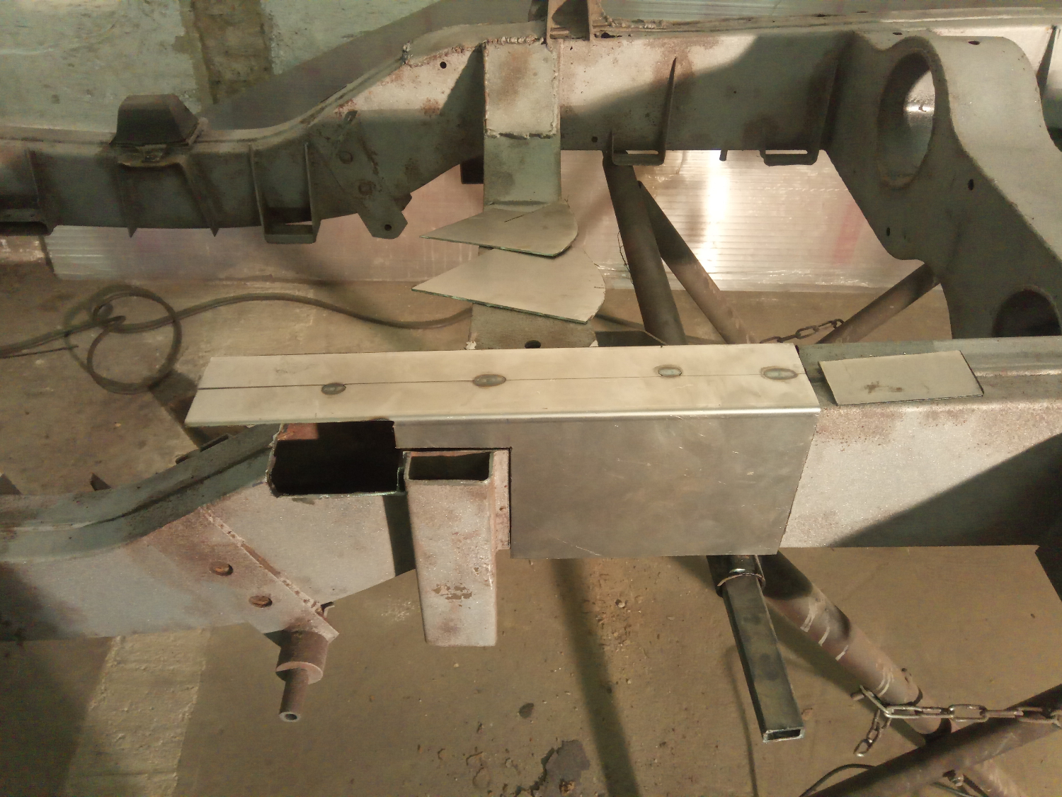

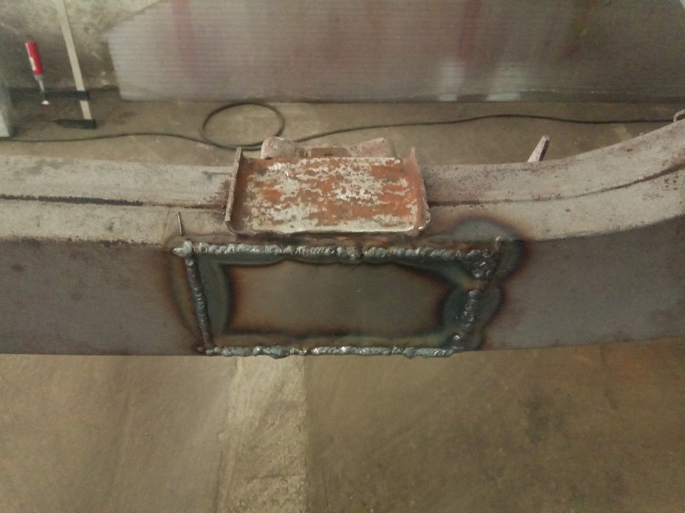

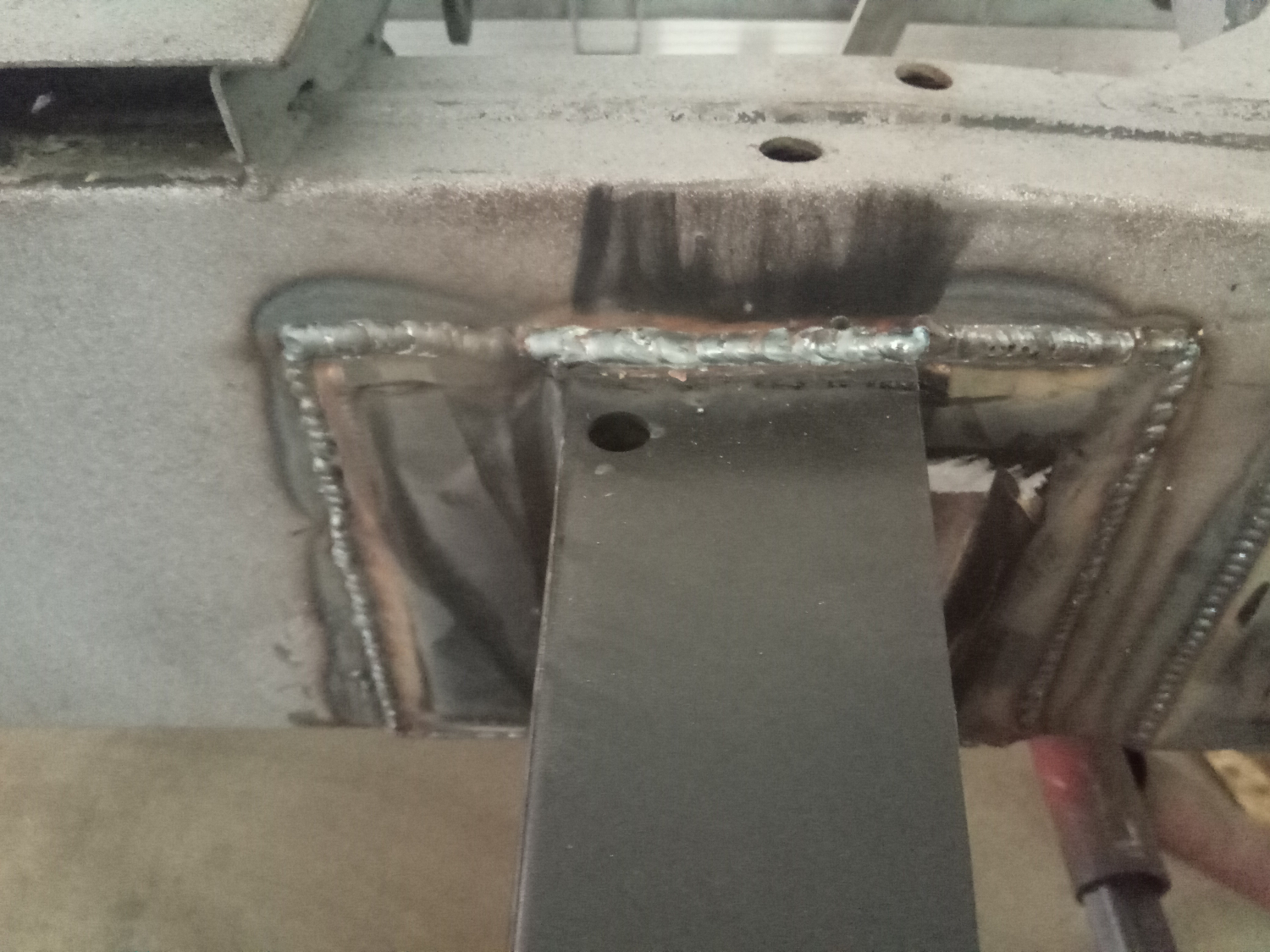

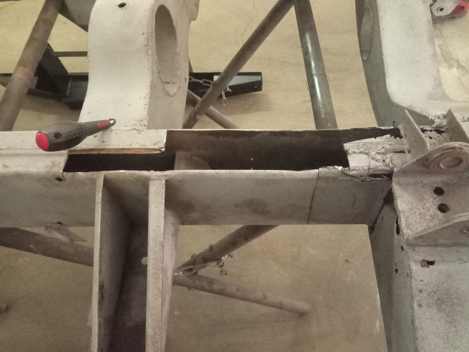

Post by ericappla » Mon Jul 02, 2018 9:29 pm

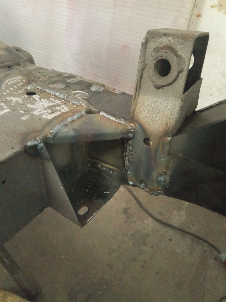

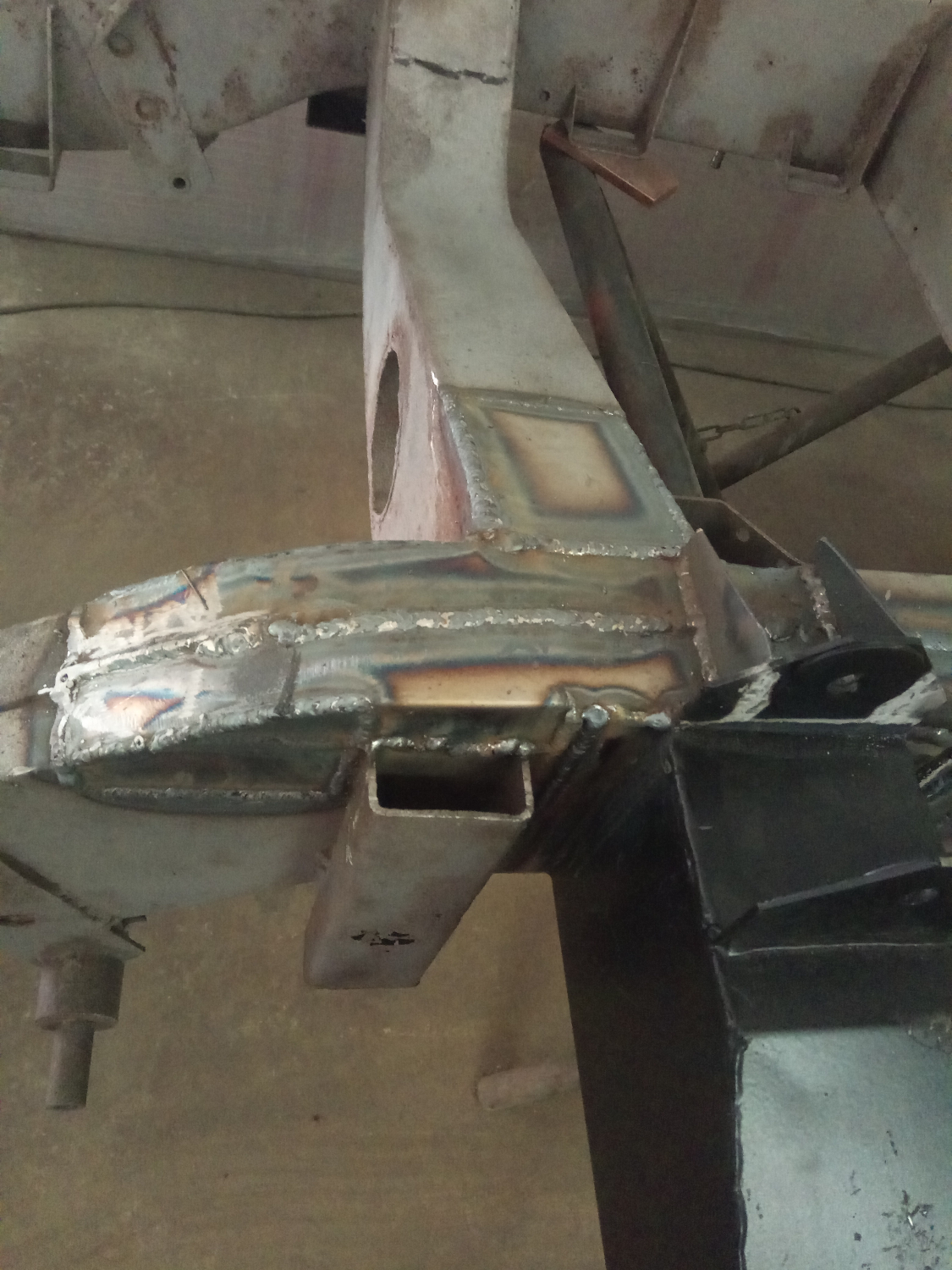

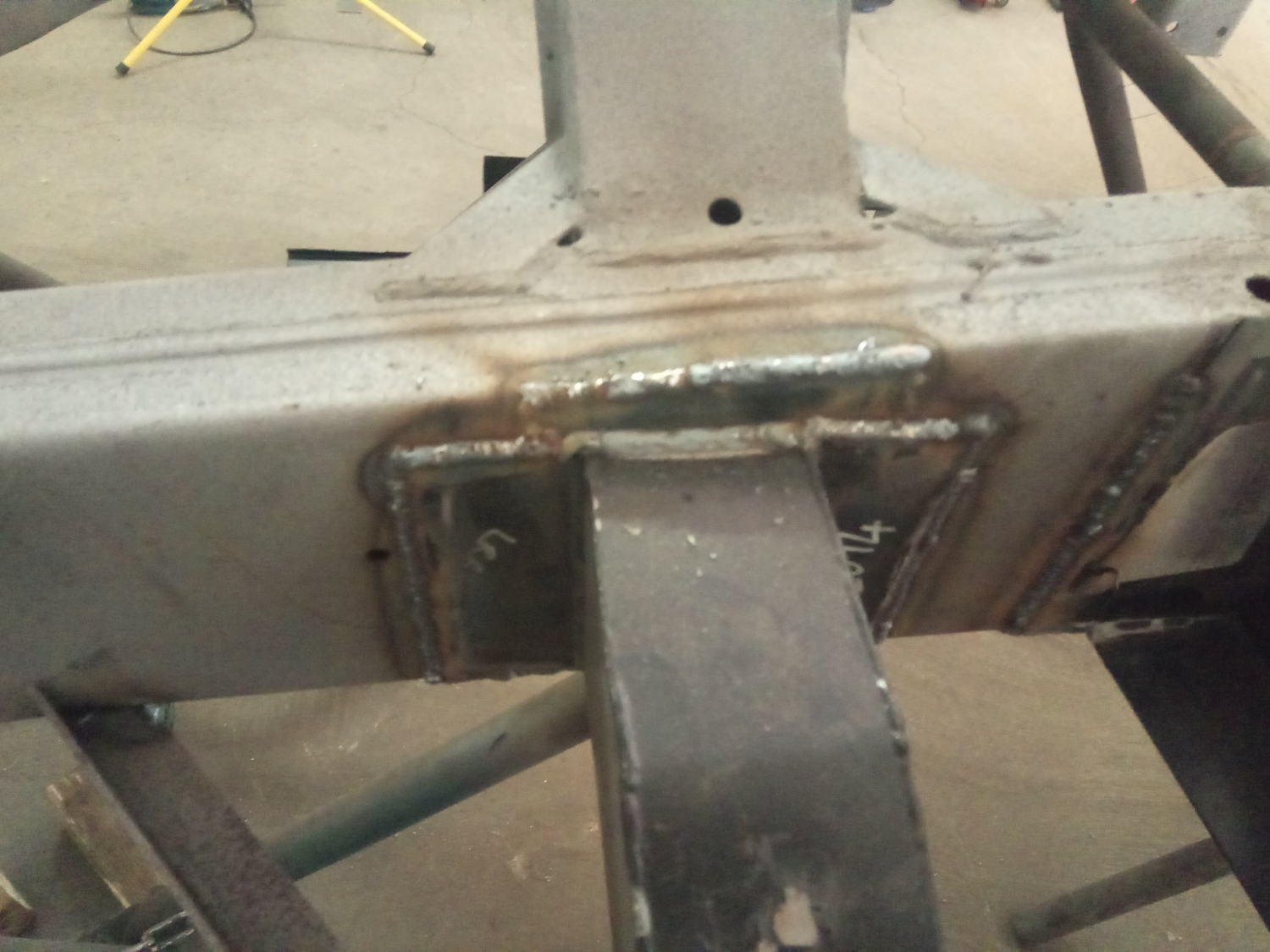

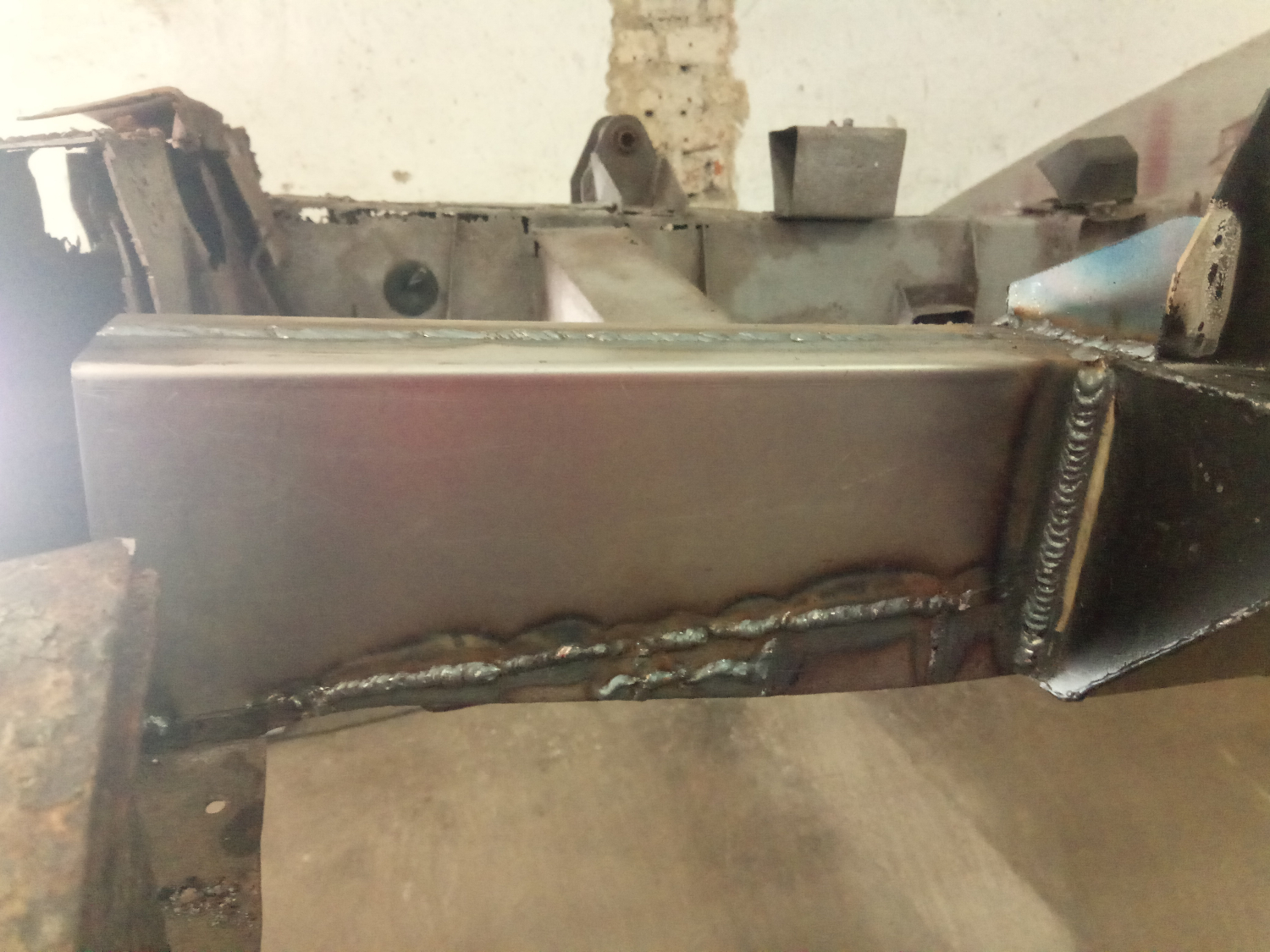

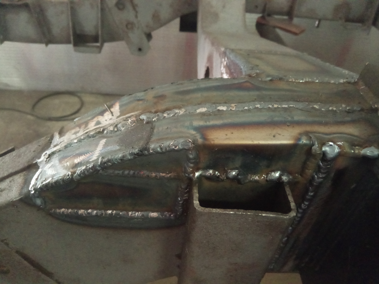

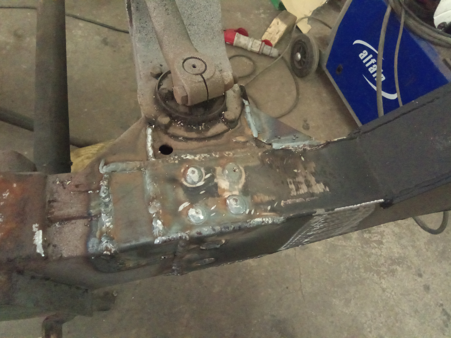

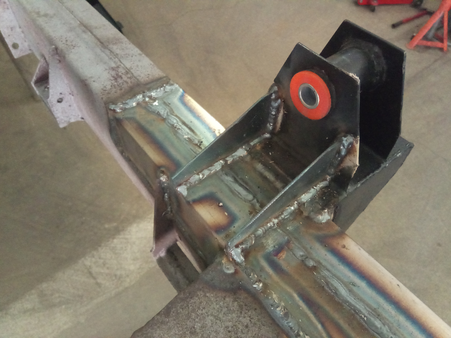

Another full day at the workshop with my mate. We got there for 7AM, did heaps of welding and fabricating, but at the end we run out of 1mm cutting discs and welding wire so we finished early at 7PM. To be Continued tomorrow

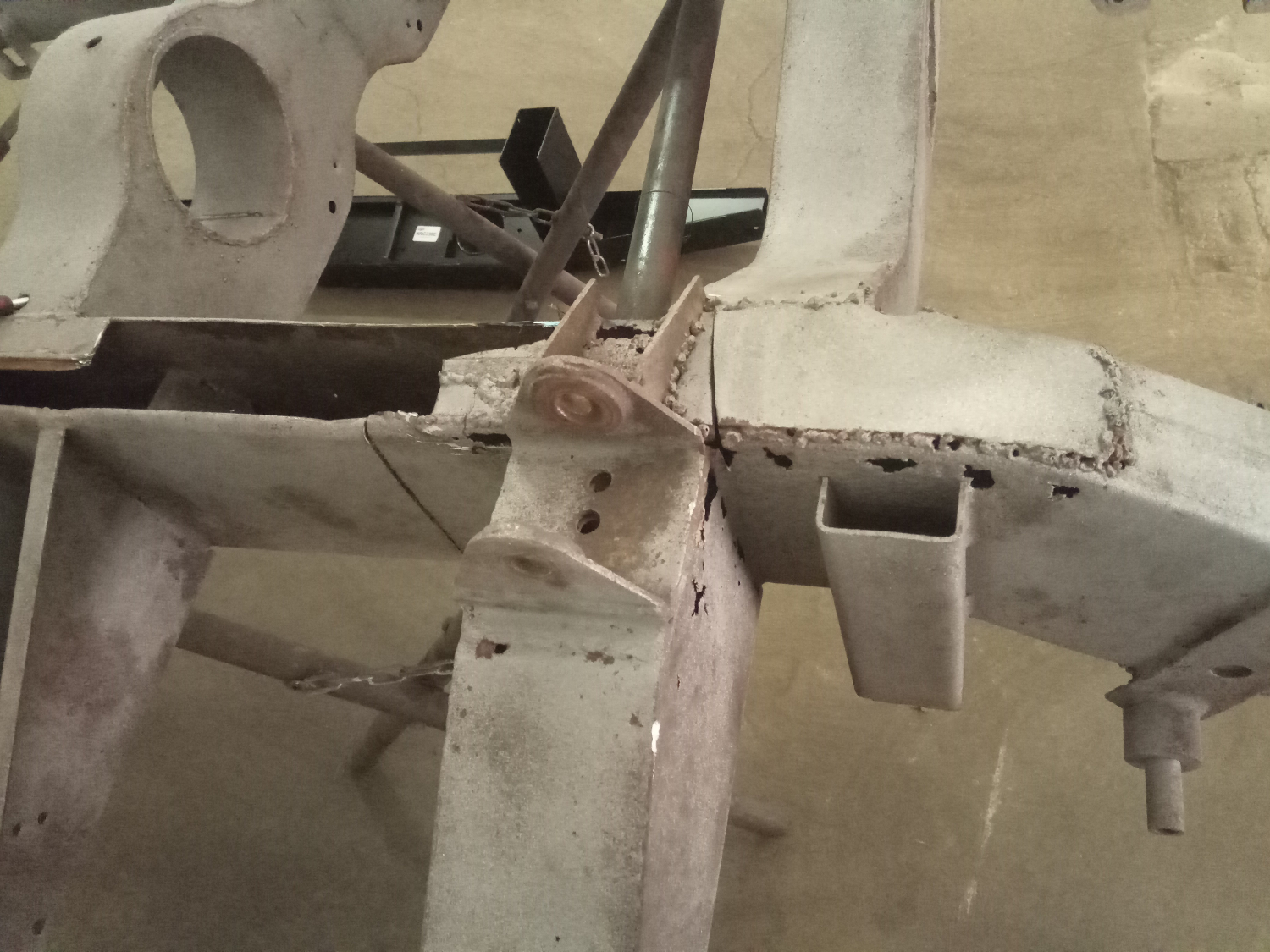

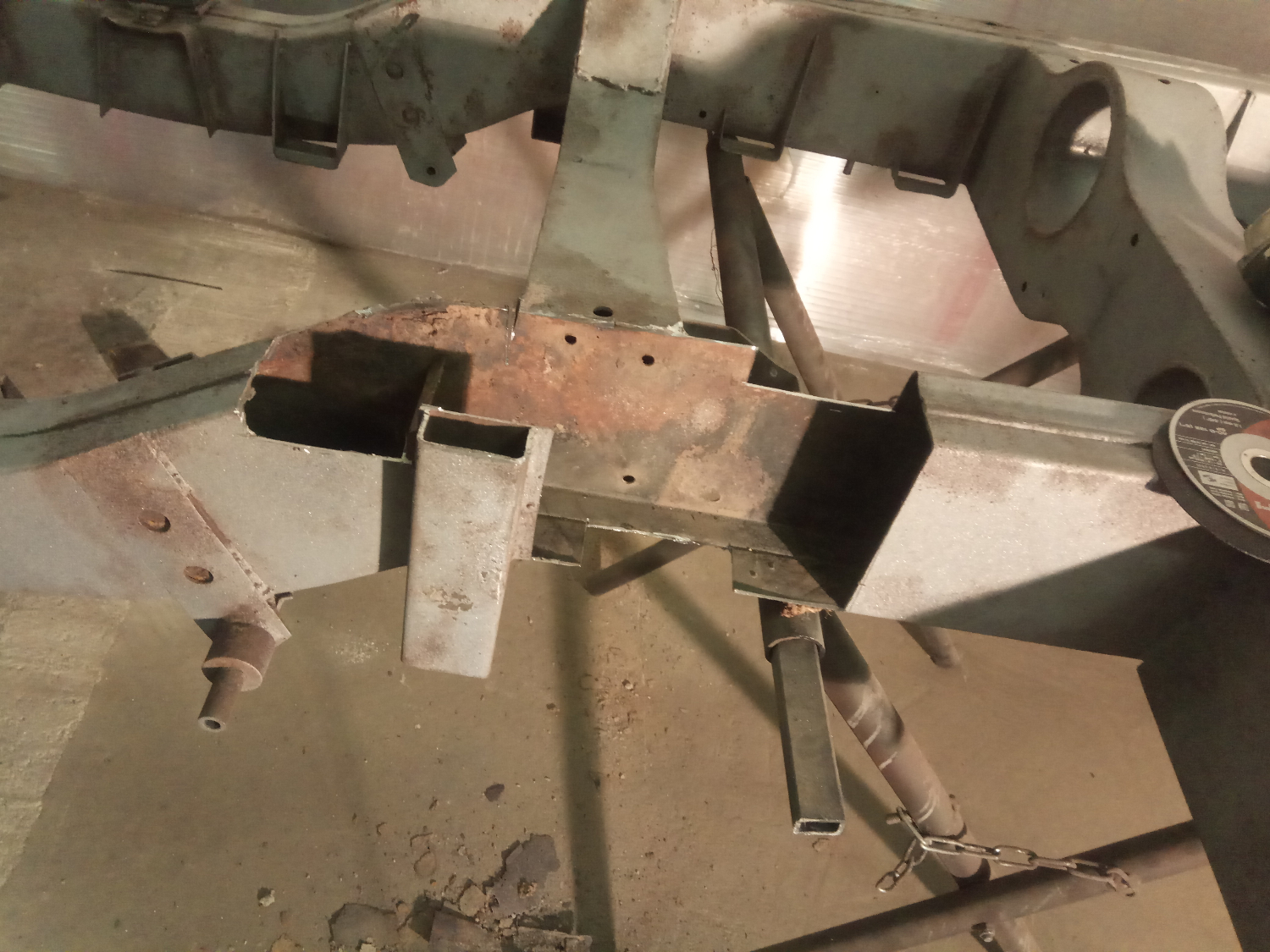

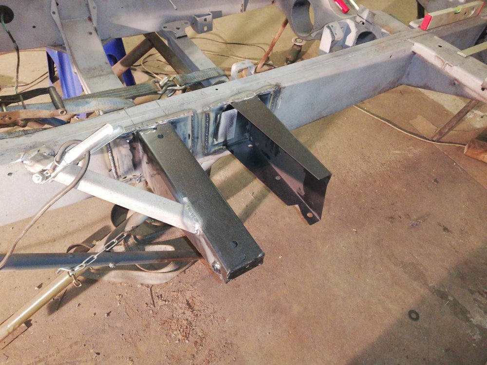

Post by ericappla » Wed Jul 04, 2018 4:13 pm

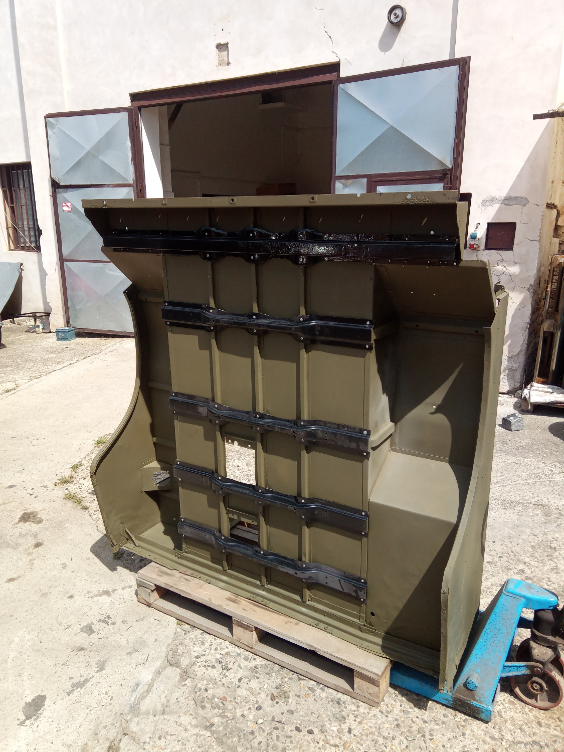

To aid the final fitting of rear xmember today I tidied up the rear tub. It's so far only in primer because I'll be doing some changes to the interior storage boxes. I have painted the underside as well to stop the galvanic corrosion between the steel supports and bare aluminium
