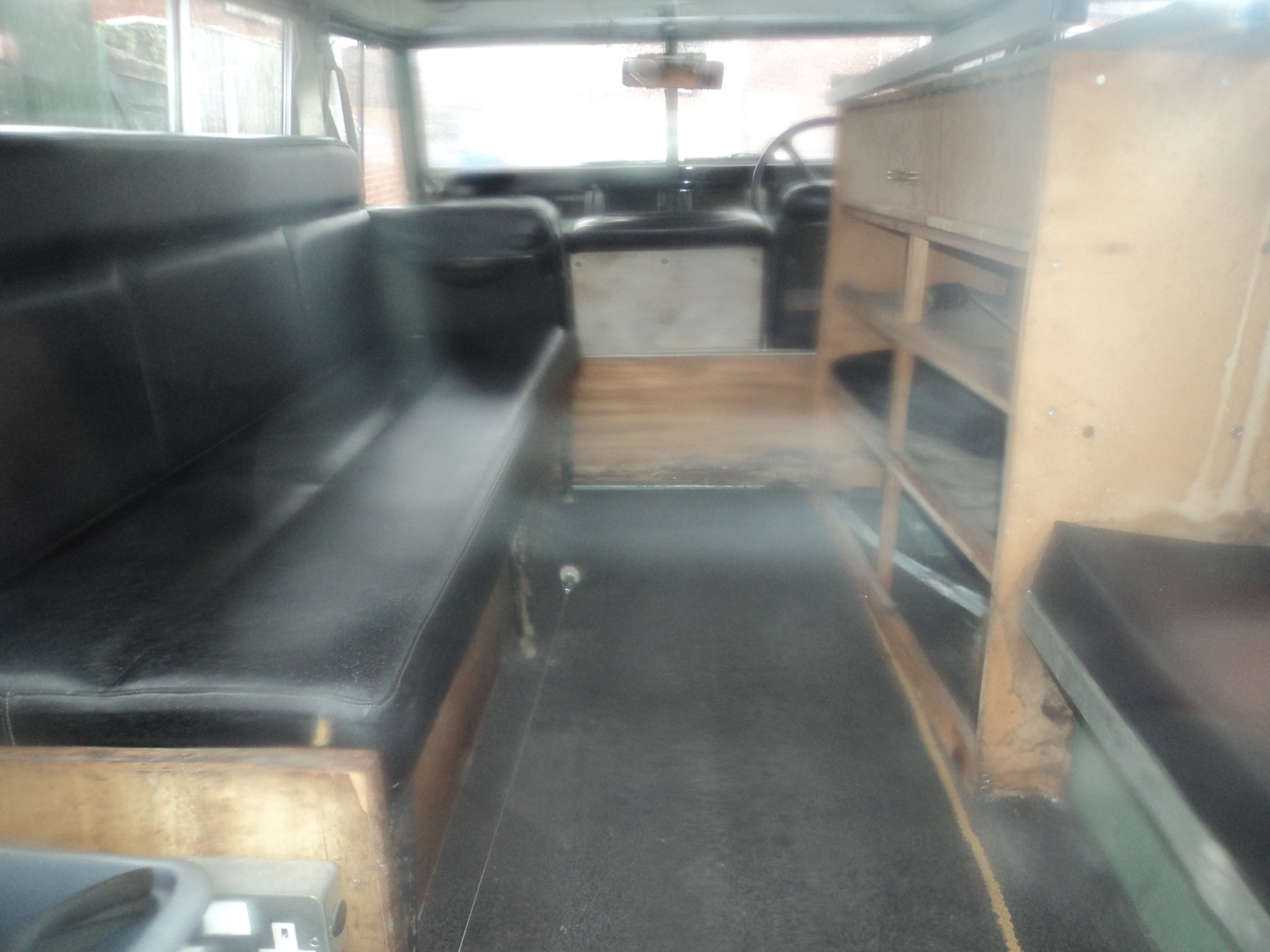

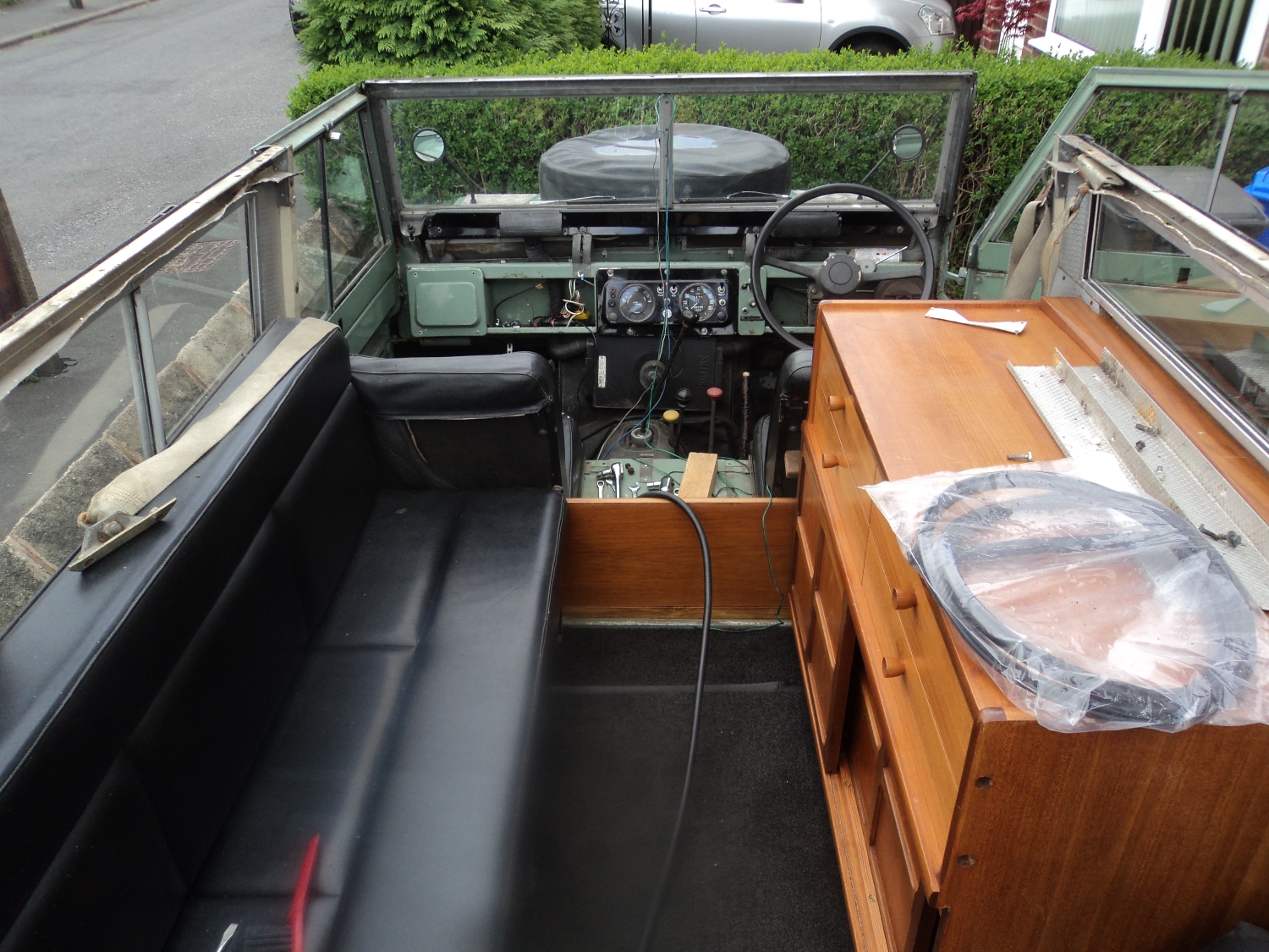

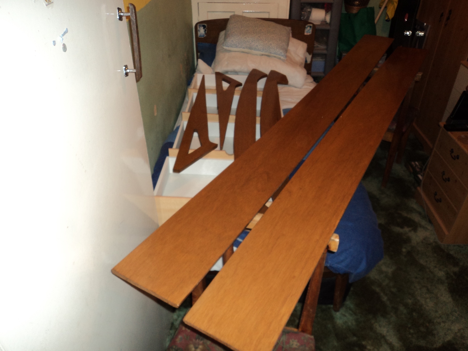

Well. I've emptied and then remade the bed/sofa area....here's before and after:-
As you can see. I've added 70's 'Nathan' sideboard in the place of the missing original stuff. There are 2 in there now to utilise the drawers at the top, sliding cupboards to access the water containers and then manual pump to a sink and gas/electric cooking area on the other one.

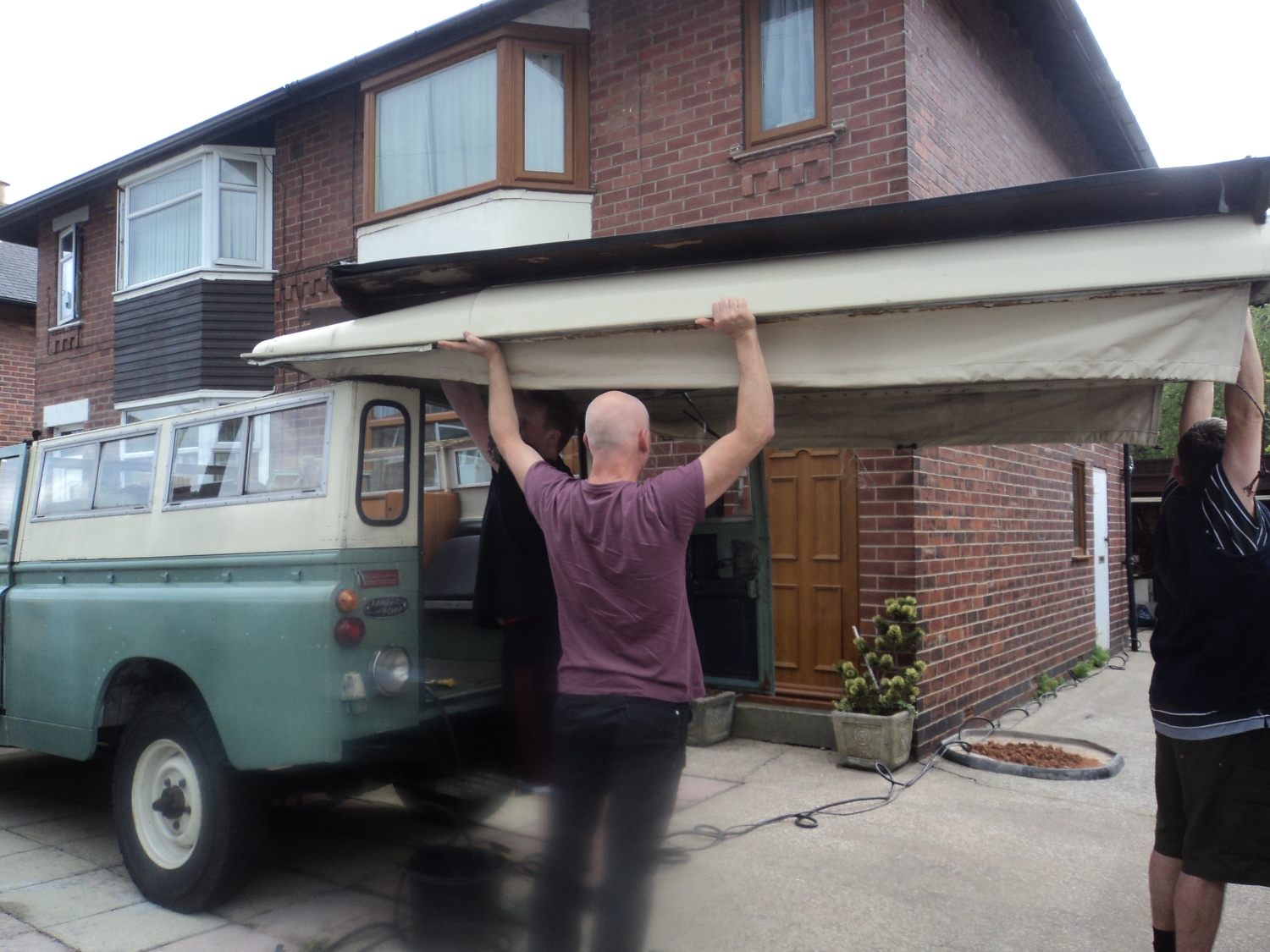

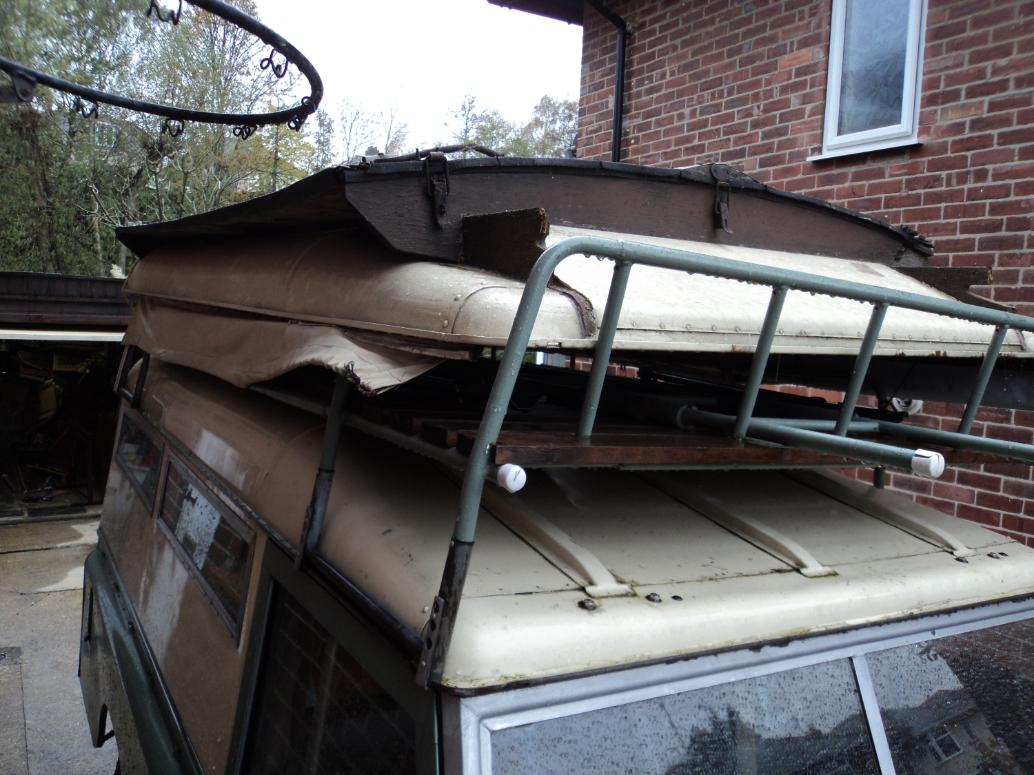

The carawagon roof had to come off. It was rotten, like all of the wood inside.
and a cheap standard roof replaced it

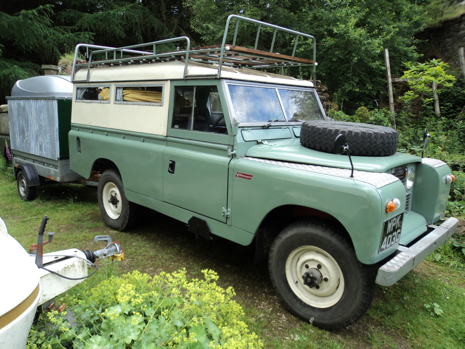

My son was a little miffed when I chopped up his galvanised climbing frame and re-welded it together as a roof-rack. Once the wooden slats were stained and attached...and a £20 tent was purchased, he soon changed his mind. He loves climbing up there now, and we enjoy camping in it at the coast.
So, a good 18 months of using it and I now feel it's time to have a go at re-furbing the roof. I hope to do it justice and return it to how it should be.....but I must admit, I think i'll miss the practicality of using the roof-rack.

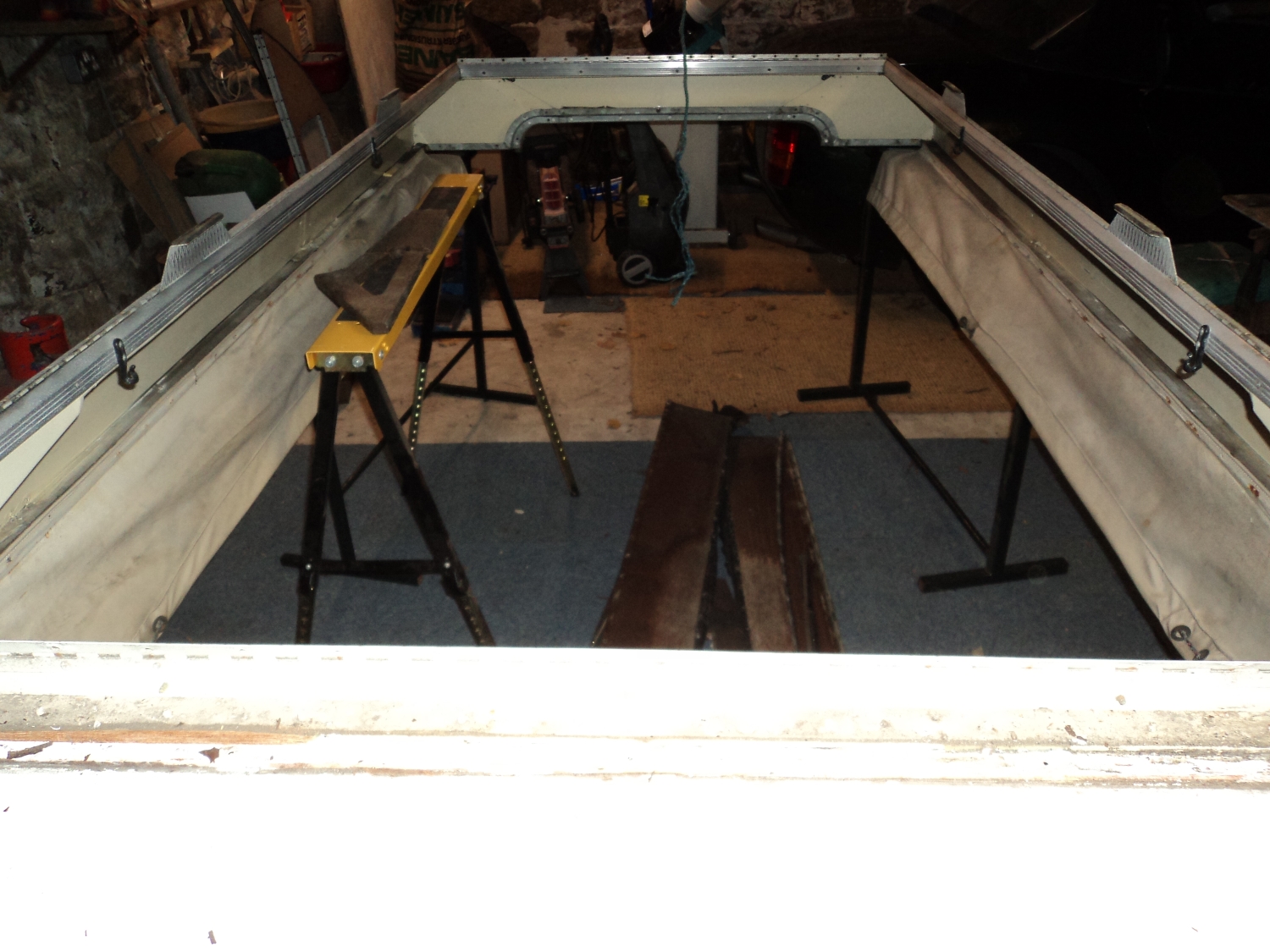

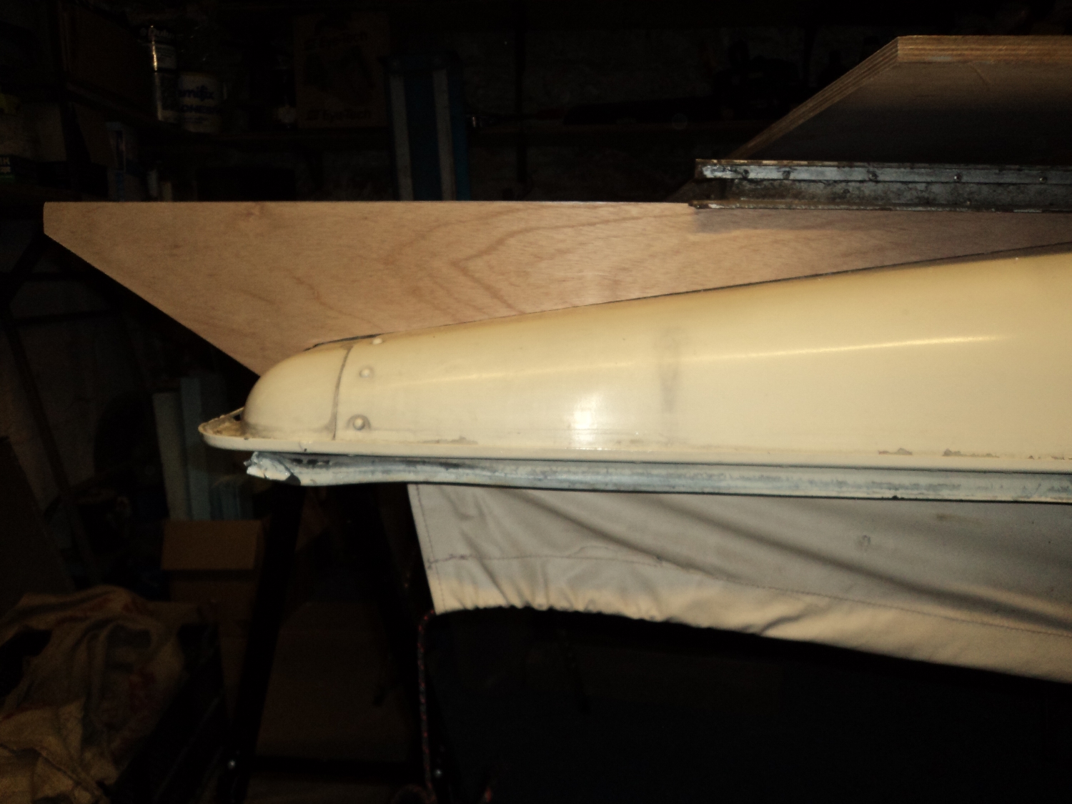

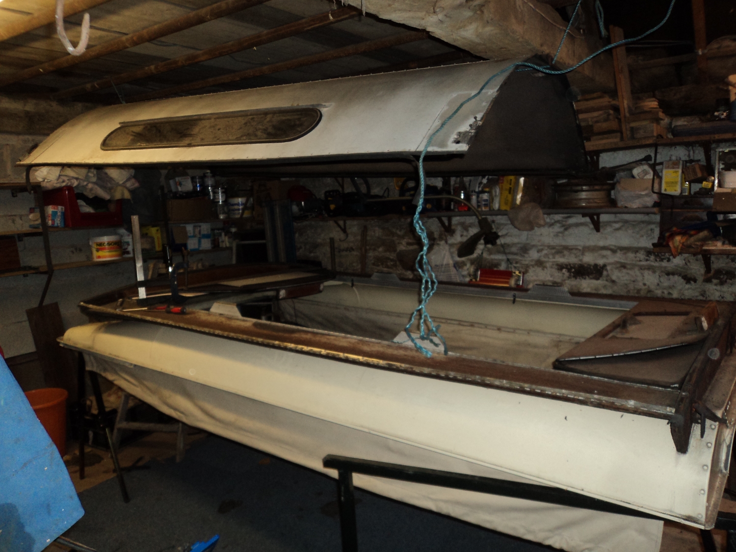

Well. Predictable I suppose, but I didn't do anything over Christmas and New Year. Too busy doing what we all do at this time. Had a good go today though. I think I've found a great way to stop a roof leaking!......add an additional one!
Got the roof to a friends barn with more space than I've got and managed to strip it down. The new design probably has the roof a little high but the headroom will be good...plenty of room now to get my trousers on eh Robin?

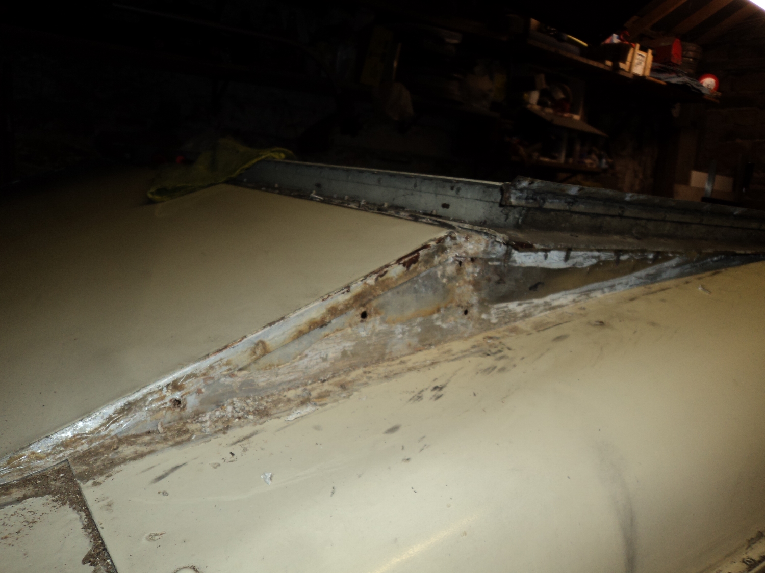

It's nice to see that there potentially could be another Carawagon roof being re-furbed and having pictures posted at a similar stage to mine. I'll try to complement the other chap's pictures during the build if we end up moving at a similar speed....but it's more likely he'll move faster and I'll be using his as a resource...we'll see. Meanwhile, here's mine with all the wooden bits stripped.
Had fun so far....Happy New Year to all.

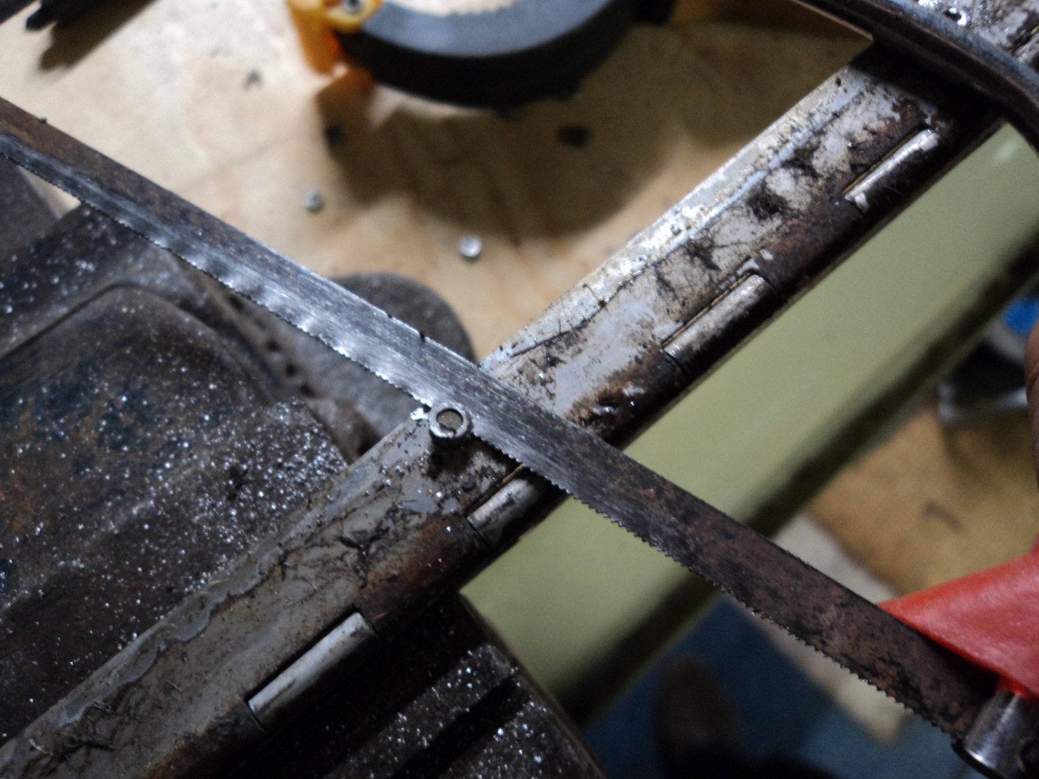

I've stripped the rivets out of the long hinges and in an ideal world I think I'd like to buy new ones. Does anyone know of a supplier? I'm fairly confident that these will be able to be used if cost or availability is a problem.
The metalwork on the roof is quite primitive but I was surprised how well it copes with the passage of time. It will clean up quite nicely I think.

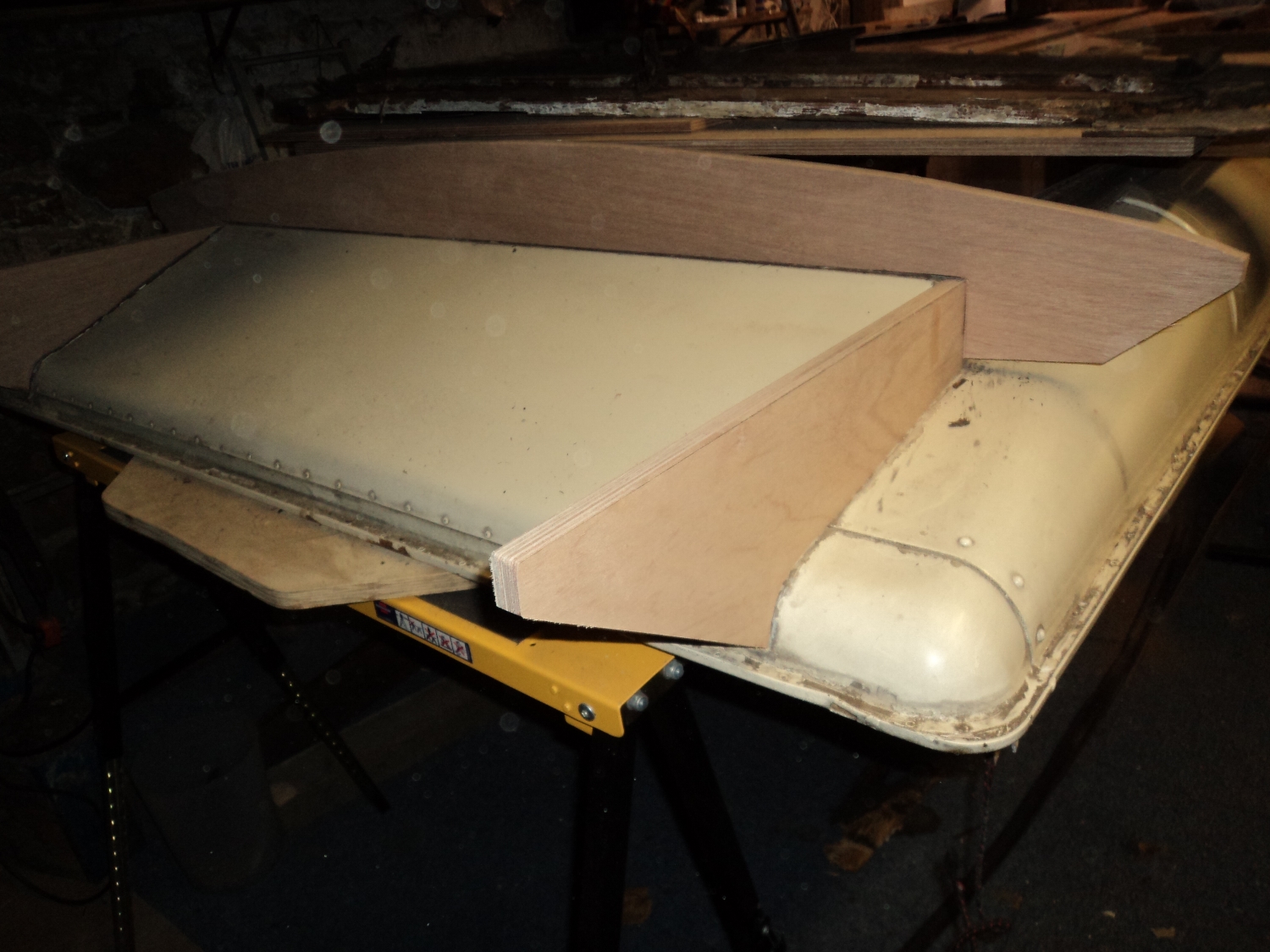

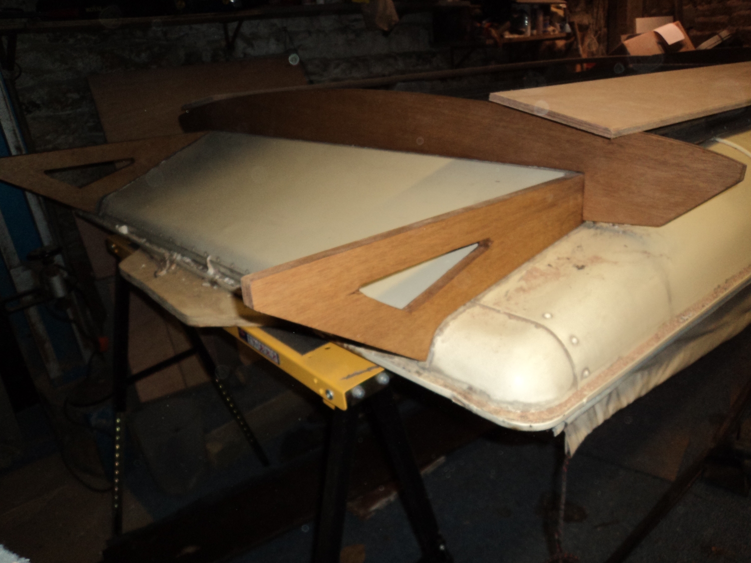

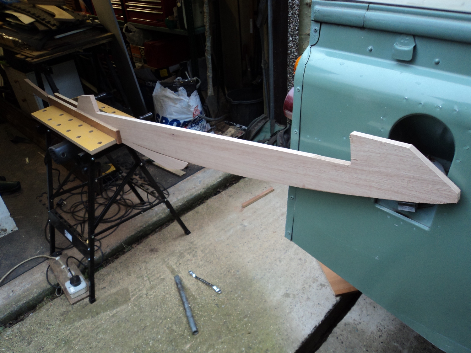

I've used the old rotten wood as a loose guide/pattern and made the basic shapes for the roof-rack supports and the front cross piece. It's from a sheet of 18mm marine ply. Big decision now is how to treat it. I've bought ronseal yacht varnish but I'm still wondering if I want to stain it first. The old stuff was quite dark....and I've seen lots of pictures of lots of dark ones...but then again, I've seen Robins lighter woodwork up close......some thinking to do. Another decision is whether to cut the shape out of the rack supports. How much weaker will it be? Are the holes there for air to pass through.....and exactly how many more mpg will I get with the reduced drag?

We replaced our hinges with stainless. The original hinges were aluminium wrapped around a steel hinge rod! Not good for staying corrosion free!
I really can't remember where we got them from, but I do remember you can get them un-drilled, or drilled. Unless you are sure the hole spacing is the same as your roof holes, best to get the un-drilled ones, I think.
If I find the supplier I'll let you know.

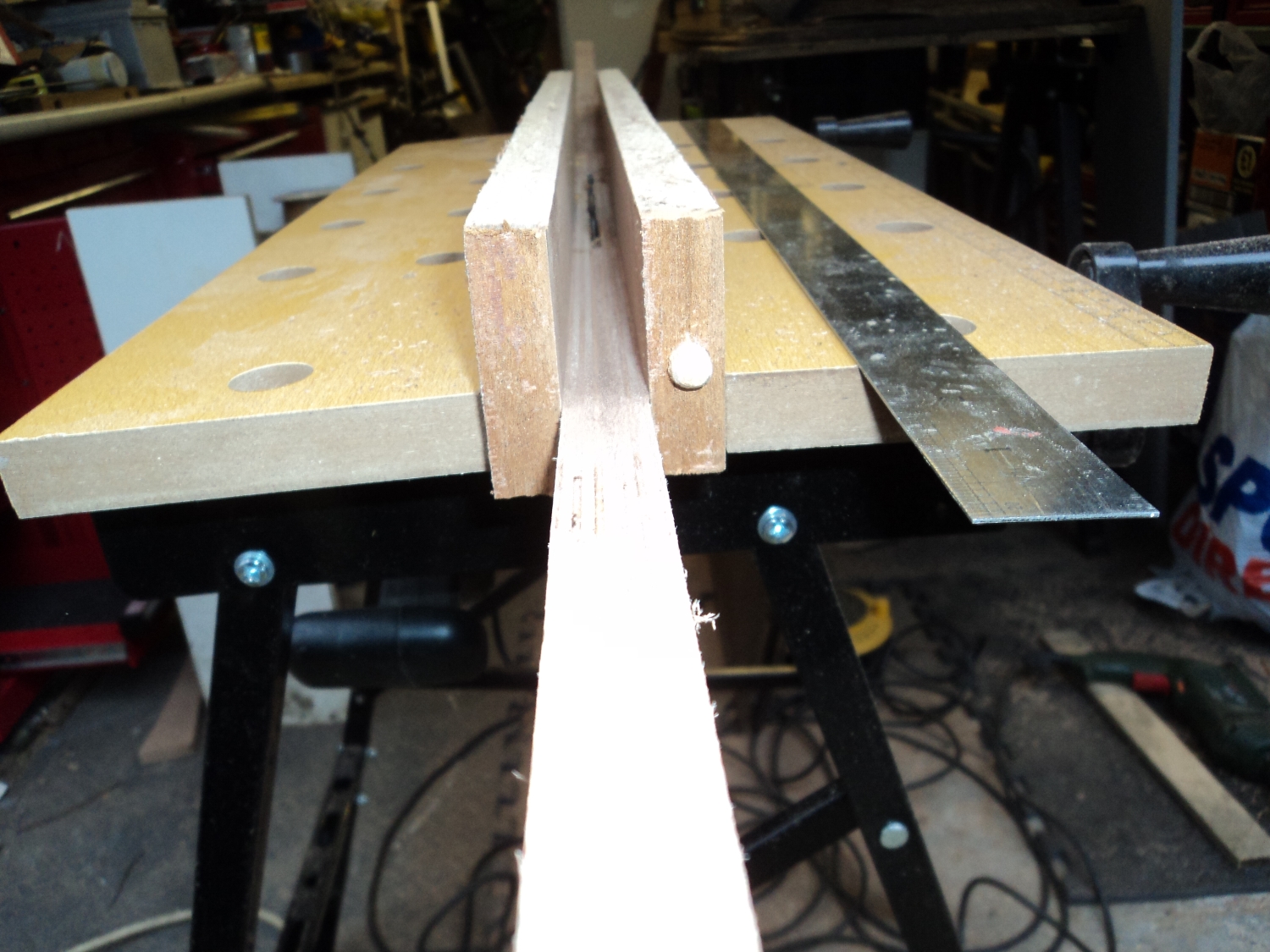

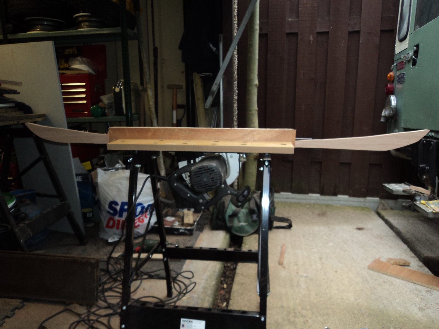

Had a play-day today. Didn't actually achieve loads as all I did was cut the grooves in the end rest pieces.....but it was making the tool that took all the time. Hopefully, my method will be sufficiently slightly different to Robin's and I won't be facing a moment in court.....I reckon it's sufficiently different!?
I used the off-cut from the curve of the rest pieces and fixed the guide sides. Clamped it in the work table and screwed the base plate of the circular saw to the underside of the bench.
It's made the job very steady and spot on accurate, so the tadpole rubber seal will fit in lovely now.
