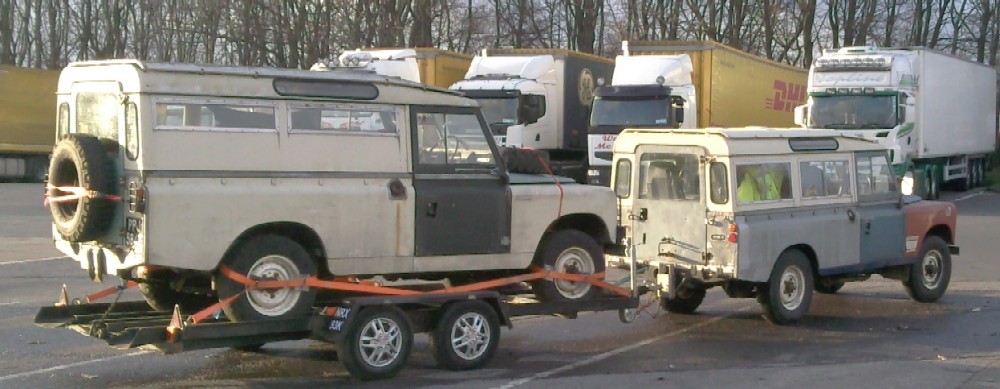

Here's my project Carawagon, bought recently (being towed by my S3 LWB, Rex)
A previous owner rescued it from Wales, and started to restore it by putting it on a better chassis (the old one was broken in the middle!) and bulkhead - neither were new, but were better than the originals.
It then stood for a couple of years when the previous owner ran out of time (& money!), so we bought it.
The chassis now needs a bit of welding, just a couple of plates (or possibly new rear crossmember), and all of the brake cylinders and shoes need replacing.
Currently there aren't any seat frames, and there's only one original front seat (white vinyl), so we've to sort those.

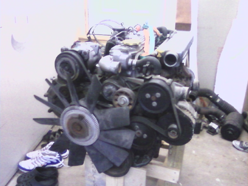

It's still got the original 2.25D engine, but that's shortly coming out and a 200TDi is going in, along with 3.54 diffs.

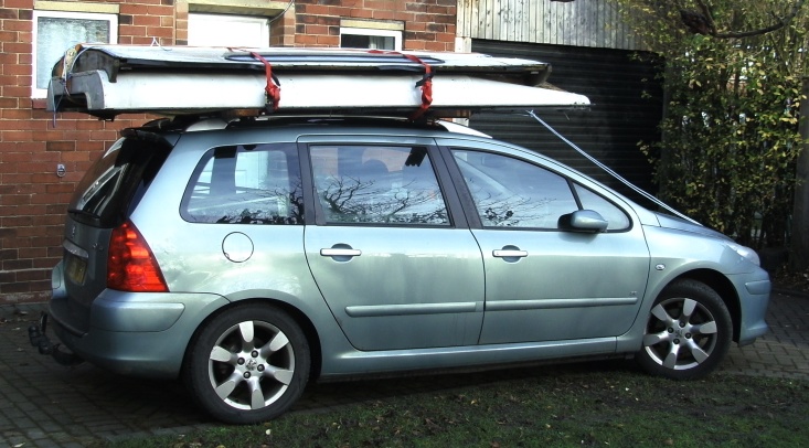

It was made without the traditional Carawagon roof, probably to save money, but I happened to find a roof on ebay, so it will end up as a 'proper' Carawagon :nana1:
Here's the roof, on the car we used to collect it.
