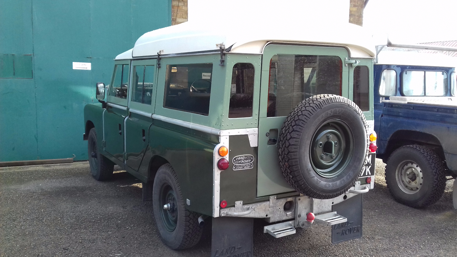

Attached picture shows the RS Components rubber/stainless steel latches in place and the fibreglass gutter moulding over the rear end door.

Bit of an update.
I have now swapped the station wagon roof for the Dormobile one and fitted another set of Carawagon awning poles to my series 3.
Hole cut in the fibre glass for the awning pole to go through. I was expecting to have to open up the hole a bit so it did not catch when opening but it clears it ok.
The hinges needed to be removed so the I could lift the fibre glass section up and drill the holes for the screws which hold the internal support brackets.
Getting ready to cut the holes that the top hat section goes into.
The outer top hat section needed the end cutting off as I was only really using this to tidy the roof up.
All ready to use just need to find some matching canvas so that I can make a cover for the awning poles.
