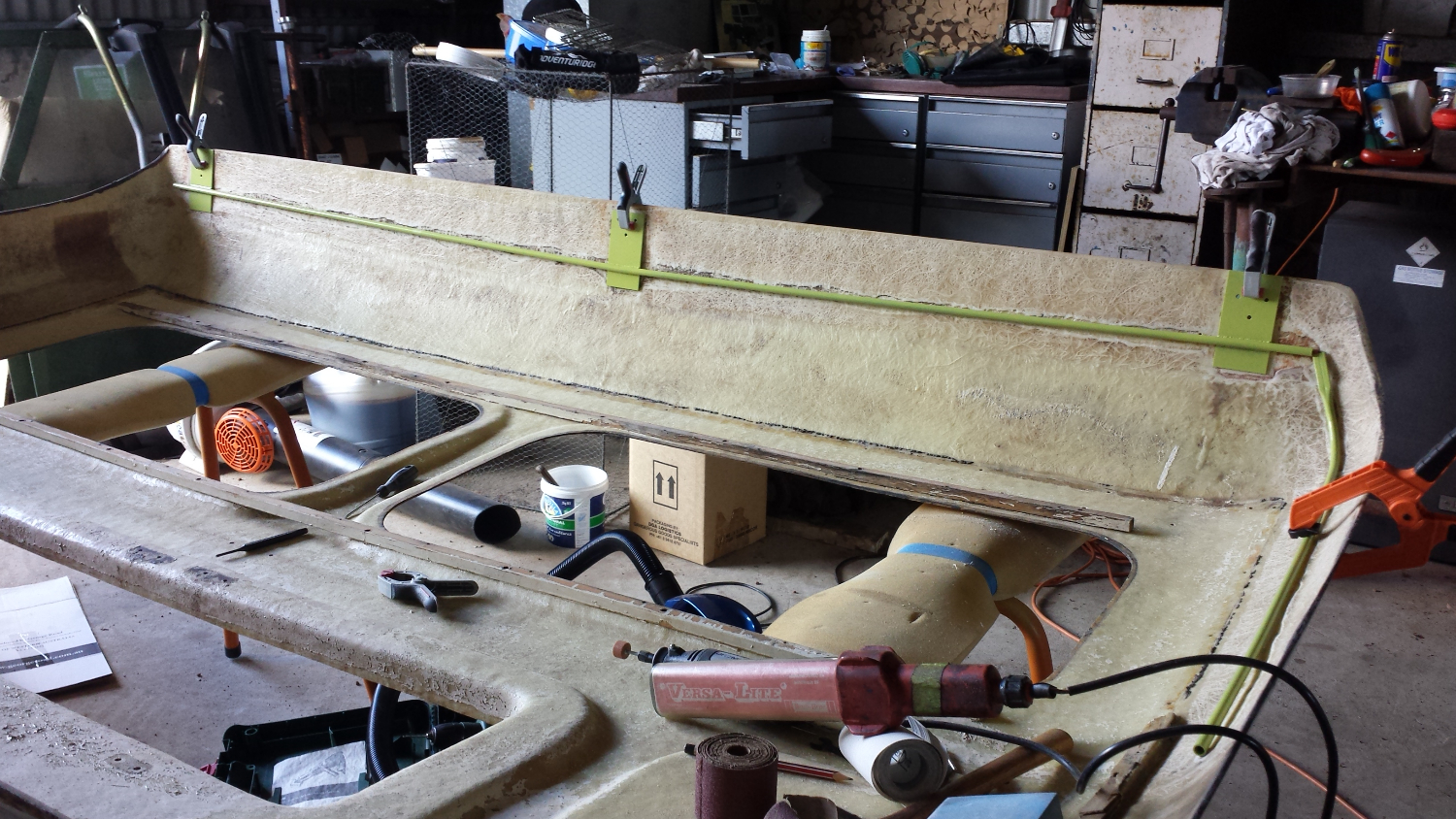

G'day Robin,
I found exactly the same thing as you. Luckily there was enough left of the originals that I was able to duplicate them. Here is a picture of the new ones. I made them from 4130 Chrome Moly tube and plate. I painted them with aviation primer inside and out to ward off corrosion!
I've since bonded them to the roof with structural adhesive and am going to reapply the fibreglass over the top.
I hope this helps.
Cheers
Glen

Ah, perfect Glen - thanks for your picture.
It looks like yours is just the hinge side and the front, like mine.
Did you weld the hinge plates to the bar, and is the front bar welded to the side bar?

Post by Litelandy » Fri May 18, 2018 12:27 am
No worries at all Robin.
Yes the braces are only along the hinge side and the front. I had a mate TIG weld the plates to the bar. I'm not sure if that's how the originals were but I figured it'd be much more rigid that way.
I haven't welded the side and front bars together though. I'm relying on the structural adhesive to provide rigidity and keep the bars in place relative to each other in that area.
Cheers
Glen
