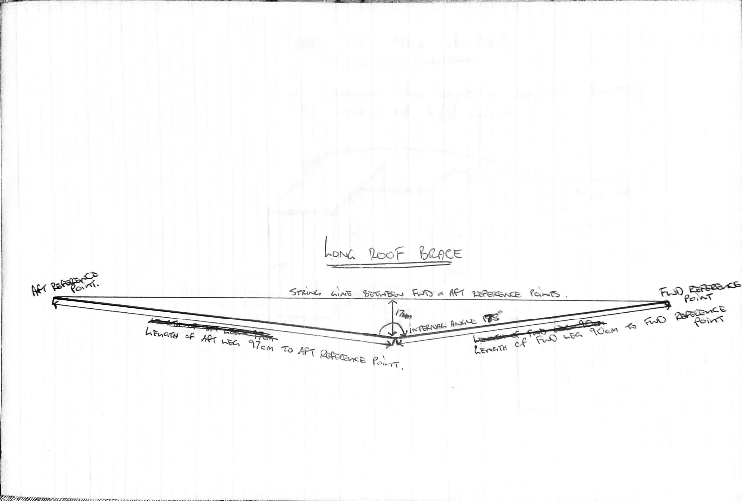

I'll just post the pictures here for your benefit and anyone else who may derive some use from them.
The first picture shows the angle I bent the tube to. The tube I used is 3/8" 4130 chrome moly. I picked a reference point FWD and AFT of the bend and ran a string line between them. I bent the tube until I had a deflection of 17mm from the string line which translated to an internal angle of 178°.

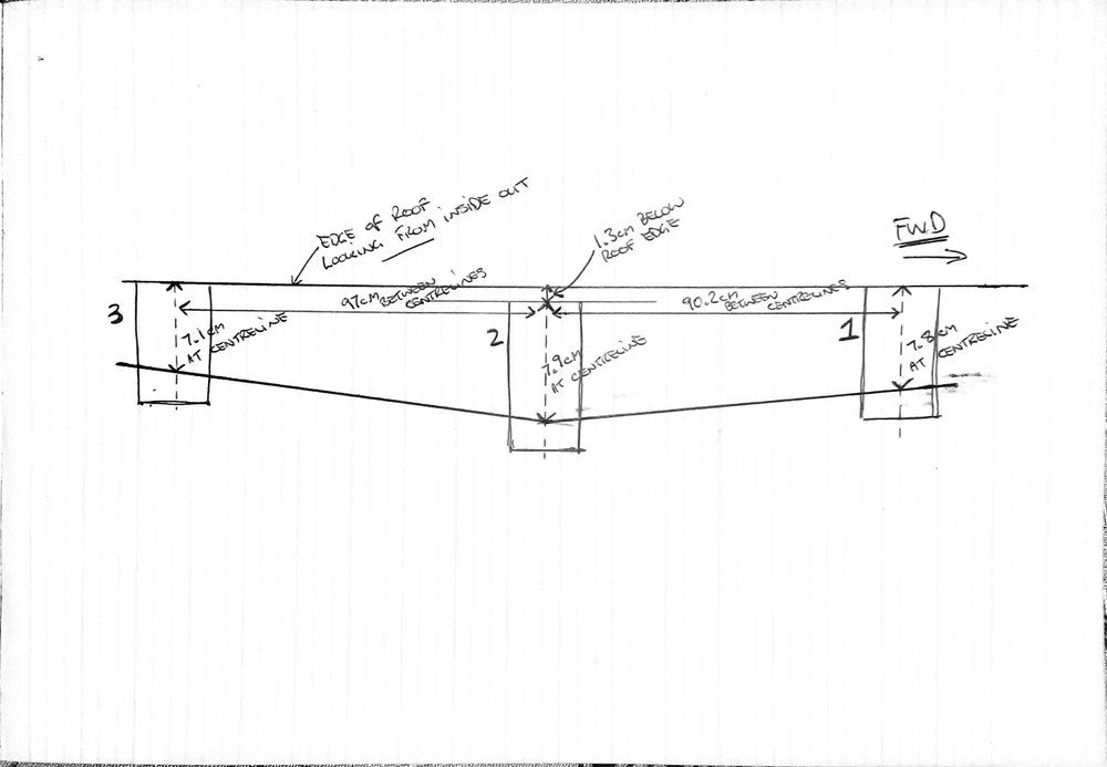

The second picture shows the plate positioning on the tube prior to welding. I clamped the 3 plates to a bench at specific distances apart. I then positioned the bar over the top (with the bend in the tube positioned in line with the centre of the middle plate) and clamped at specific distances from the top edge of each plate (measured along the centreline of each plate). Then the bar was TIG welded while in situ.
I worked out the dimensions by clamping all of the components to the my roof and worked out the best positioning.
I hope this is helpful. If anyone has any questions please ask.
