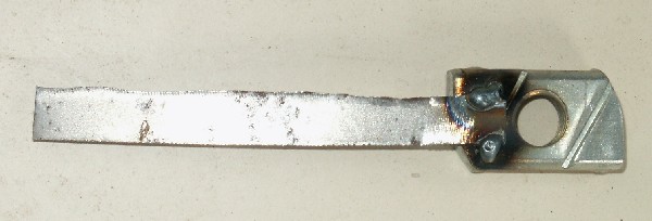

Captive nut with 'feeder' strip

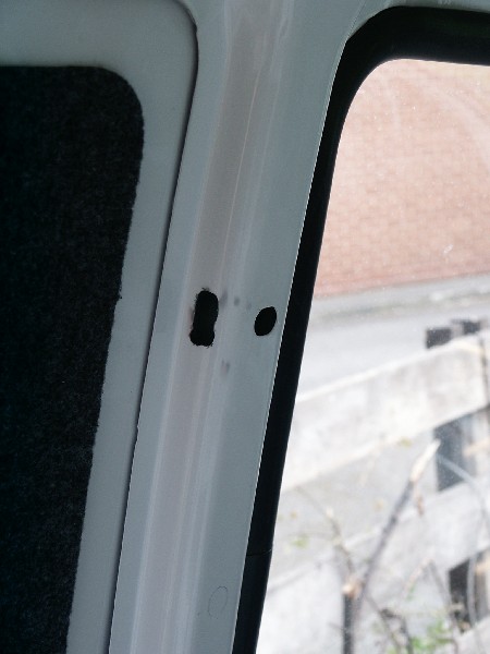

Top seatbelt fixing hole, showing additional hole for feeding captive nut

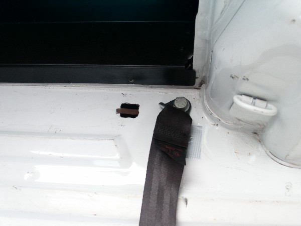

Floor seatbelt fixing, showing additional
hole for feeding captive nut and showing the 'feeder' strip
Seatbelt in place
